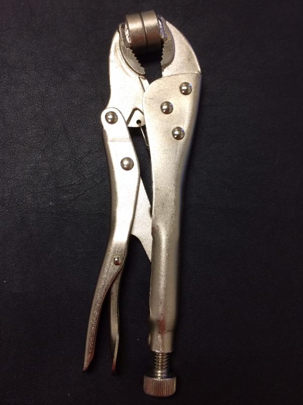

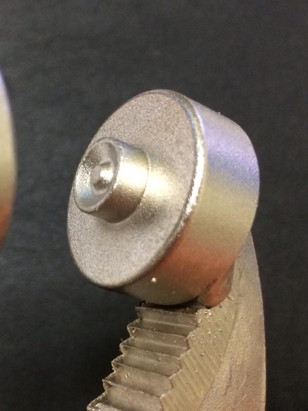

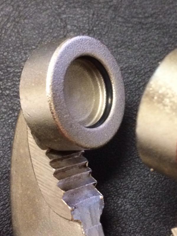

Anyway, they make a tool that is a midified Vice-Grip style tool. I received mine today. $49.95 gets what feels like a heck of a lot of tool for the money. I have yet to try it, but I think I am going to like it. The two halves are welded onto the jaws of the vice grip; elegant in its simplicity. I have seen others who had a similar tool, with lots of complaints that the faces of the punch and die did not line up. This tool seems to not have that issue.
Their site on-line features a picture of a tool where the punch and die are mounted on drift pins where they could move around a little. I am not sure if that is a positive or a negative, but I have to assume that with the forces being genetrated the welded on punch and die set are goin to be more robust and consistent since nothing in the tool is put into shear.

Also see the pics below
