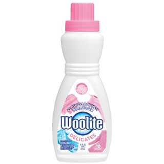

On two occasions, I have taken an old sail and put it in a clean 30 gal trash can... filled it with water and a bottle of

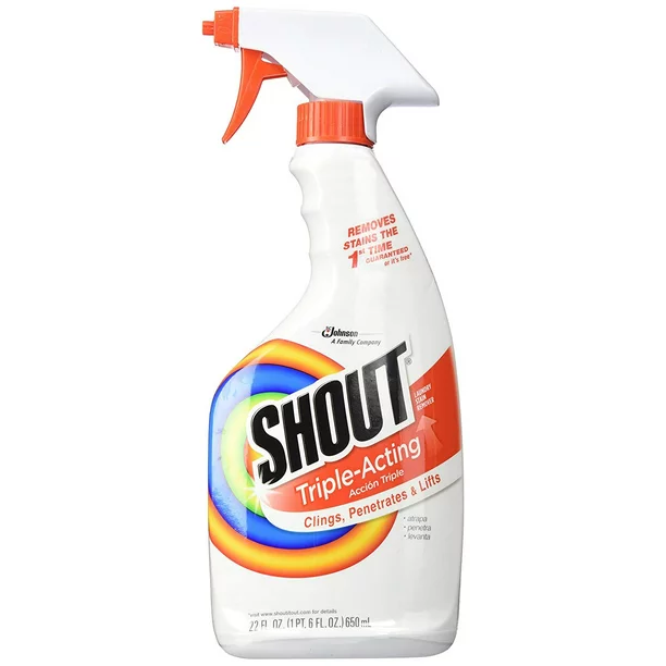

Let the sail soak for a few days and then lay it out on a patio slab and spray it off with the hose. That will get most of it. For the stuborn stains, I then spot-sprayed this ...
... with gentle brushing.

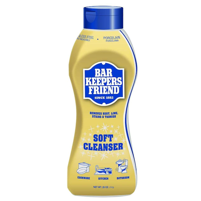

For rust stains, I would squirt a little of this on the sail and work it in with my thumb... but don't let it sit too long. It will start to degrade the sail cloth
BTW... I have also had very good results using BKF to get rust stains out of fiberglass. Let it sit on the spot for about an hour and work it in with a brush.
