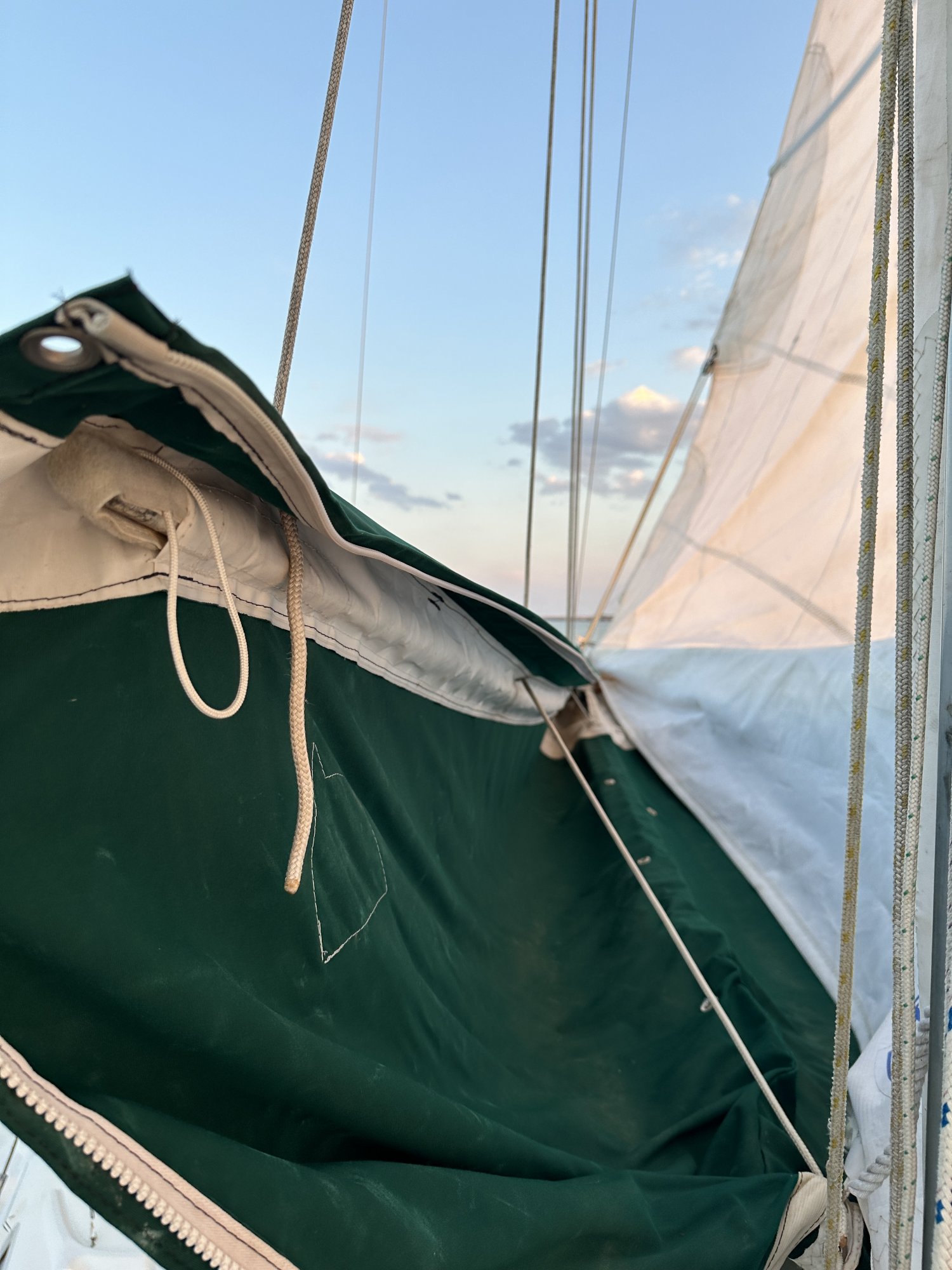

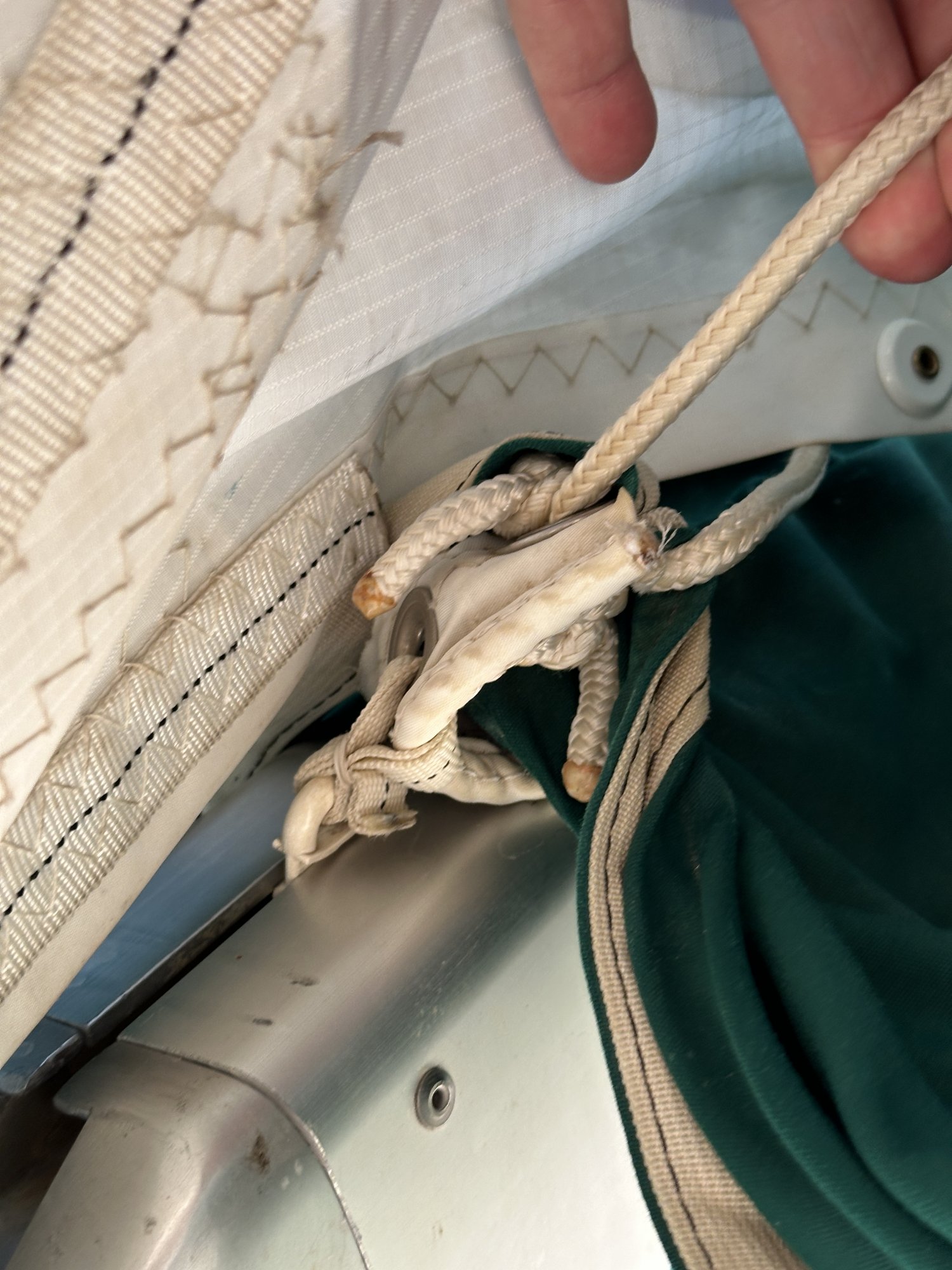

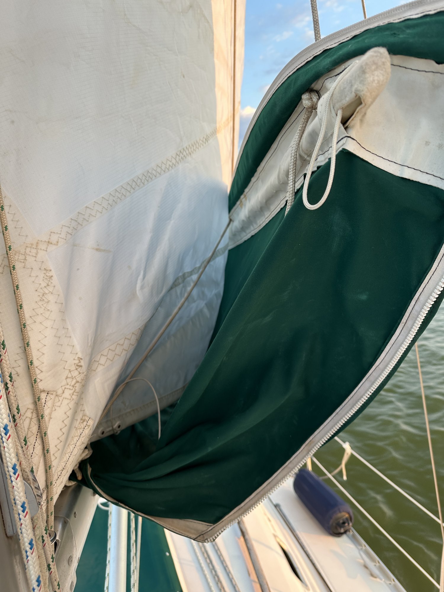

It has a Doyle stackpack, which I've not used before, and I believe the forwardmost lazy jacks are incorrectly rigged into the stackpack. Does anyone have photos of it done right? The Doyle stackpack installation manual doesn't have that kind of detail, and the forwardmost nylon slug is clearly not performing correctly (see Starboard Detail).

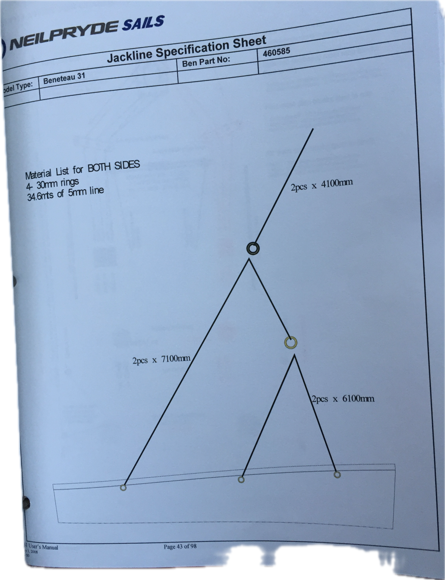

This is from the Bénéteau 31 manual:

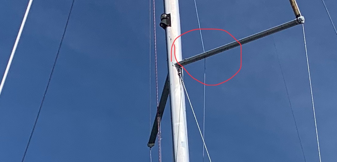

1727628923324.png There should be a sheave on either side of the mast. Then down through a hole in thespreaders.
View attachment 227805 There should be a sheave on either side of the mast. Then down through a hole in thespreaders.

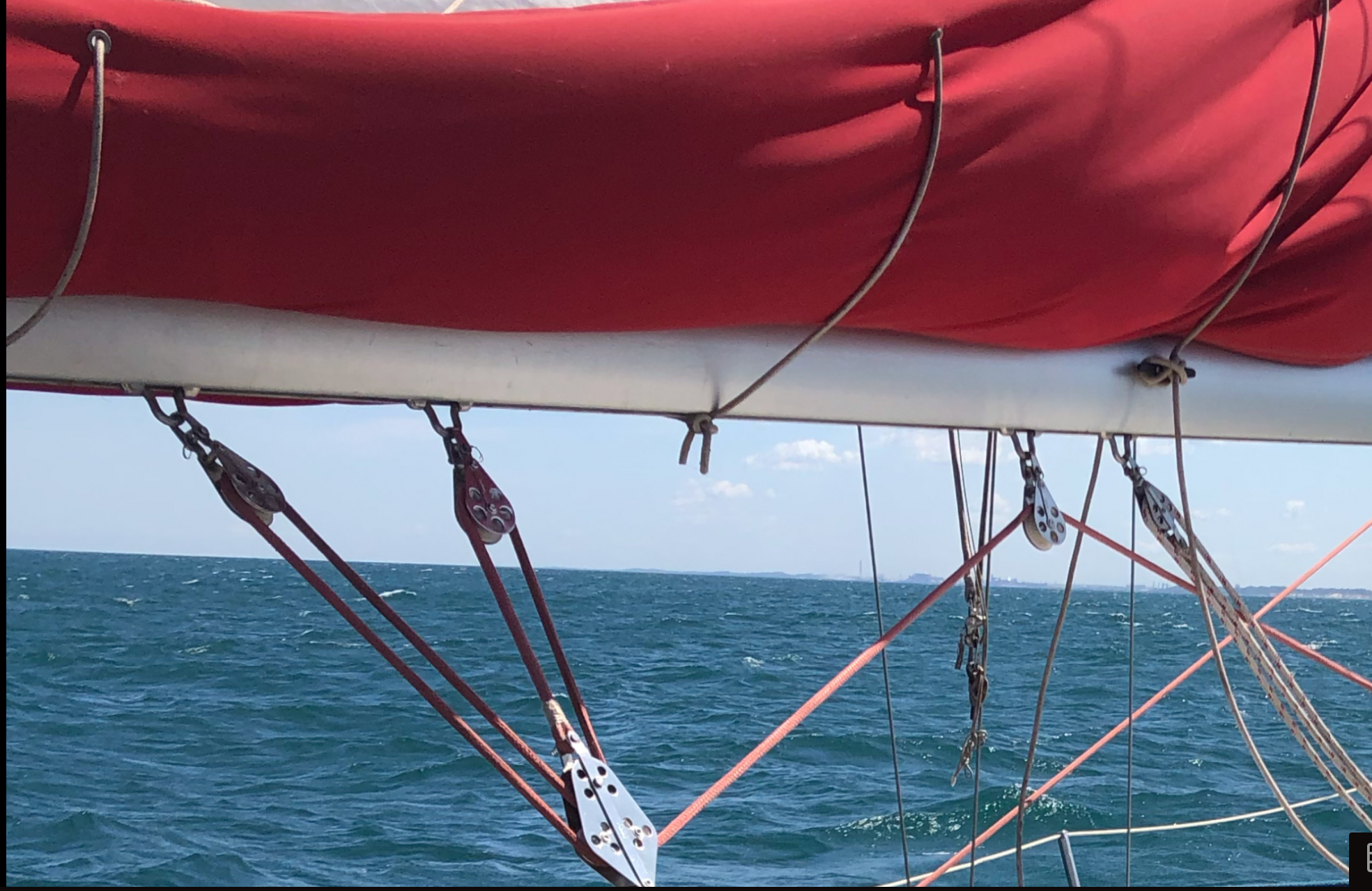

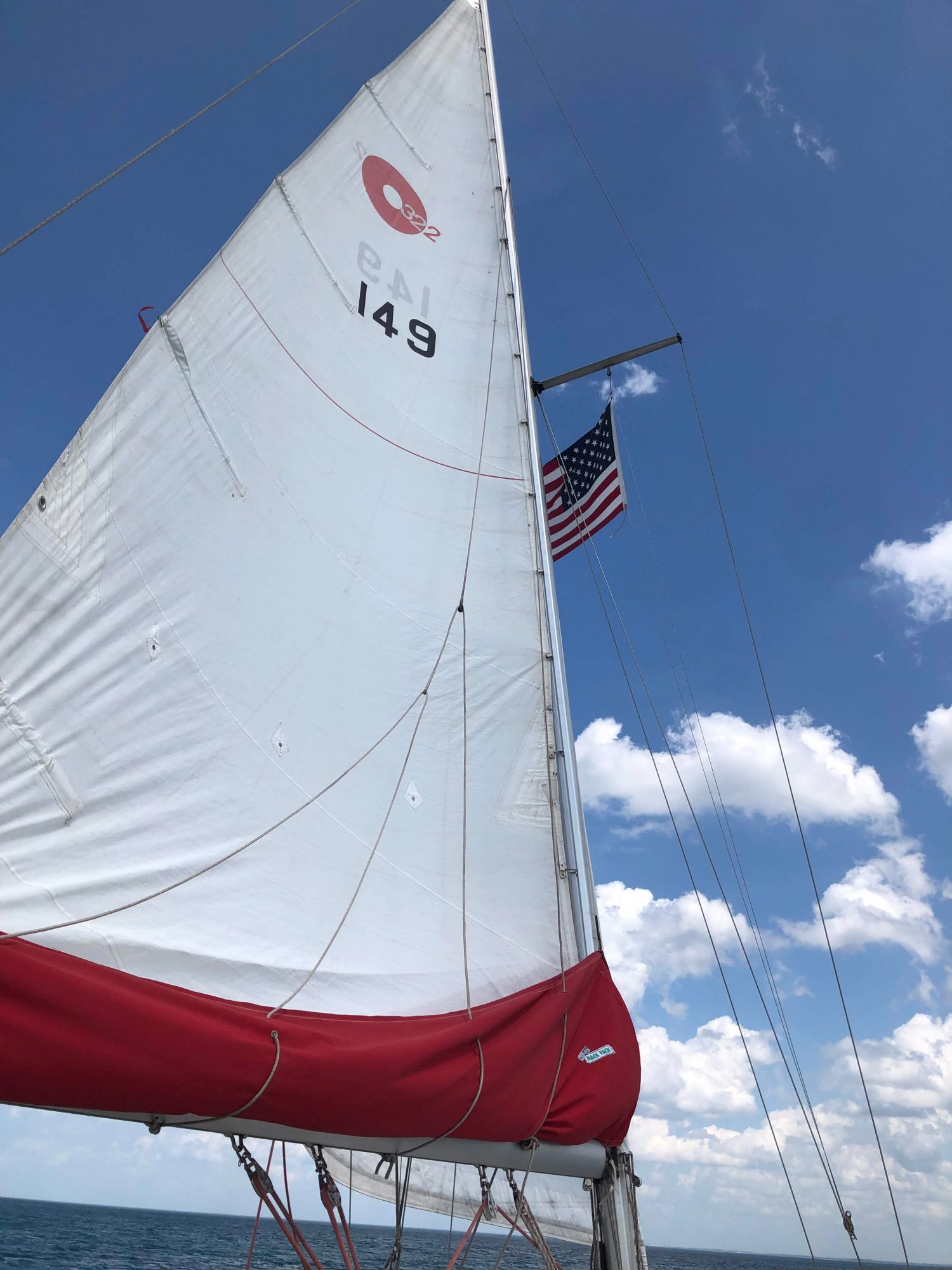

I have a Mack Pack onmy O’Day 322, and it is rigged just like your diagram, except I do t have any supports in my pack….just the holes, and the lazy jacks run through them, and around the boom in the various positions.

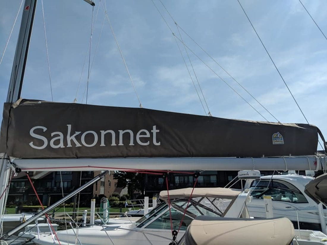

Welcome Back @Shorinsean. I see you have upgraded your boat since 2022. Congrats.
It is easy to make the stack pack seem complex. It is not. The design has lines on either side of the pack that run from the pack edges (which I believe you called spreaders) to the mast. They gather in a single line and run down the mast to let you raise or lower the pack. @Caboteur provides an image of that simplicity. This image from Doyle supports that simplicity.
Simplify the lines on your boat to provide the ease of use you desire. The images you provided appear to show stopper knots at cringles. In one case, the stopper knot seems too small and partially slides through the cringle. From your image, it is difficult to track all the lines.
I would take the lines apart and connect them to the stack pack as Doyle originally designed them.

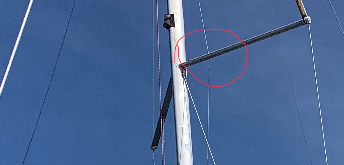

No, I meant the spreaders… so the lines don’t slap in the wind
Interesting. I added my Mack Pack myself, and I would not drill holes in my spreaders for the lazy jacks. I get it could help keep the line from slapping and it may help keep the jacks spread out some, but I would think chafe would be a big problem.

In @Shorinsean s photos you can see that his sail is not sewn into his pack.
In @jssailem s photo of a Doyle stack pack you can see the knots where the lazy jacks are tied to the top of the stack pack. They are not run to the boom.
Shorinsean, I agree with John, tie the lazy jacks to the top of the pack in the appropriate holes.

Thank you all; I'll look into setting up the LJ's into the top of the stackpack rather than the bottom as they are today. Regarding sail trim, one of our very experienced sailors has some extra rigging that does as you describe, pulling the LJs forward to the mast. But I fall into the latter "Cohibas and cognac" category, so I'll be perfectly happy to get my rig looking like @jssailem 's.
