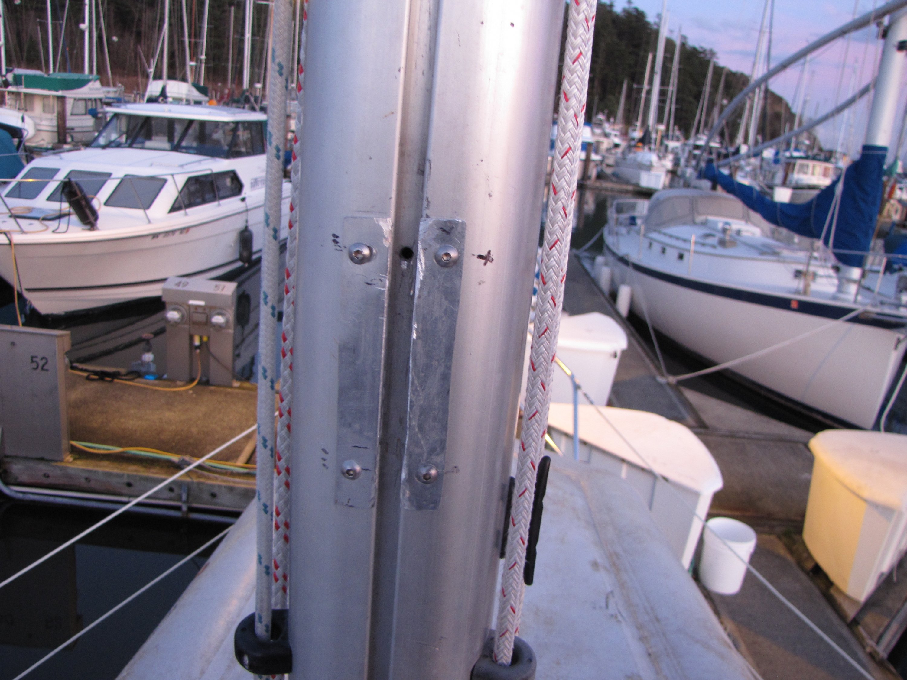

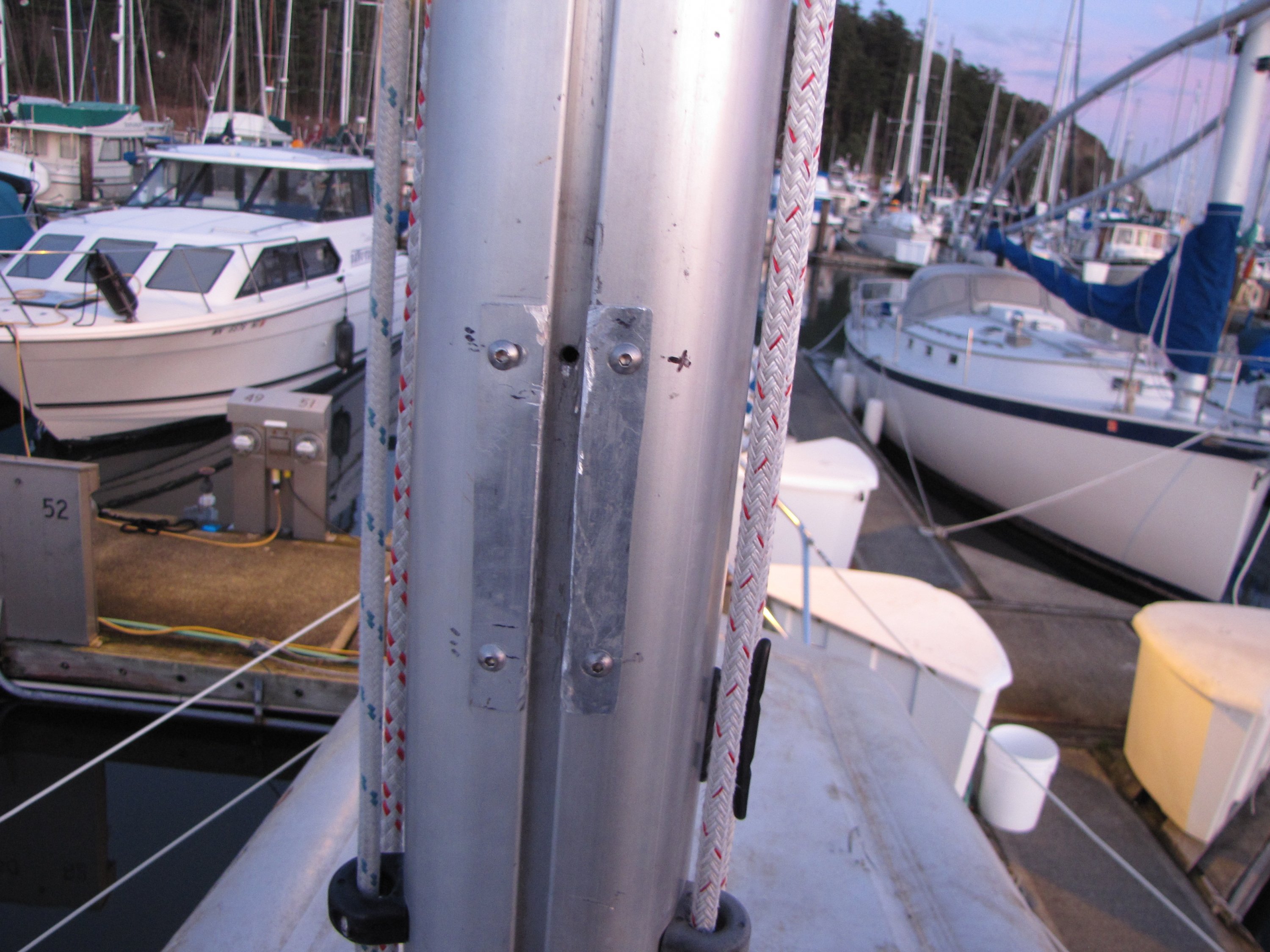

First off I have installed mast gates..............

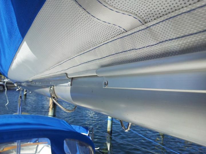

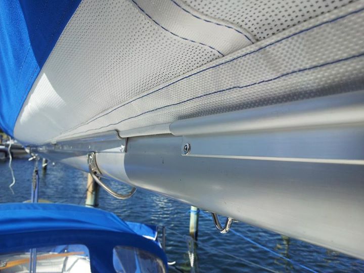

I sewed a Sailpack using the instructions and materials from Sailrite and like having the "basket" formed by the lazyjacks & Sailpack to hold all the cloth so that when you drop the main you can see and I don't have to deal with all the cloth laying on the deck.
I have a similar problem with the sail not dropping all the way in, but Sailrite has you install the front panel with zippers on either side, so I'm able to reach in and pull out the flakes and get it to lay down the rest of the way before zipping it shut. I also have to watch the battens catching, which can be a bit of a hassle, but I'm thinking about it beforehand now, instead of hauling on my halyard and wondering why the sail won't go up. :biggrin:

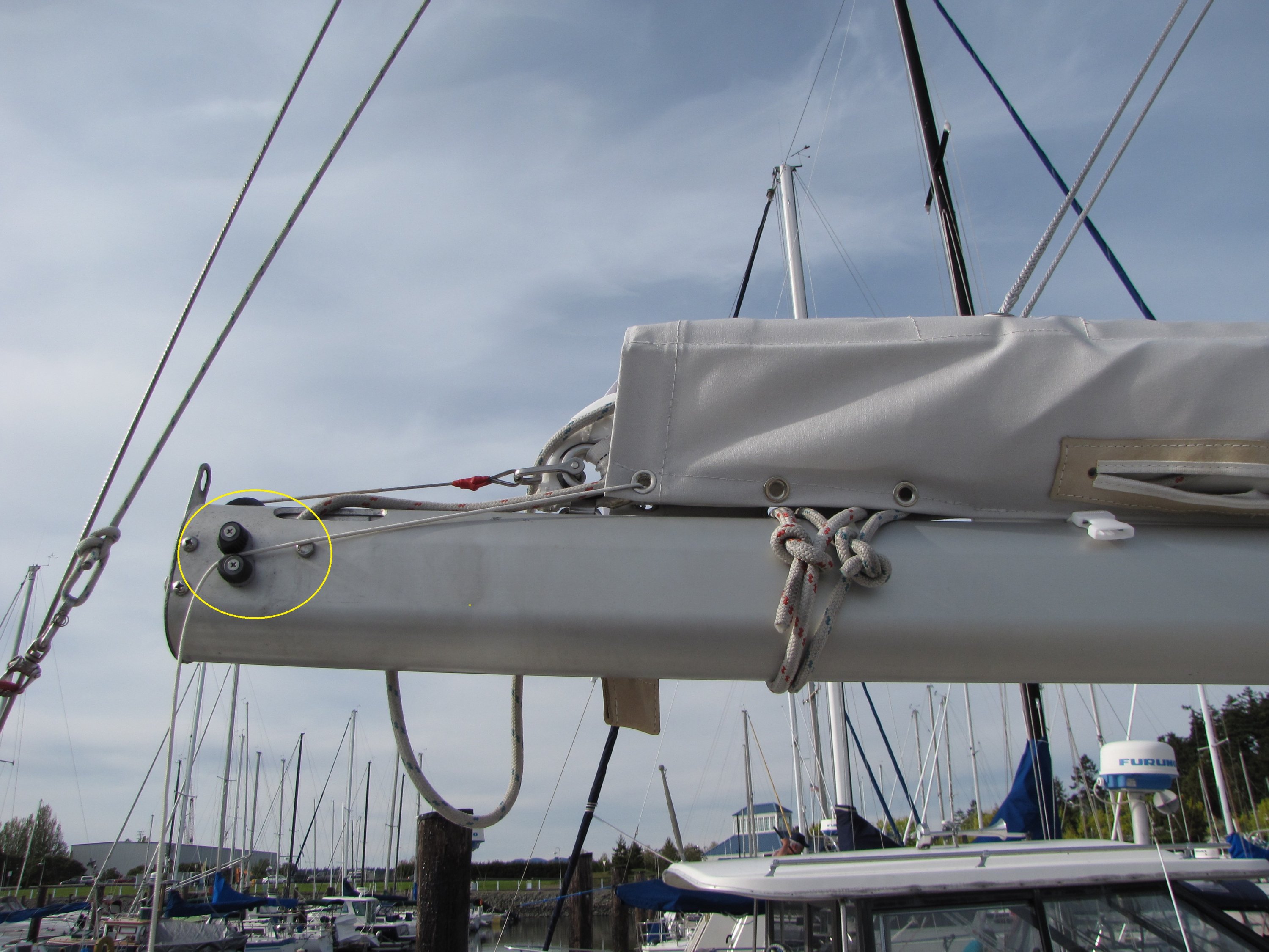

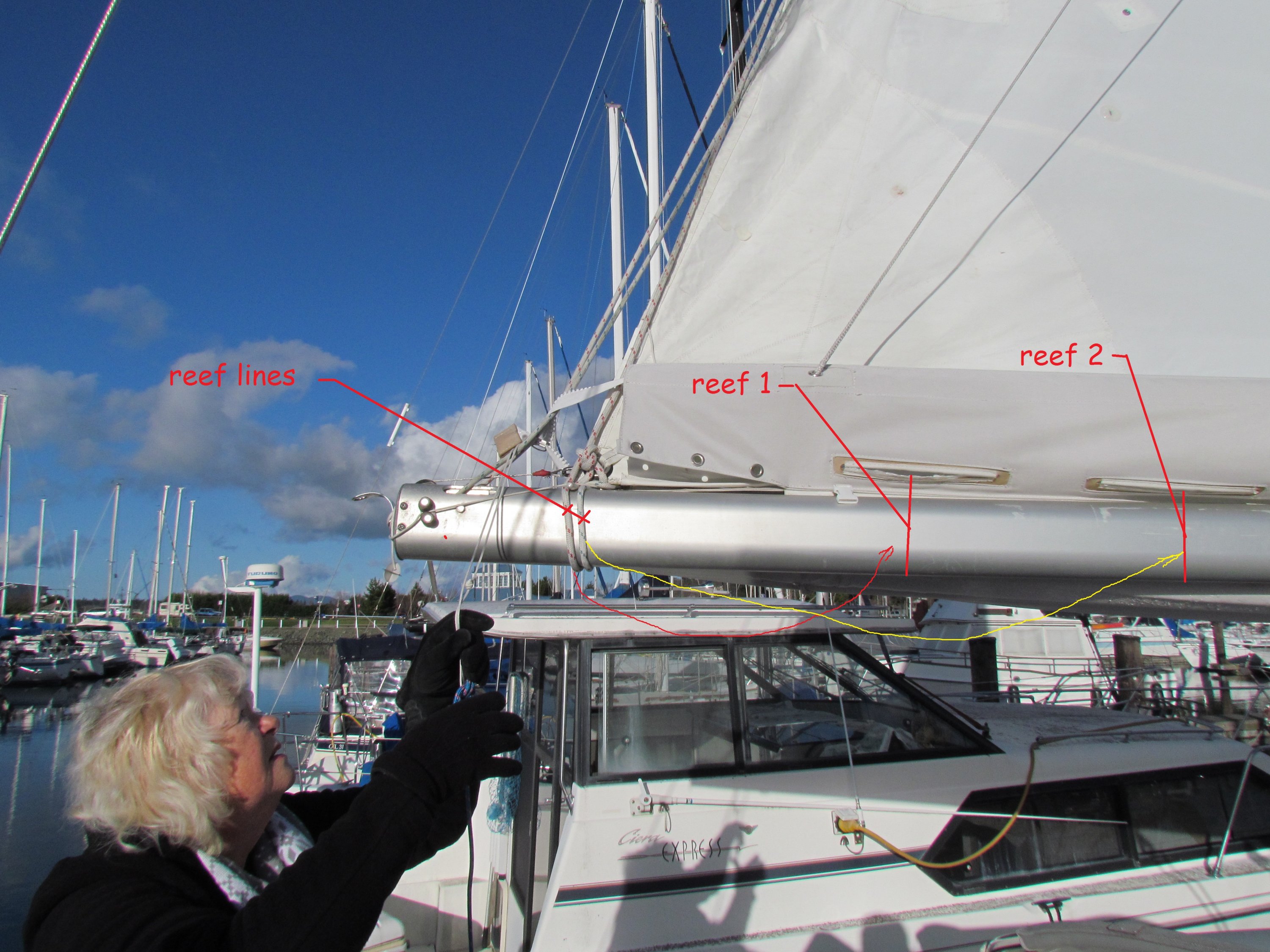

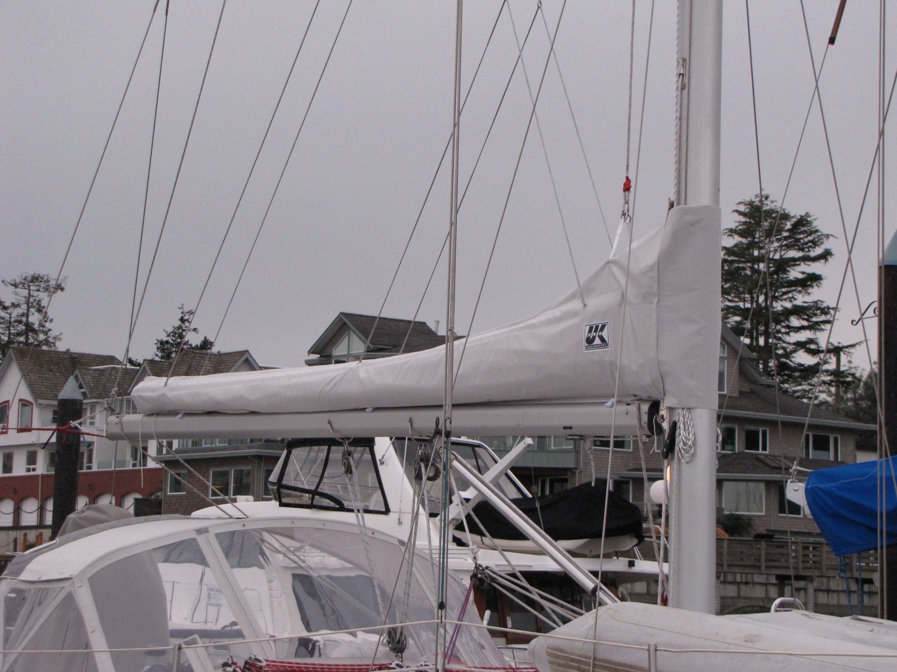

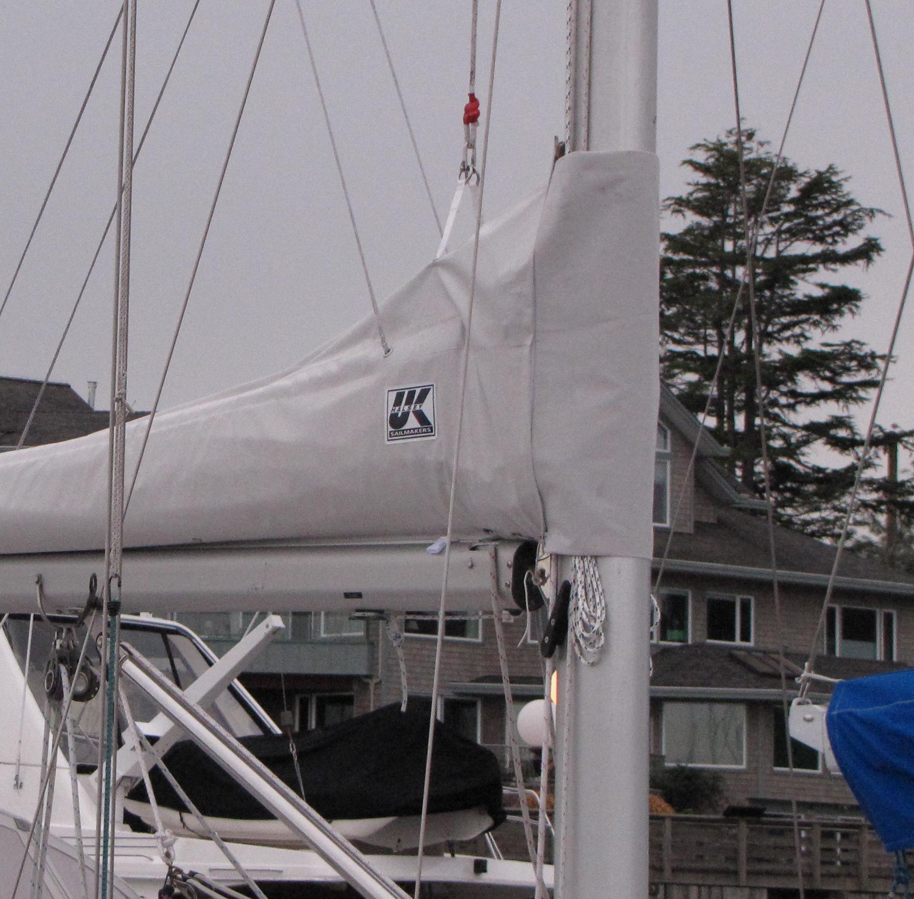

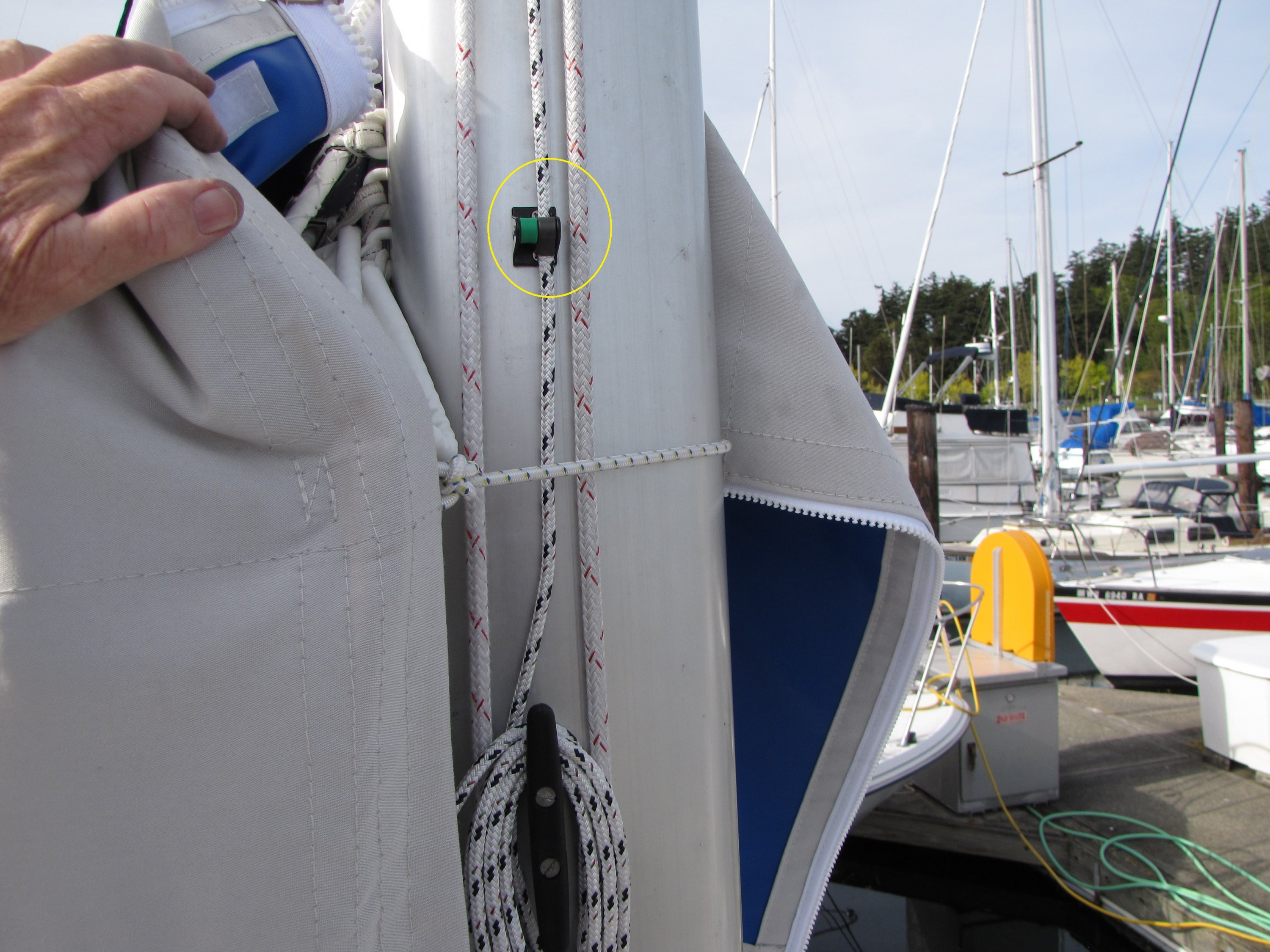

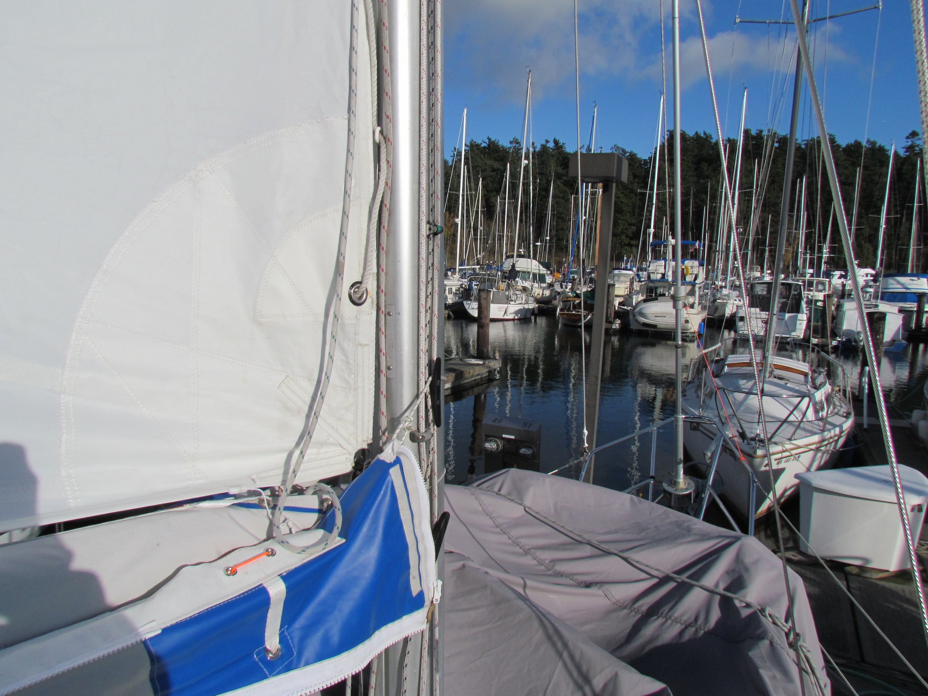

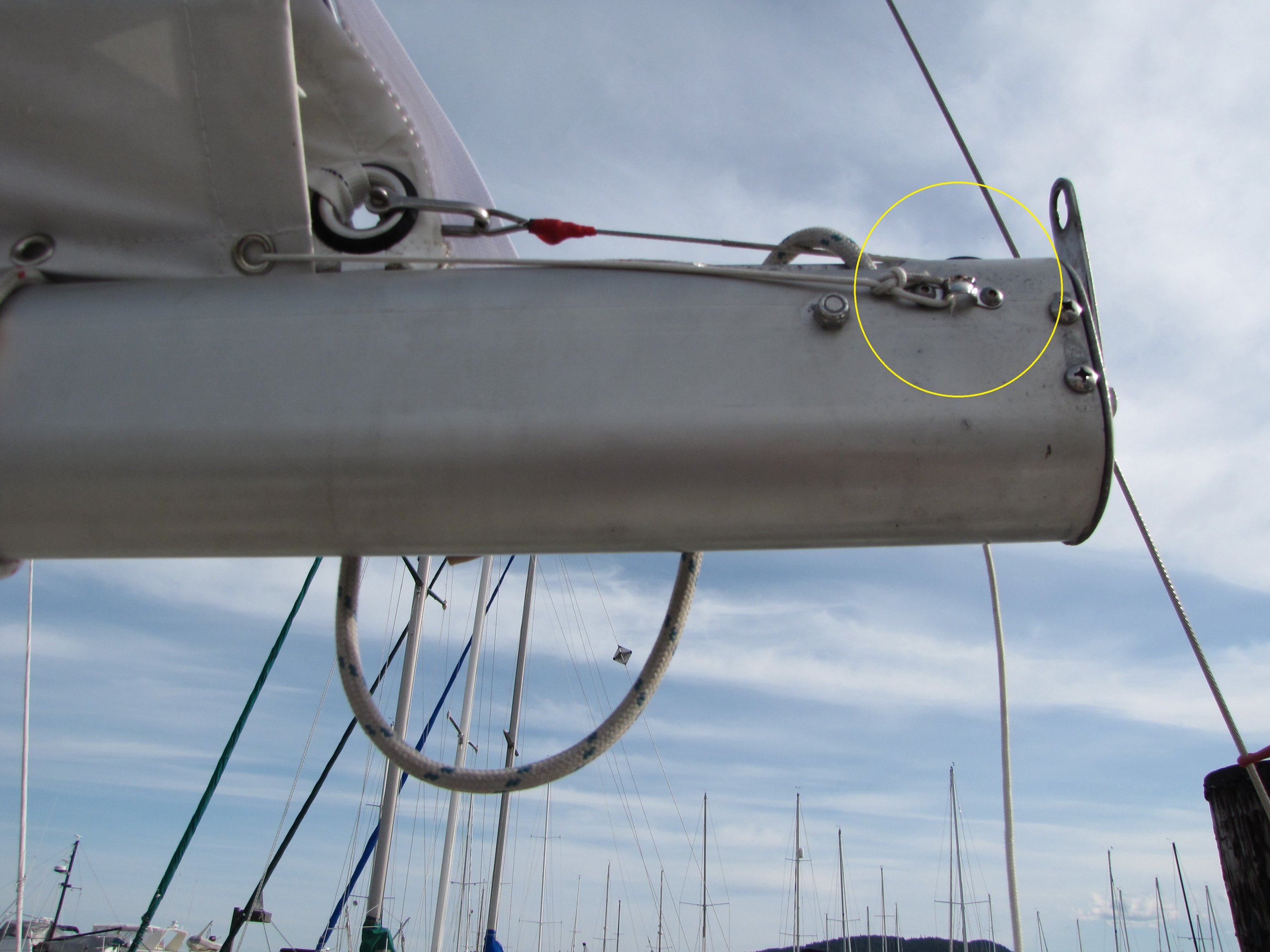

In 2008 I got a UK Halsey cradle Seattle Boat Show special and was installed in Sidney, BC.
My main sail was also converted to a loose footed main.
I made a couple of modifications to the setup and have been satisfied with the stack pack or cradle as it was called then.
Installing mast gates allowed sail to come all the way down.....easy peaseee
I made the decision for a stack pack because a lot of charter boats in BVI had them and it looked so easy to handle a big main sail.

Russ, in your mod2 pic, there is a leather opening... for what purpose, please?

The loose-footed main is recommended because the bottom edges of the sailpack are connected to each other under the sail with webbing straps every couple of feet, I think I have 4 for a 9'6" boom.
For the old main with a bolt-rope, I had to take a hot knife and cut slots in the sail just above the rope and thread these through them, which wasn't a big deal (once I got over the idea of putting holes in my sail).
When Bacon Sails put together the new main, they automatically suggested the loose-footed main and I think you will find on the site thoughts about how they give you better sail shape.

That's what Sailrite recommends, I guess it saves on installing a track, I honestly didn't know and went with what they said to do. Same thing with the new main from Bacon Sails, I took their recommendations when I ordered the new sail. The boat will now actually track in a straight line on its own, so they must have done something right.
