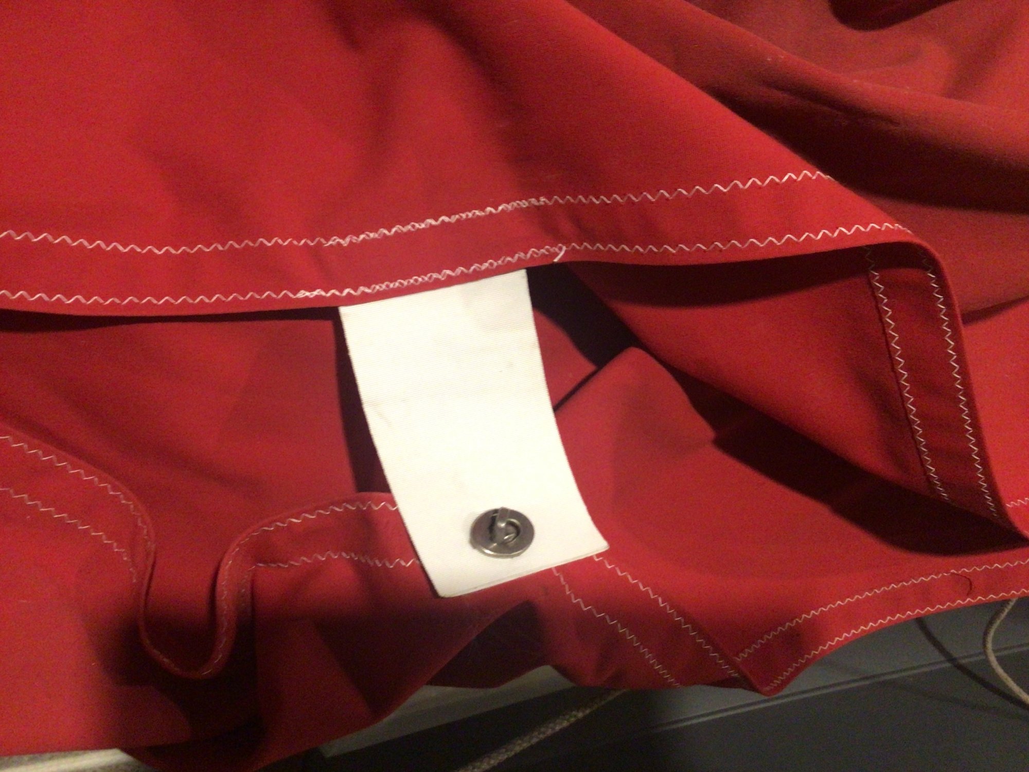

Yes! My Mack Pack was originally used with a bolt rope main sail. I was not keen on cutting slits in my sail for the “connectors” on the 2 sides of the bag….in consulting with Mack Sails, they told me that they do exactly what you are suggesting.
1 side of the strip of Dacron is sewn to one side of the Mack Pack. The other side has a snap type fitting, so you can disconnect it and get in then boom slot. See attached photo.
