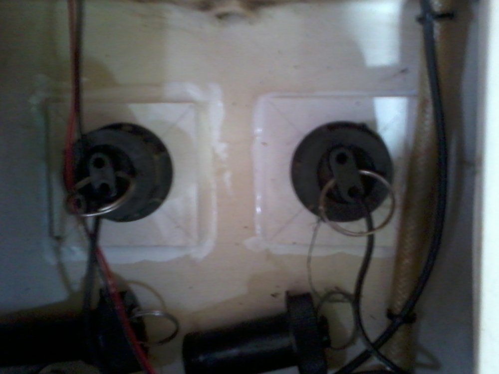

After our recent haul out for fresh bottom paint we developed a pretty good leak around the depth sounder transducer...boat is now back in the yard to re-bed or replace the transducer. Anyone else ever have this issue?

What do you mean "around the transducer"?
A picture would help.
Do you mean "in the sleave" around the transducer? Or on the outside of the sleave?
Whose system (RayMarine, Simrad, Garmin, etc.)? Which model of transducer system?

It is a Raymarine unit about 15 years old...looks like the water is coming out under the flange/nut with the gasket under it....I do suspect the strap was directly accross the transducer and broken the seal, as far as I can tell the unit can’t be removed from inside like the speed unit.

Strap should not do that, in my experience. It could ruin a paddle wheel speed sensor. But unless you had a protruding transducer (like a forward or side-to-side) it shouldn't affect it. Does the yard use carpet or other pads on the canvas?
If you don't have a Sleeve-type mount, then you have to have the transducer properly rebedded.

Update: depth sounder transducer rebedded, speed unit housing replaced and rebedded...no more leaks.
I guess after 15 years it was their time. Thanks to The Boat Yard and Marina in Fort Walton Beach for the fast haul out and repairs.

The reason for having removable depth sounder is to allow replacement without having cut-it out; and, to avoid bottom paint over the transducer (which often interferes with the signal).
A properly padded sling and a property reinforced penetration will do fine with being "slung". A paddle wheel for a speedo always, and many non-flush depthsounders. would be likely toast.
