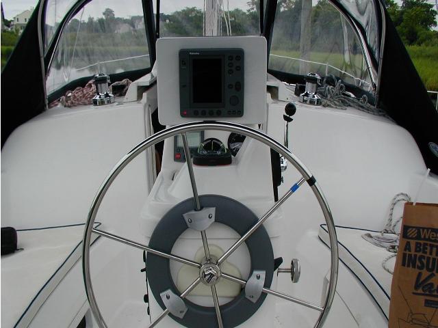

I'm about to install our new ST4000 and am curious as to where others positioned the flux gate compass and control head. After spending a couple of hours on the boat this afternoon I'm inclined to put the compass on the rear side of the aft berthing area forward bulkhead and the control unit just below the port winch handle stowage area. I have a pedestal guard installed but I'm hesitant to go the Navpod route. Your thoughts would be appreciated.

...and control unit next to the companionway. I think the fluxgate is supposed to be nearer the centerline as practicable. Just put it where feet are not likely to kick it. There is no particular reason to mount it on the pedestal. It's not like you turn it on and off every few minutes. Rick D.

Dave, We had ours mounted low and just forward of the middle of the boat. We have since moved it to the rear bulkhead. Frankly the boat moves around less back there and so there is less wandering induced from the flux gate compass. We also added the Raytheon gyro stabilized unit. That has made a large difference in the stability of the system. The 4000 control head allows you to do many things, including small to large course corrections, auto tack, plus track to a waypoint with the right gear connected. I would mount it on a navpod at the helm to provide convenience for those inputs. Dan Jonas (S/V Feije II)

Thanks for your inputs gentlemen - they were appreciated. I think I'll temporarily place the compass and controller as per my original request and go for a trial run. If I'm not satisfied with its performance I'll try a couple of other locations. Dave Winiker H31 "Champagne on Ice" P.S. This web site is awesome. I found an old long lost friend and Hunter owner that I haven't seen or heard from for 10 years.
