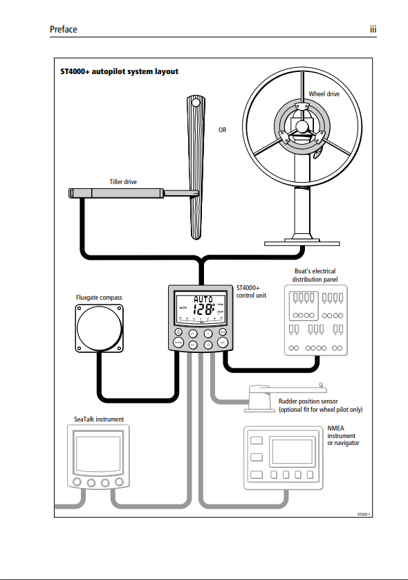

Pretty obvious where and what the computer is with a glance at page iii. Your chartplotter doesn't have the software to read the ST 4000+ input and then compute an output to the servo motor at the wheel. Only the ST 4000+ control unit can do that. The control unit is the computer to which you refer.
As for the compass, that's more than a bit of a bugger. Mine is buried at the very bottom of a hanging locker against the forward edge and you do have to look closely to find it. All I can suggest is a closed off space in the middle. I don't even want to say this but maybe take a look in the bilge for an elevated surface.
