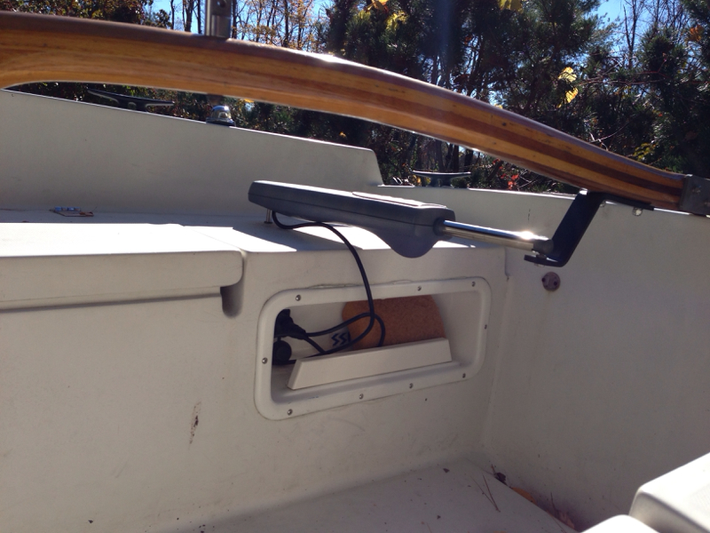

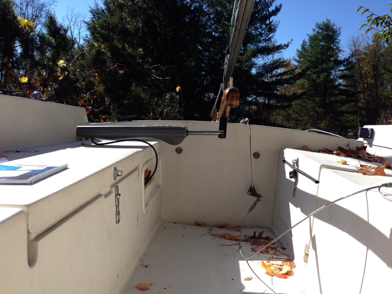

Just wanted to share install information. I used a 3" drop bracket on the tiller and put the mounting socket right in the starboard cockpit seat.
I put the power socket in a recessed shelf installed in the cockpit sidewall. That keeps it out of the weather and out of the way.
