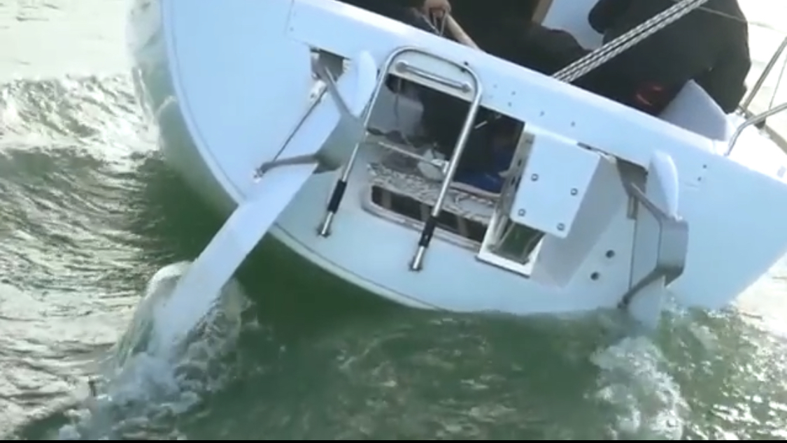

I screen grabbed this from the online video
Can you mount the TP on the structure that “bridges” the transom.

I don't think that will work

Looking at the pics and manual.... it appears you could mount it on the bench and use an under the tiller bracket for the tiller's control arm.... as long as the bench backrest restriction doesn't place the TP too close to the tiller.
Other wise, you can build a mounting base so the TP clears the lip of the backrest... and place the unit at the right level to put the pin right on top of the tiller.
