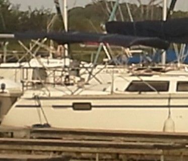

Thanks JD, for the diagram too. When we got her and right away were having trouble, the angle was the first thing that came to mind. Then I thought has this always been a problem, for the PO too or is it new?
I don't have a good picture. I cropped one from a distance. It kinda shows the block leading the sheet at a pretty low angle to the winch. I need to drive out and look a little closer.

What does your sheet run look like? I’ve seen Hunters in that range that take the sheet AFT of the winch to a cheek block and then forward to the winch to get a better angle.
