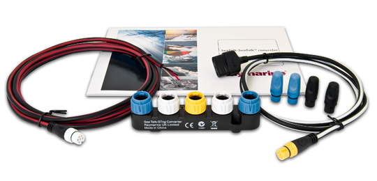

Simple you just need a Raymarine SeaTalk1 to SeaTalkng converter kit
Part Number: E22158

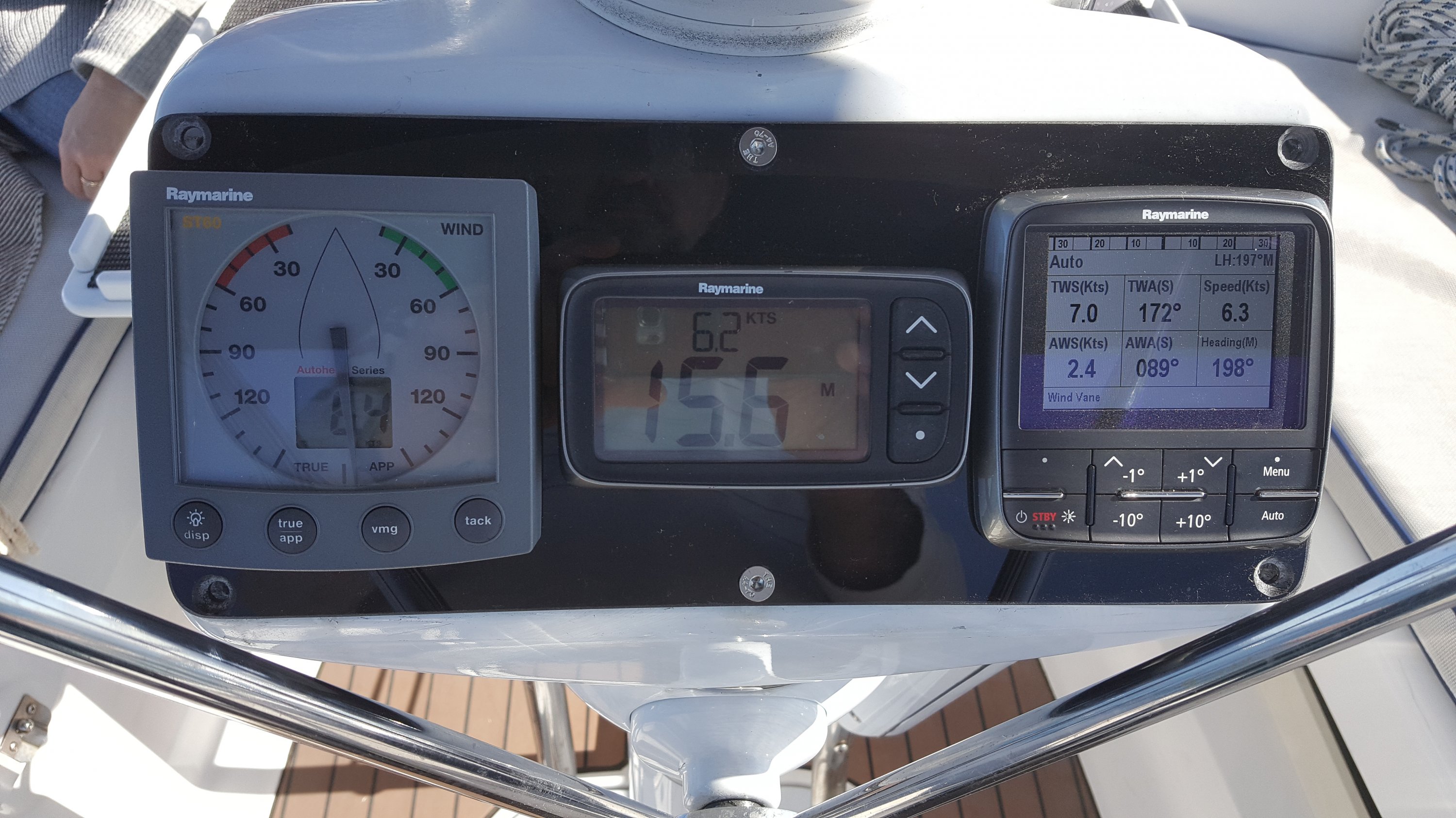

Just finished Raymarine EVO Autopilot installation on my Hunter 38 and have connected it to old ST60 wind/speed/depth instruments through Raymarine converter kit (Part Number: E22158)
This converter allow you to connect Sea Talk network (ST60) to SeaTalk NG (EVO). Please note - you have to disconnect power from old SeaTalk network - it will be powered through new SeaTalk NG. Also with new P70 control head you can display all data on one screen (as per attached photo) you can remove few instrument displays if you have no room... LOVE MY NEW SYSTEM!!!
The E22158 is great if you need to get to STng (really N2K) / NMEA 2000 but Capta needs to get to NMEA 0183 on his older Robertson AP.. Raymarine used to have a ST to NMEA 0183 converter and there are likely a few out there.
