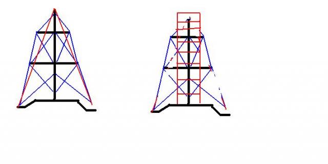

Ok....now I'm a little lost. Can an inverted V (left side of picture) work on most or all freq or does it need to be like a ladder on the right side of the picture?

Franklin, the reason for twin lead is that you feed one leg of the antenna with the positive side and one leg of the antenna with the ground side of the signal. Problem is, my tuner (ICOM AT140) has only one line out (GTO15) so you have to have a counterpoise in place. (It would look like figure A)
Like the left side of the picture. The twin lead to the center is flat and about 3/8ths of an inch wide. Ladder line typically is about 3 - 4 inches wide but also flat.
