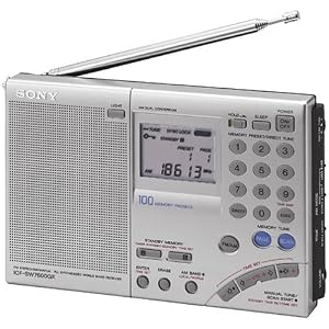

I have used a Sony ICW-SW 7600G the past 5 years and always found it to work very well. Not sure how you intend to use it, but to listen to ssb weather broadcasts I don't think you can buy better even at a higher price. The price today is much below what I paid for mine and I still consider it well worth the cost. I have compared it side by side with other receivers like YB400 and found this works much better. It does not have dial tuning but you can use a jog button.
Bob
http://www.amazon.com/Sony-ICF-SW7600GR-Shortwave-Receiver-Reception/dp/B00006IS4X

I have a friend that Bob also knows that....
.... has that radio and he has taken his Mac from Seattle to Alaska and back (not on a trailer), to the Exumas and cruised the Sea of Cortez extensively that also has that radio and loves it.
I just added it to my Amazon cart also. Thanks Bob and PM me about any new boat purchase news,

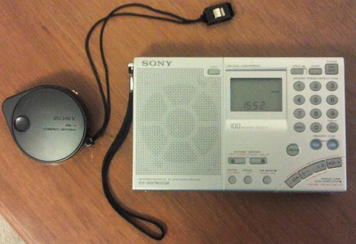

The Amazon link mentions an external antenna comes with the radio. But then it also states customers bought the short wave antenna. Necessary?

Ed I just ordered the radio, but no antenna because of the following that I read....
The external antenna is included in the box, and appears identical to the Sangean ANT-60 antenna - only the names on the antenna are different (Sony vs. Sangean). Do NOT buy the Sangean antenna as suggested by Amazon (unless they finally change this product page) or you'll end up with two essentially identical plug-in longwire antennas.
If you are interested I'll post if the antenna does indeed come with it. Only problem is I got the 'free shipping' and they aren't fast so it might not come for a couple weeks :cry:.

Thanks for the info. Some of it I understood and some I didn't. Eventually if we leave U.S. waters I'd like a full receive/transmit SSB radio like one of the Icom's, but right now I'm too lazy to figure out how to work one efficiently. I hope the Sony is somewhat easy to use and I think it might have some of the features you mentioned.
Here is one person's impression of it......
For many reasons this is absolutely the best valued shortwave receiver on the market.
1. Synchronous detector! It enables the radio to lock
onto signals with tenacity. It reduces fading and noise and
enables you to eliminate interference by selecting a sideband
on the other side of the interfering signal. On the SW7600GR
it works very well. No other radio at this price has sync
detector.
2. Build quality. Made in Japan. The radio even feels
robust. It is.
3. Sensitivity.
4. Great portability.
Of course there are also some liabilities.
Sound through the little speaker is not as good as some
competing products. But given that this little Sony blows
the competitors away in almost all other respects,
this is a minor quibble. The sound isn't bad; it just
isn't room filling. As a personal radio this isn't such
a liability. Plus, you can always use earphones or connect
to auxiliary speakers (Cambridge Soundworks?).
The memory system is simple, without alphabetic labels.
There is no tuning dial, just jog buttons for scanning
the bands. Simplicity makes for easy operation, though.
FM reception is respectable (much better than the very
expensive big brother the Sony ICF-SW77). Standard AM
reception is good, possibly very good. But if you are
interested in DXing the AM bands, you already have a
GE Super Radio.
It doesn't have an AC adaptor (and you should AVOID buying
the horrible--and horribly expensive--official Sony adaptor).
If you want to power from AC, get an inexpensive one. I power
mine with rechargeable NiMH batteries which work better than
alkalines and can be reused hundreds of times. Buy two
sets of batteries and you'll always have a set charged and
ready to go. Battery drain is respectively low and the unit
functions perfectly on the slightly lower voltage NiMHs.
As a travel radio, or as an introduction to shortwave, I can't
think of a better unit. Probably the best recommendation for
the 7600GR is that in spite of all the laudable reviews, using
one for the first time still surprises. Originally priced
at just under $200 US, current street prices make this an
incredible value.
Now for the bad news. Sony is getting out of the world band
radio business. These little gems may soon be unavailable.
So if you're interested in the 7600GR, now is the time.
Even though we probably don't need the radio right now I ordered it after reading the last paragraph above. If they do indeed get out of the market at least I'll have it. Thanks for the info if you can decipher any of the above in layman's terms that would also help,

No a 'short wave' (trapped dipole, etc.) antenna isnt necessary, especially on this particular 909 type radio which has supreme automatic filtering, etc. For most reception all you need is a 'long wire' (supplied) and can easily receive signals that arent directly beamed to your location - and this is a distinct advantage of this particular radio over almost all other 'portable' SWL receivers. A dipole antenna will however enhance reception ... for 'any' receiver.
