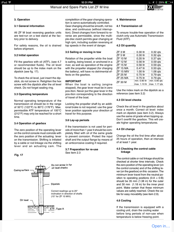

I did confirm with my mechanic that the tranny should be in neutral. Pretty sure manual says same, but will double check. Are you thinking the squeaking is coming from clutch plates? Thanks for the feedback!

Thanks for your ideas! Will see about checking alignment (although visually I don't see any obvious misalignment). ZF manual says "zero" position when sailing, engine off, which I assume is neutral. Going to run in reverse, though, until I figure this out. Will have to check the cutlass bearing when we haul out in October. I suppose I could swim under and see if I can wiggle the shaft at the CB. The water's warmed up nicely in southern Green Bay!
