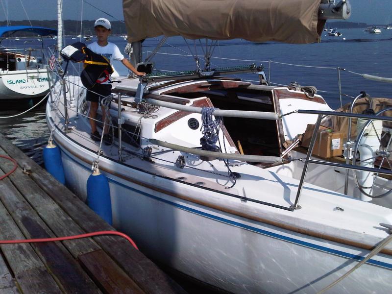

realized i have a very long outside rail (see attached) which i think would be good for the mid ship cleats. only saw a few in stainless, doesn't look as though yours are. any suggestions where to look for a bit less $$ than the stainless?
23,523
I bought mine at Nautical Engineering, 2 for $47 each, back in Sept. 1998. Don't know if they're still in business.
