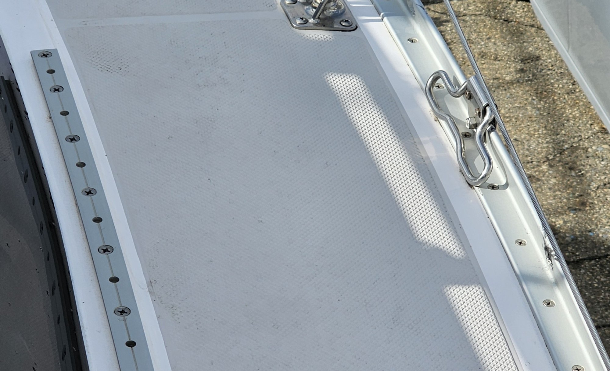

I have also been struggling with this issue, on my C-315, as well. Good mid-ships cleats would certainly be a welcome addition. Note that the Genoa tracks are somewhat inboard of the toe-rail. So, I am not sure that mounting a cleat on it would be ideal. As the picture shows I have mounted a C.S. Johnson Folding Toe Rail Cleat. Unfortunately, I do not find this to be a satisfactory solution either. The Johnson cleat is only held on by one screw which tends to loosen. Also, the cleat tends to rotate under a fore-aft load. Basically, it feels flimsy.

I agree with your conclusion @stephen_i_w . That cleat is not a good addition to your boat. I would remove it before it’s use causes real damage to your boat rail or hull/deck joint.
I chose a mid cleat like this.
installed with a strong backing plate. The two screws go through the deck and are positioned where they counter the forces being applied to the cleat. When not in use it folds down, out of the way.
I use them to stop my 15,000 lb boat as I come to dock.
