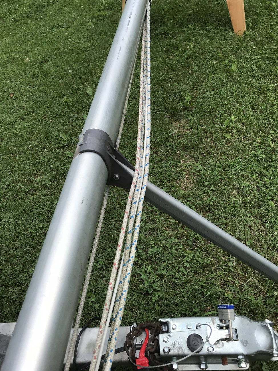

Is this what you have? If so, this is how I got mine on the mast. I put the spreaders on first. Then I held one spreader and my son held the other and we "opened" the jaw using the spreaders for leverage. I then tapped it in place with a rubber mallet.

yes rgranger, that's the kind I'm talking about. that thing has to spread open a lot in order to go on. It appears to be a cast piece and I'm scared it's going to break, (like your first picture). They also sent me an aluminum sleeve that goes around the mast, but under the wrap around spreader bracket. you apparently rivet the aluminum sleeve on 1st then put the spreader bracket around that and rivet it to the sleeve. Don't know if I really need the sleeve but the stock spreader rivets have pulled out of the mast so the holes are gonna be toast, enlarged. But the way the new spreader bracket rivets on, the holes will be in a different place so.......... I will know more when I take it all apart....

I'd rather not say how I broke my bracket :oops: but..I did not break mine trying to put it on. I was putting a new bracket on because I broke the old one. I did not get a sleeve with mine and it fits great. My original also did not have a sleeve. I'm wondering if your sleeve is meant to be a shim in case you have a smaller diameter mast? If that is the case you will have to make a judgment call and decide if you need the sleeve. I think that if you can get it on without the sleeve and the tolerance is not too great, just rivet the new bracket to the mast. The bracket goes on with some force but I would not simply whack it. Like I said earlier I was able to widen the gap by pulling up on the speeders. With the bracket on the mast and someone helping you to widen the gap, give it a gentle whack with rubber mallet. You can also add a few extra holes in the bracket flange for additional rivets if you feel you need them. I also did that because one of my rivet holes was blown.

Just to keep others informed, i did this this weekend and yes the wrap around bracket will press around the front of the mast. Takes some effort but it will go. Note, however the stock spreaders will not fit inside the bracket as i was told they would. I had to flatten them out some in a vice and then sand them down until they slid inside the spreader bracket. Do-able though. This newer style bracket is superior to the old style. Looks much stronger.
