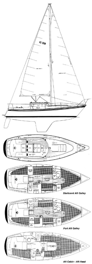

Had to look for an image of the Gulf 29. You have a fractional masthead rig.
Two sets of spreaders according to the sail plan image of the Gulf 29.
