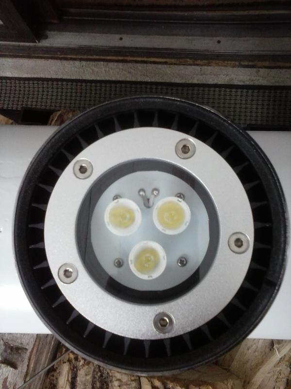

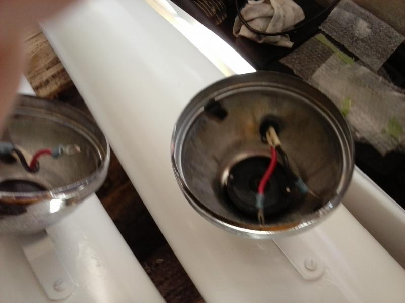

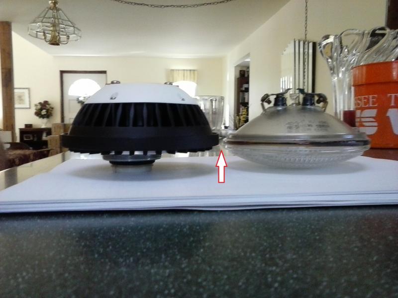

I'm trying to replace my sealed beam spreader lights with Marine Beam LED's. Because of the difference in shape the LED's, the back comes against the retainer for the duplex wire. If I remove the retainer the bulb fits fine, but then there isn't anything to keep the wire protected from chaffing or being pulled out. Plus with the hole being more open, the light would be more exposed to the weather. Picture 1 shows what I had and 2 shows how I stripped the duplex cover and pulled the wires to the side. However the plastic retainer still is too large so the back of the bulb won't center in the fixture. Picture 3 shows the difference in bulb design. Is there another way to protect this wire? I believe the fixture is a Perko adjustable spreader light.

looks like the buld you have may not be one designed for exterior work? The slots would be presumed for heat dissipation. You can use the grommets others suggested to create a gap between the buld and retainer.

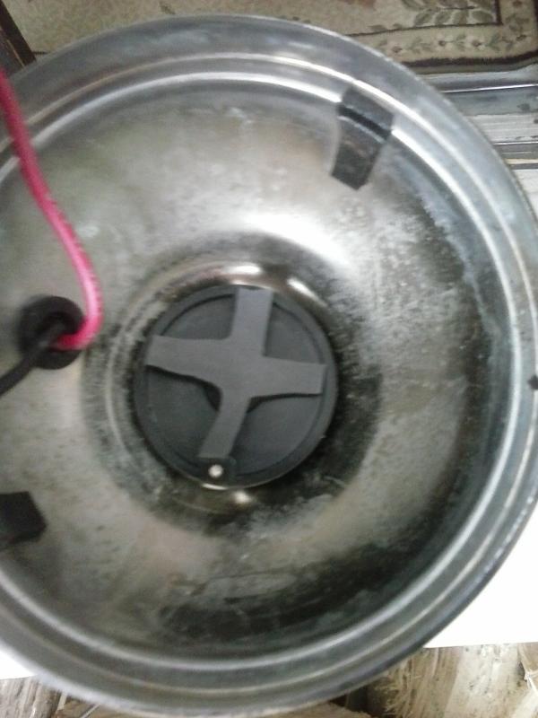

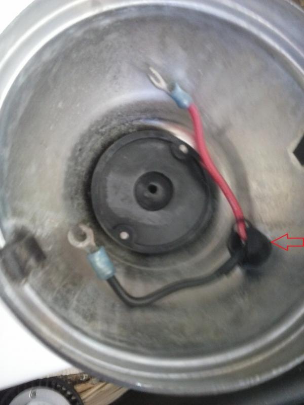

I cut a piece of neoprene to cushion the back of the bulb. I wrapped the wire with electrical tape and used rubber grommets I picked up at Home Depot. (They didn't know they had them in the store) All together now.
