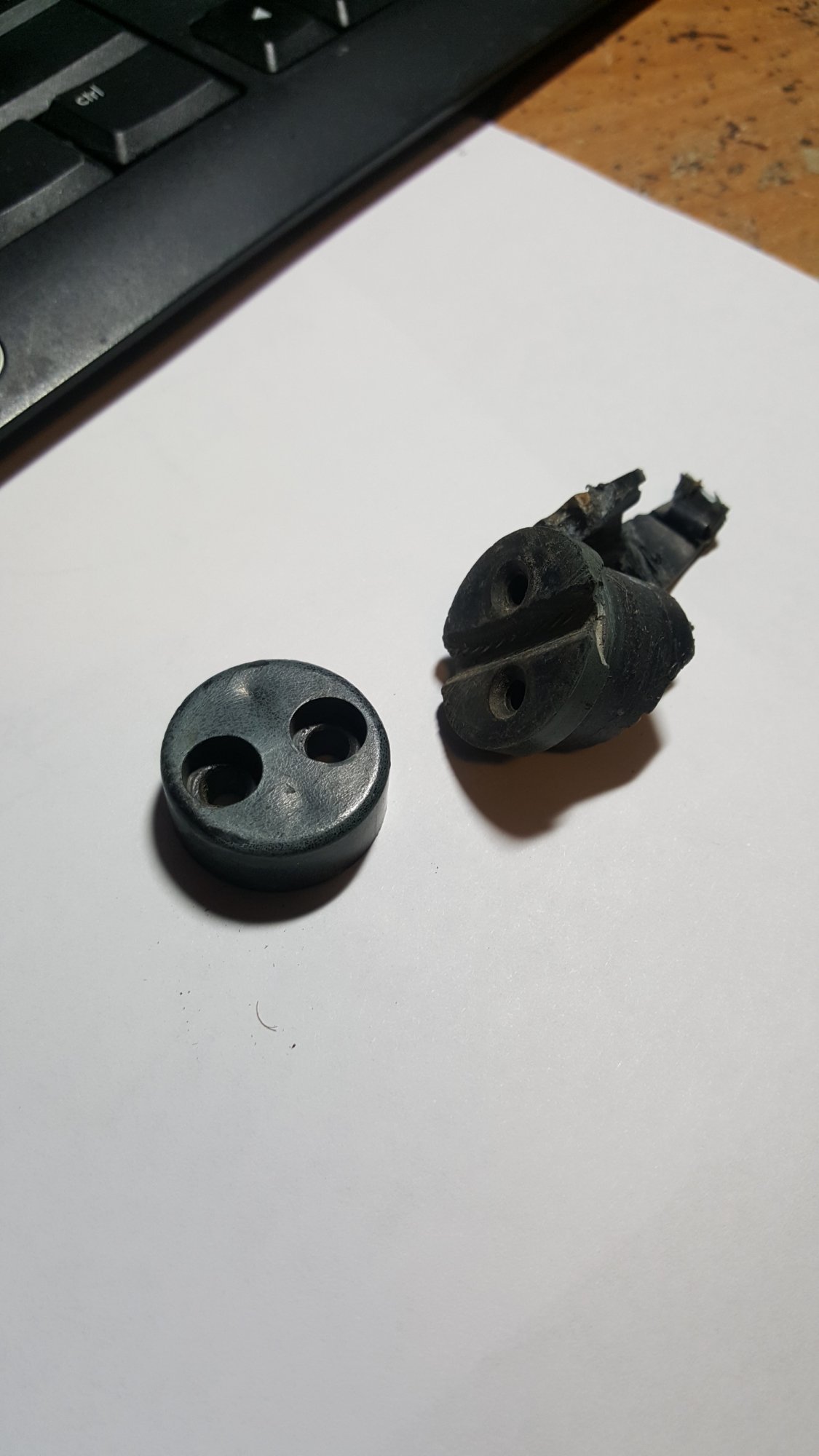

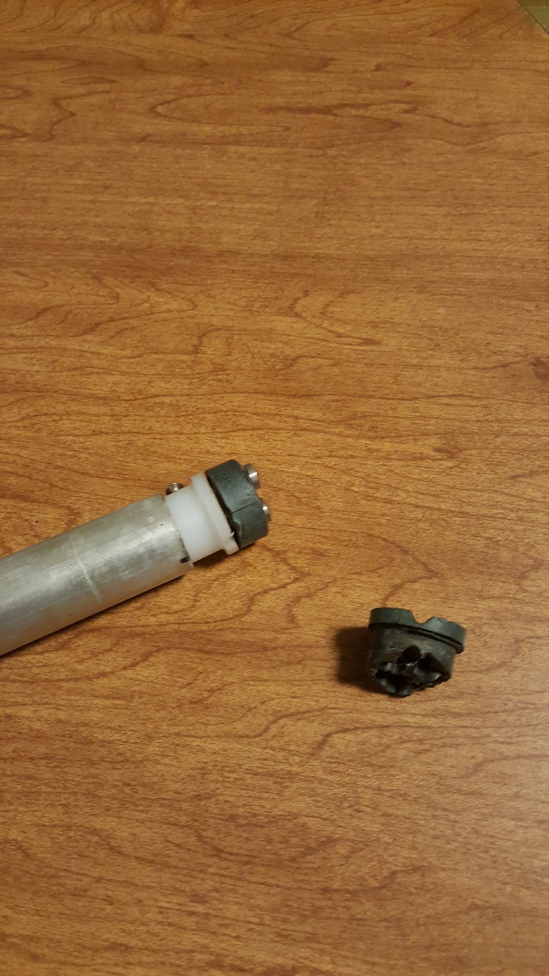

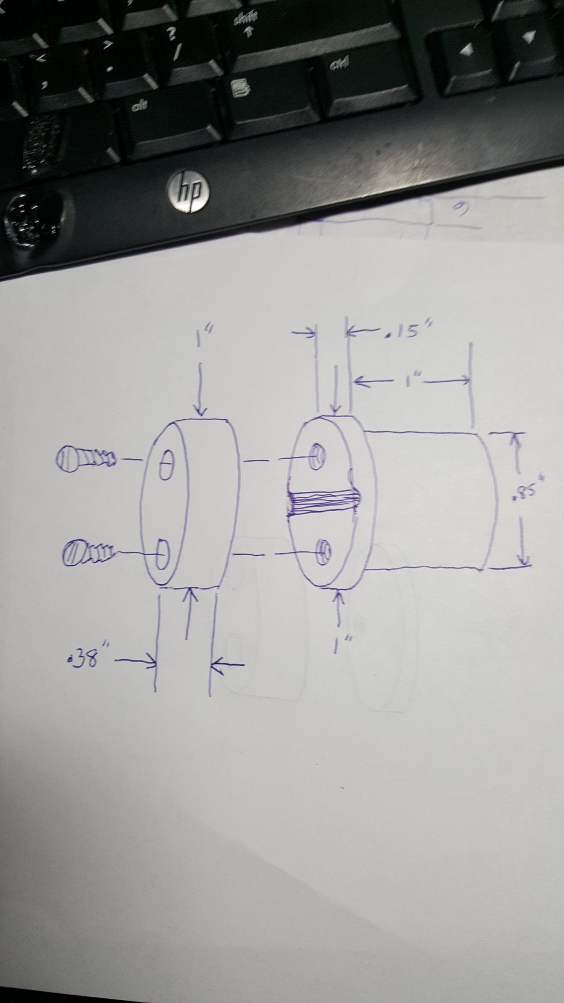

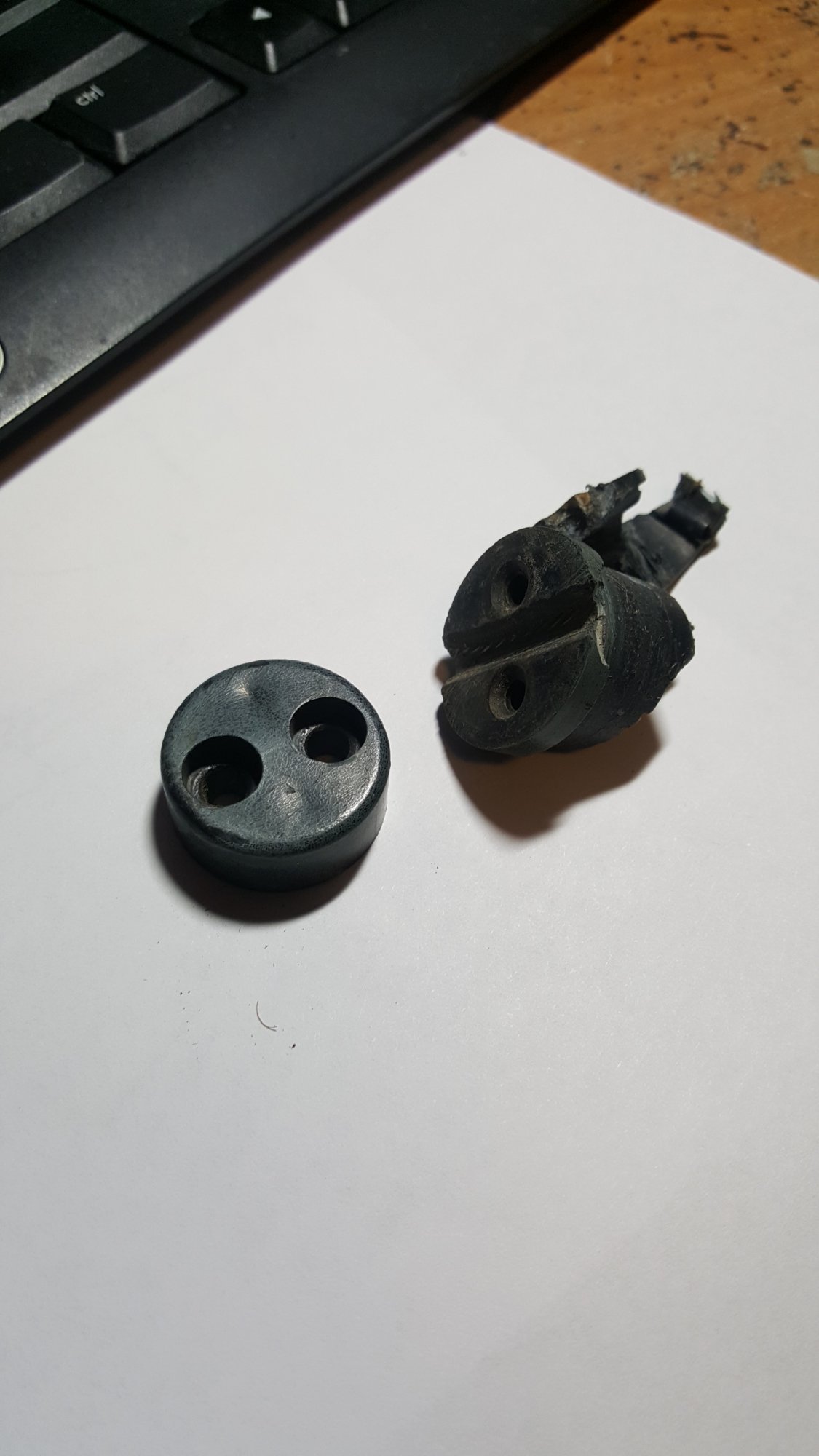

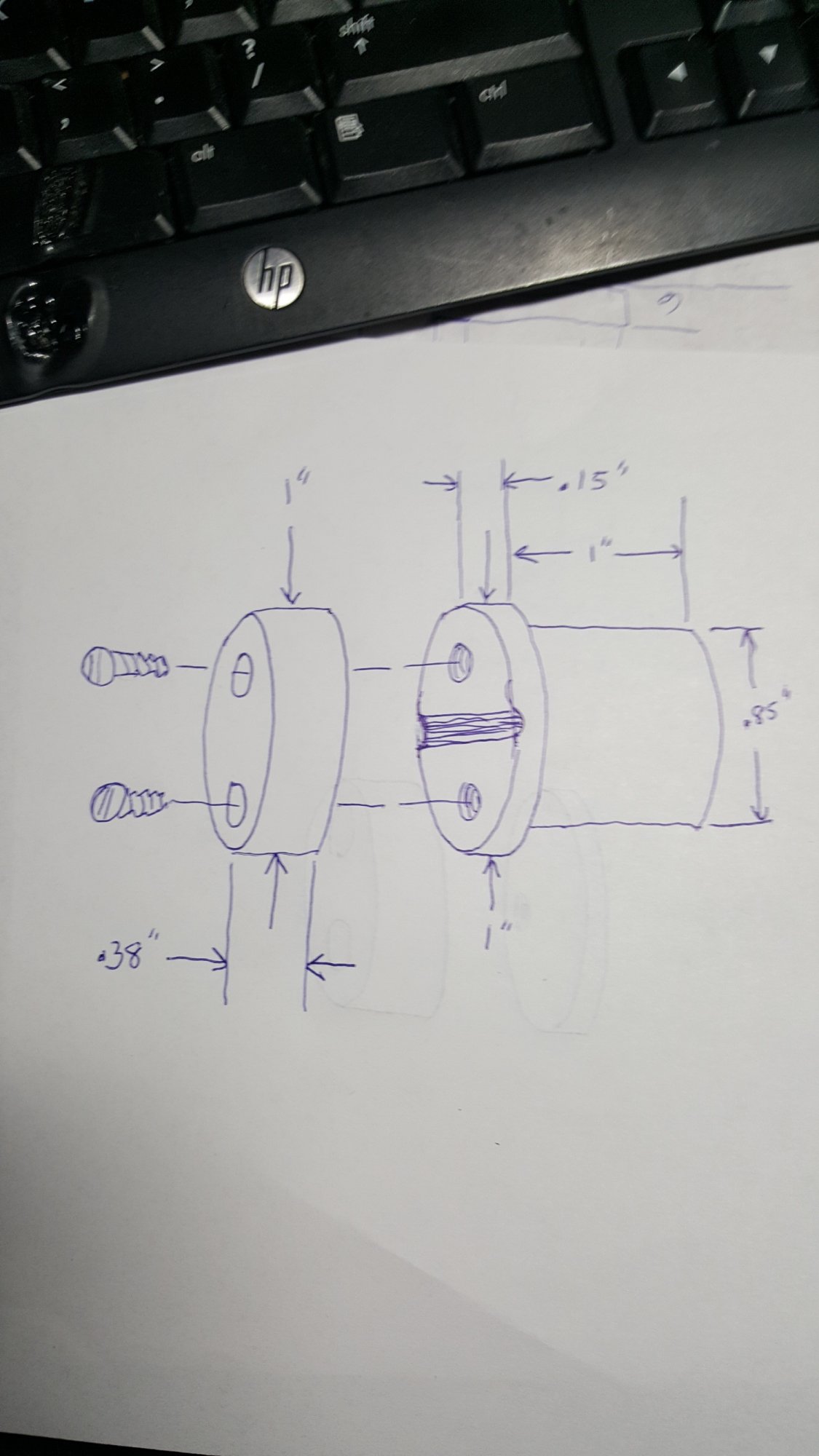

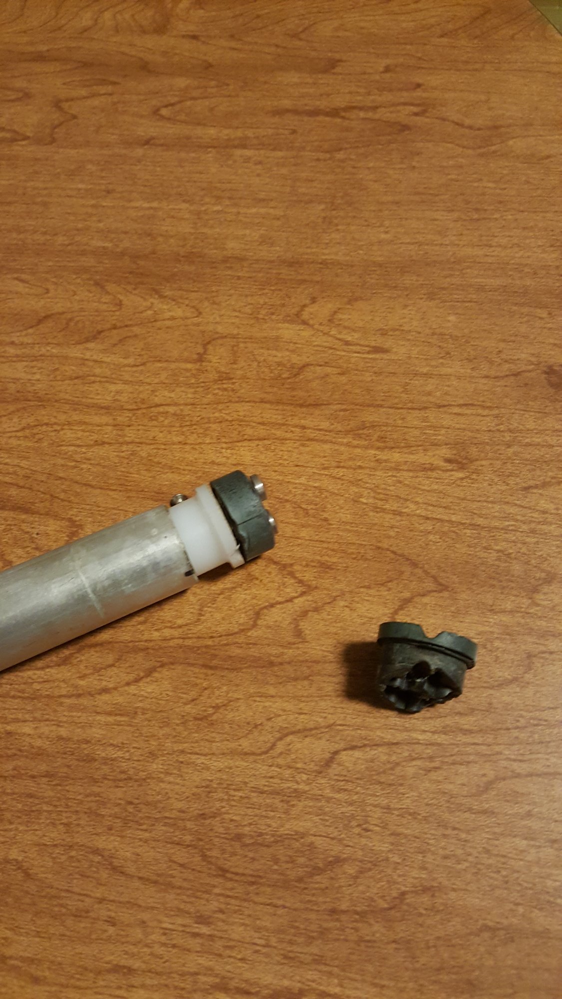

i bought an 85 Sirius 21 and found a spreader end was broken. then end cap was fine i just needed the inserted pc. i already had a bench lathe and bought a 12" pc of nylon off of Amazon for $10. an hour later I had one. just recently i saw on a Macgreggor site they show some for $16 that look to be the same. i do enjoy making my own though
