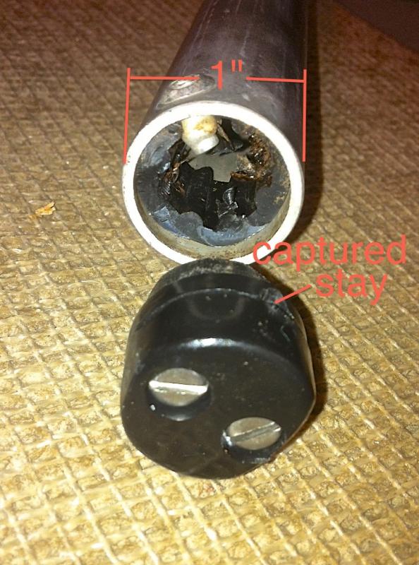

The polymer end of my 1" round aluminum spreader has broken. I would epoxy it but have not had great success glueing nylon-like plastics. Are replacements still available, any more common boats that used the same part? I can't seem to find any on the internet. We've had her since new with few issues.

Can you take a picture of the good/other side - spreader and end so we can see what you are trying to match?

Here's a shot of the broken spreader cap. As you can see part of it is still inside the spreader. Because the Sirius is a trailerable it is important that the new cap also be able to capture the stay so that it remains with the spreader & slides on the stay as the mast is lowered & raised. This must have been an off-the-shelf part in the summer of '85. There may be other boats with more production volume than the Sirius that are still be making parts available now.

Whatt is the spreader id? The pics look like the same as on my m25, if the id is the same I have a couple of extra and could send you one.

I found this at (bwyachats) as it looks similar to yours it may work for you. I had been looking for one myself but couldn't find it using 'spreader' or 'end' or 'clamp' as part of its expected name. So far I have not reverted to "thingy" but I seem to be getting closer as time goes on.
Rigging 3204-110 SPREADER TIP, METAL--THIS IS A DIRECT REPLACEMENT FOR NEWER BOATS WITH ALUMINUM SPREADER TIPS AND AN UPGRADE FOR OLDER BOATS WITH THE EASILY DAMAGED PLASTIC TIPS. COMES WITH INSTRUCTIONS FOR RETROFITTING OLDER BOATS.
Kit Contents: SPREADER TIP WITH 10-32 X 1 1/4" ATTACHMENT BOLT AND NYLOCK NUT.

Yep that looks like what I need two. The alternative is the whole spreader..
3201-1V0
SPREADER WITH TIP, 36 INCH
Notes: FITS ALL BOATS BEFORE 1995 26X EXCEPT V21 & V17.

Thanks everyone! I've bitten the bullet & epoxied the pieces together--it can be reversed if I find a part. I'm going to try it in the spring to see if it holds up.
Fred, that's a very generous offer; the ID is ~15/16". I'm going to stop at some boat yards that sell/service MacGregors in larger coastal cities in my travels this winter.

Harry, if you pm me with your shipping address I' send you two anodized aluminum ones that should fit.
