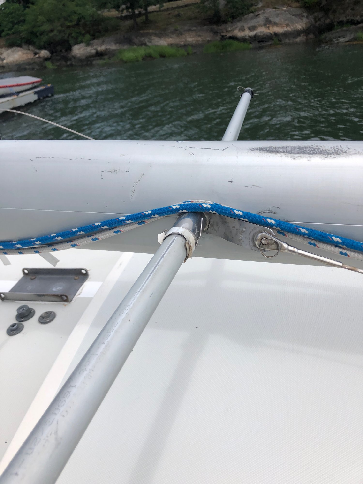

Hello,
fixing up a 23 o’day from 1978 whose mast fell over and caused some damage. I need to replace the round spreader brackets and in order to do so, I need to know what type of Dwyer mast I have. The options are:
DM-375
DM6
450
Does anyone know which mast would be the right one?
thanks a million this board has been so helpful,
Dan
Jun 29, 2020
8
O'Day 23 Larchmont

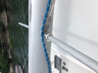

One other piece of information - it looks like I have a Dwyer 330 mast after looking at the hinged step (it says 330 on the bottom). But when I look at the spreader bracket for the 330 it does not look right?
Jun 2, 2004
1,952
Oday Day Sailer Wareham, MA
A call to Rudy Nickerson at D&R Marine (508) 644-3001 should get that answer for you, He was Parts Dept. Manager for O'DAY from 1973-89. OR contact Dwyer Masts, they would theoretically have that info on file.
