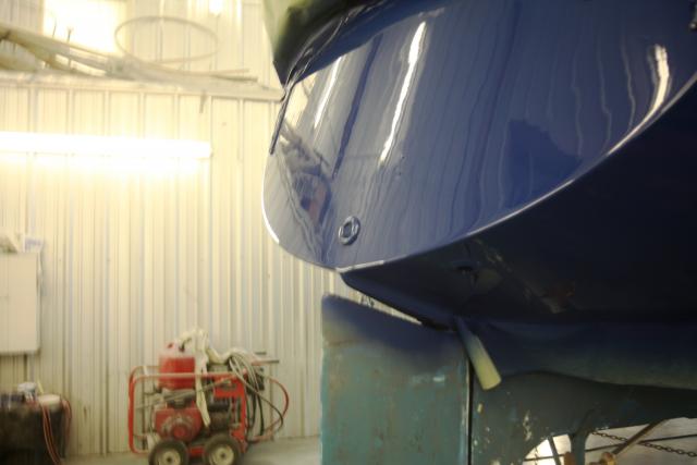

Expensive to take it down to galss and start over but now i know whats there.
This painter only used 2.5 qts of paint on a 30 ft boat.
