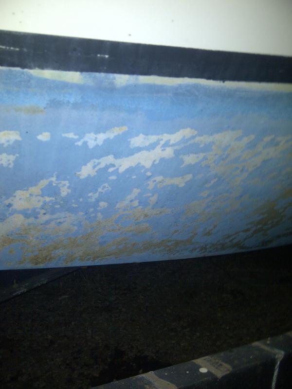

I am working on the same idea of a golf ball. Lots of dimples for better water flow. Just disrupt the surface relatively evenly and ta da. I'll test my theory by sailing it like this this year and finishing the bottom for next year. Then compare top speeds.
Here is a picture of my bottom. If you look closeley you can see the attention to detail.

Nicely done, finding41! Hard to simulate that natural uneven surface but you've managed it.
