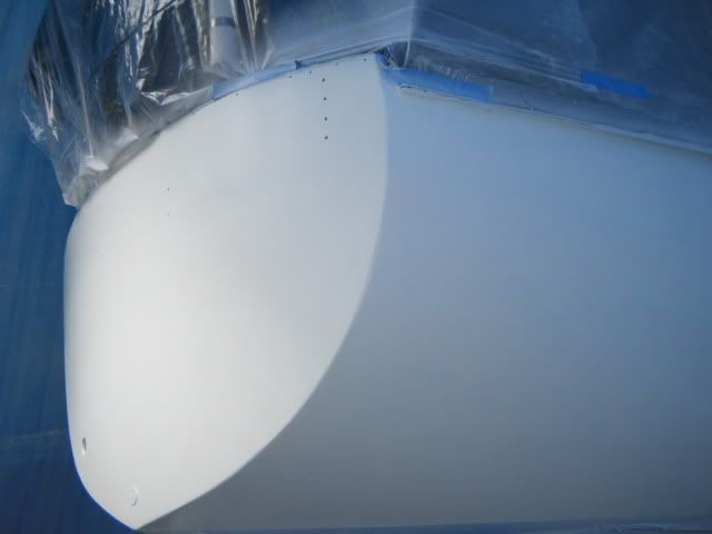

I had no problem spraying the 545 epoxy primer BUT there was no way i was shooting the Awlgrip on a 29' hull topsides and went with roll & tip
[/URL]
[/URL]
Looked through some of your pics. That roll and tip job came out quite nice.
