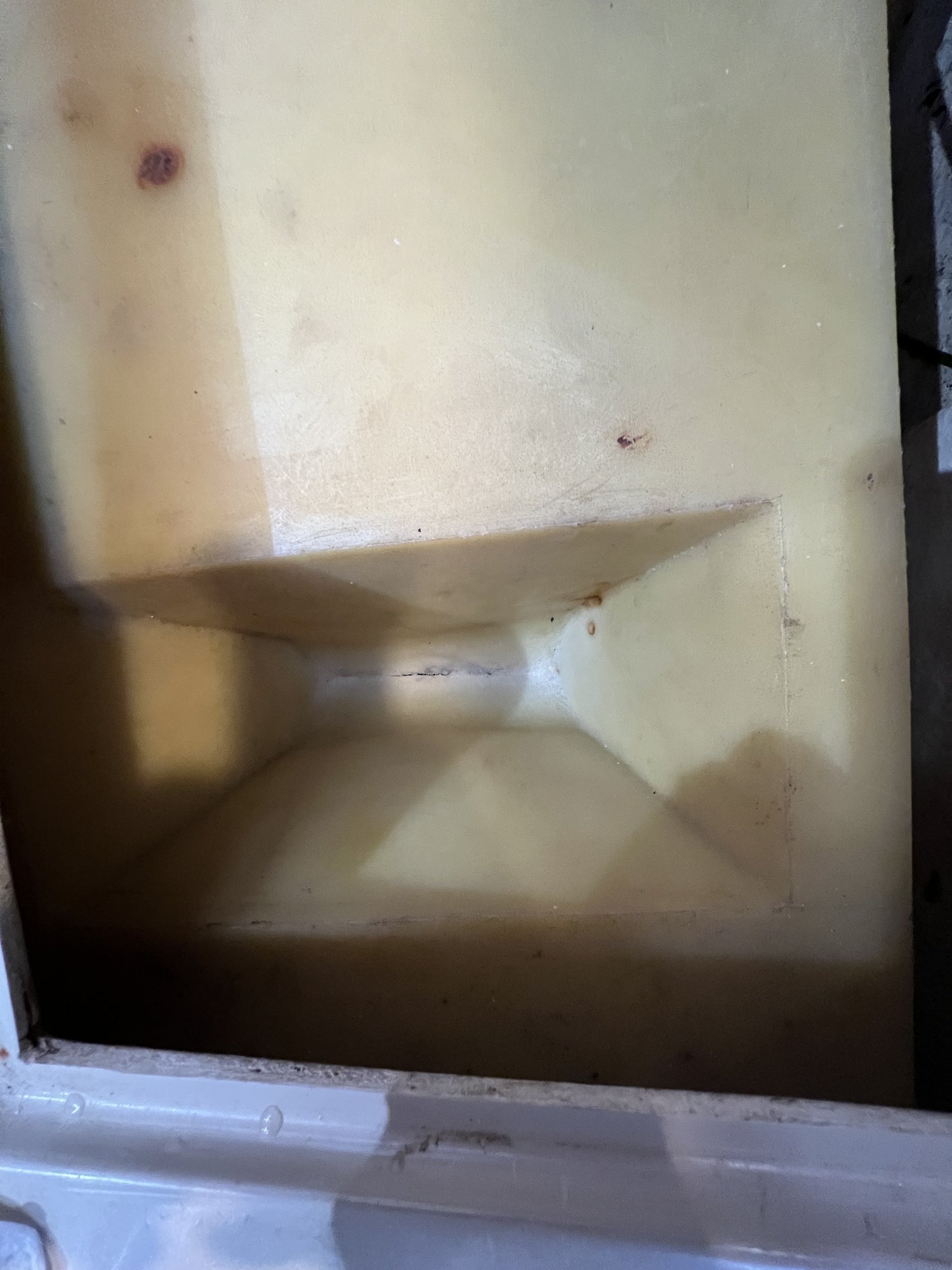

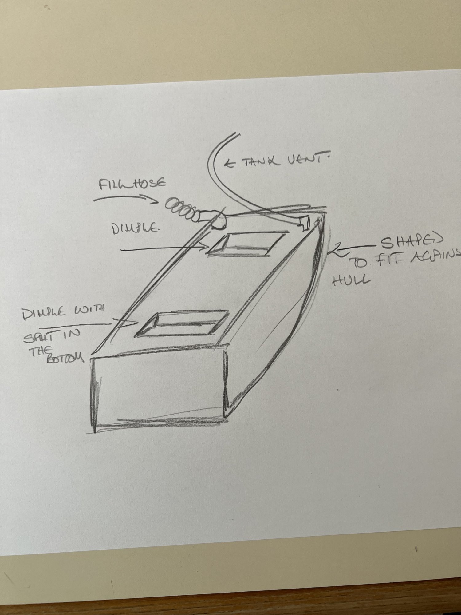

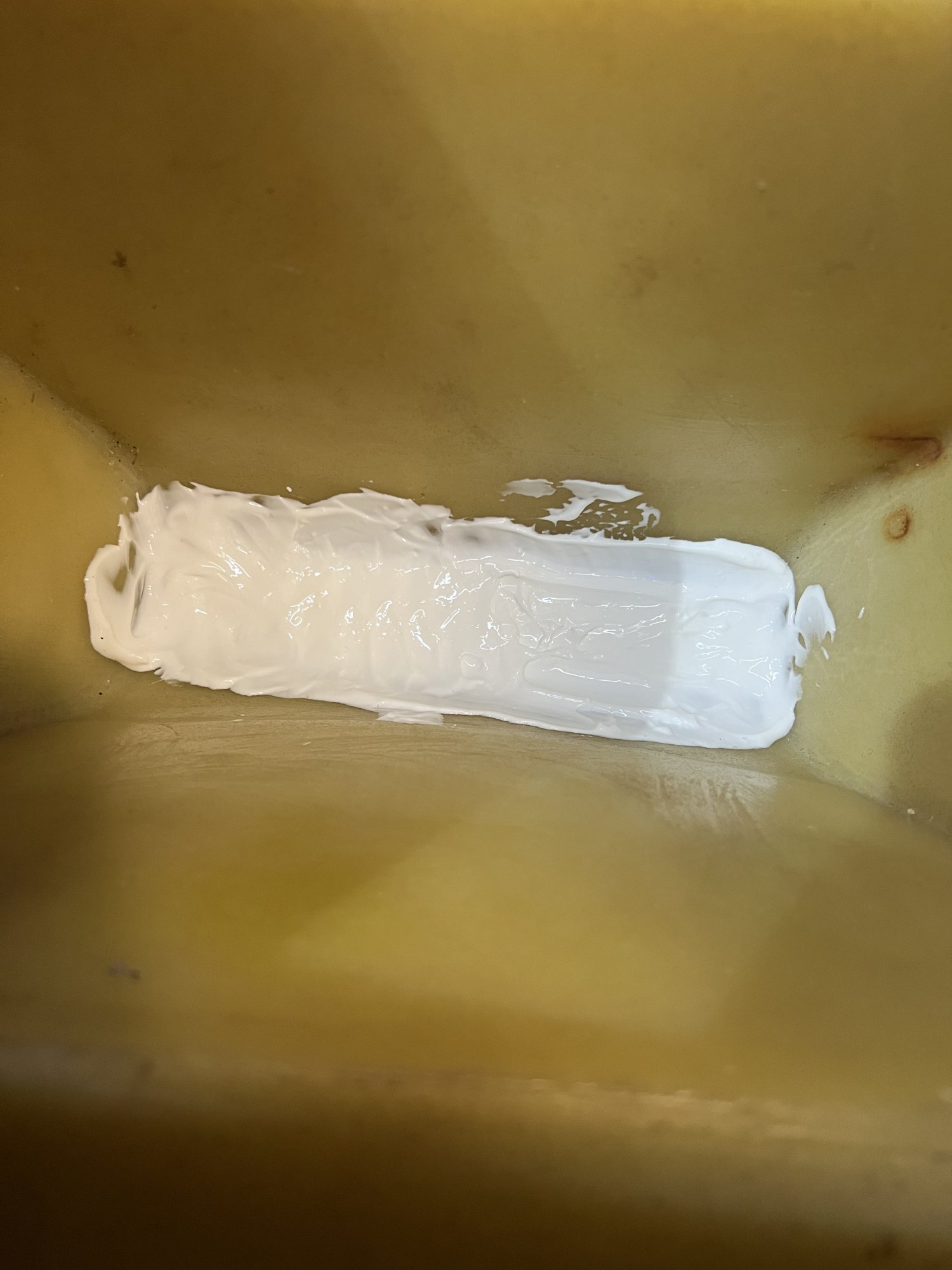

After watching a few videos on how to fix my tank, I got the gumption to try. I also have created a back up plan, should my repair not hold.
1) I twitched welded with my soldering gun, the split. I added plastic by using zip ties, melting it in on top of my stitches.
2) After sanding and cleaning the area involved, I dropped a large amount of Caulk Sealant over everything. Now it may not look pretty, but as it cures, it will level out and become clear.
It will take a good week to cure. Then I will test my repair.
3) My back up plan is to cut away the dimple and use a 12x12 sheet of 1/4" lexan, some sikaflex and make a gasket, basically making an inspection window.
14,145
The dimple is a baffle to slow the movement of a lot weight fore and aft in the tank.
