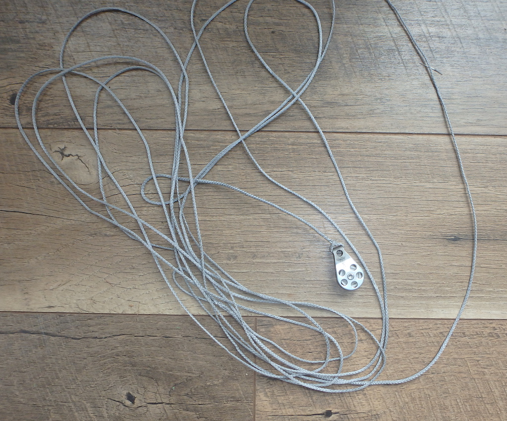

I wanted to add a messenger line for my 2:1 spinnaker halyard - a nice application for really thin (and low windage) line. I thought some others might be interested in my experience with this tiny line. (Note: I did this before reading Samson's site that calls Lash-it 'not spliceable'. In my experience, splicing is doable, but not trivial).

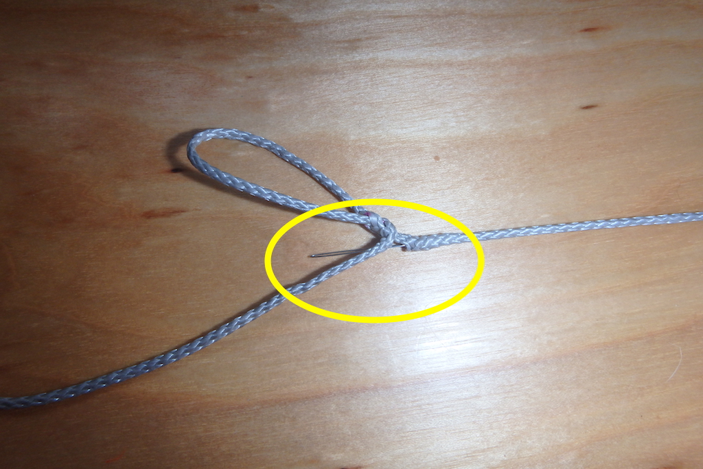

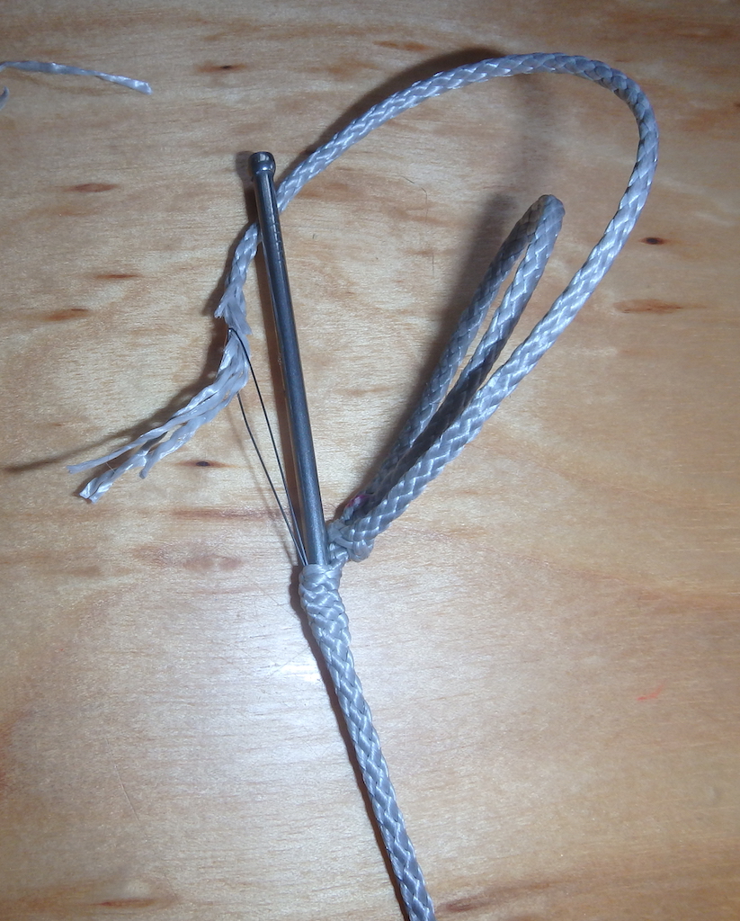

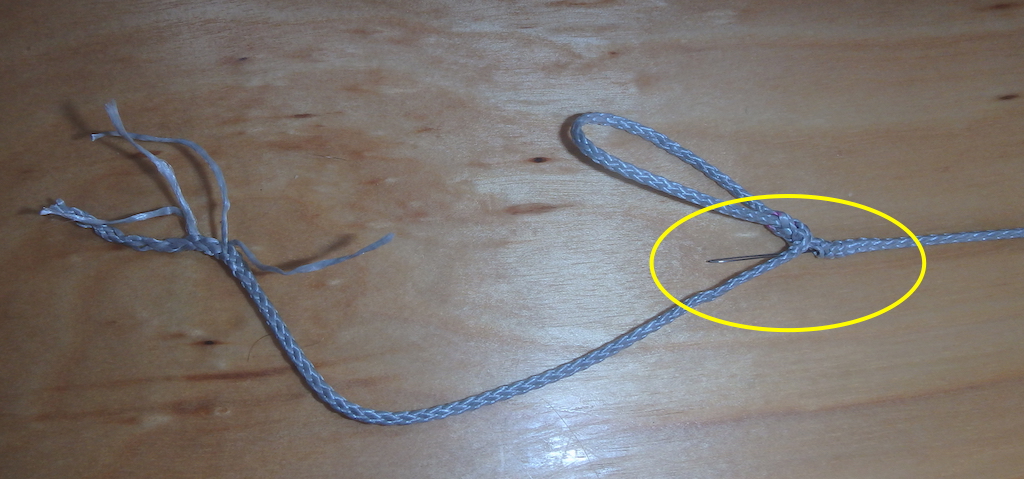

First, I found that my standard wire fids won't fit in it. I've always made wire fids from a random spool of wire I had laying around. As it turns out, it measures .035" (I never thought to measure before). That's too big for this line, so I picked up a bit of tiny piano wire on Amazon. I bought .010". It's working, but I'd recommend something in between. Maybe ~.020". If for no other reason than that the .010 is SHARP! I left a little blood on my desk during this project; caveat emptor.

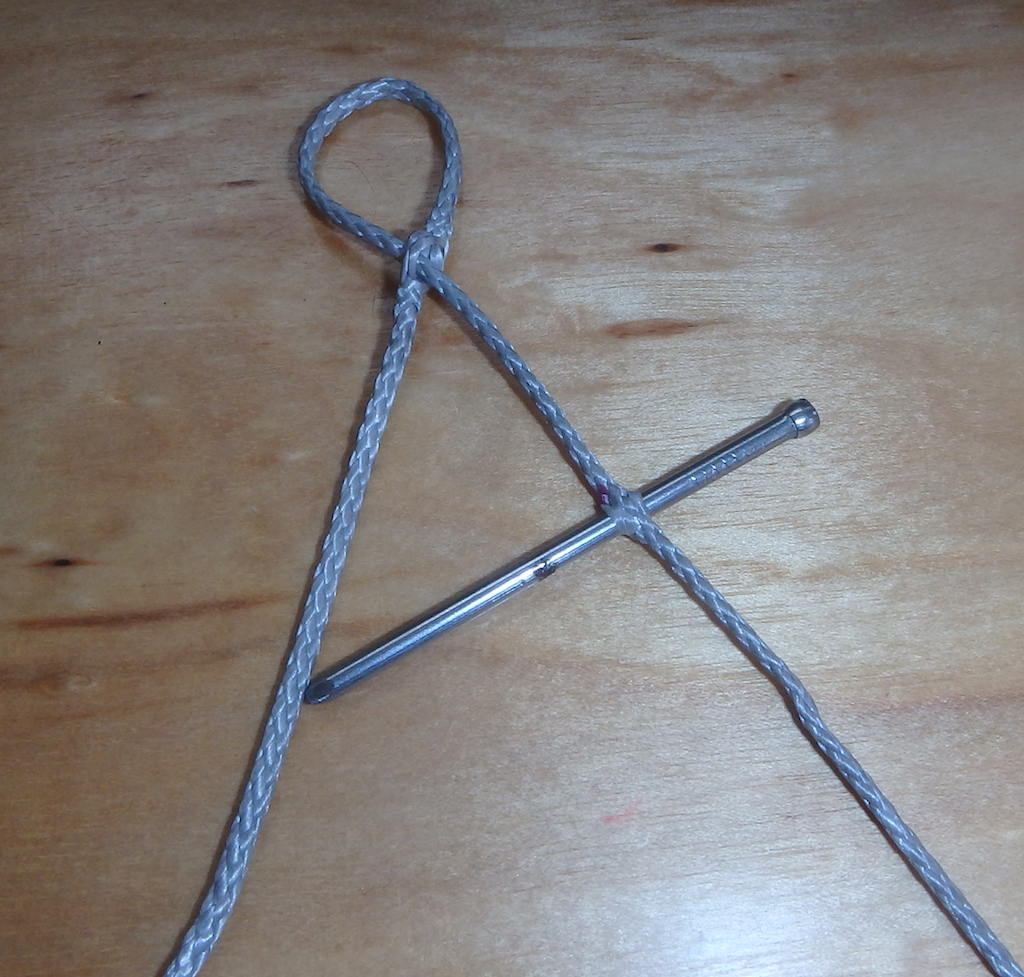

I wasn't sure if I could separate the braid enough to do a Brummel splice, but finish nails of a couple sizes (dulled just a bit on the grinder) worked well (then I can get a normal fid in to widen it a bit). If you have a tiny dull pick, that would work too.
The strands are pretty close to the limit of my aging eyesight, so I know my tapers aren't great. But for low loads, I think it'll work.

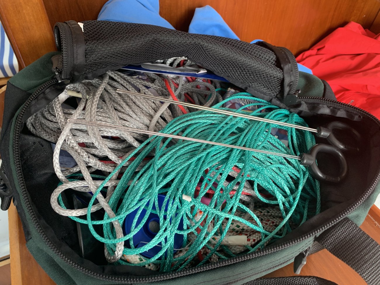

How fun. I can’t remember the last time I’ve done an old-school splice. Every line on my boat is either single braid or core dependent line. I still have an array of old circular fids, but now the D-splicers rule. The fids are now simply to create penetrations for Brummell splices.
Every year I buy 100 feet of that stuff and just put in my rigging bag. By the end of the year it’s gone.
