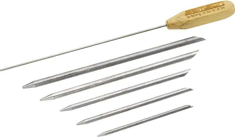

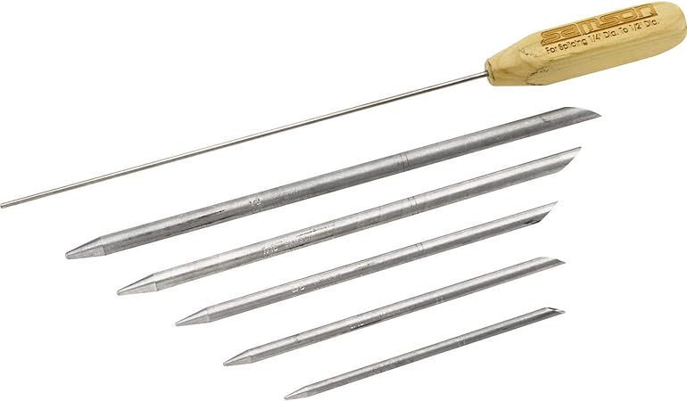

You use the word tape… It makes me think you are using fids like these made by Samson
I found they required tape not he outer surface to keep the core in the fid. That negated the ability for the fid to slide smoothly in the splice.

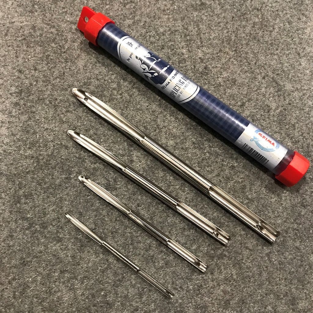

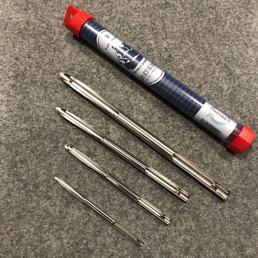

I replaced them with Selma fids.
I wrap the end of the core tightly with a little tape. (1.5 no more than 2 wraps). I then push the core completely into the fid. There is nothing on the outside of the fid to catch on the inside of the splice. It slips more easily through the core due to the polished surface. The longer core in the fid and the slight friction of the tape buried in the fid has made the task a little easier.

Brand new lines…… and yes Sampson fids. Beginners lack of knowledge when purchasing. Your fids look like a much better design.
