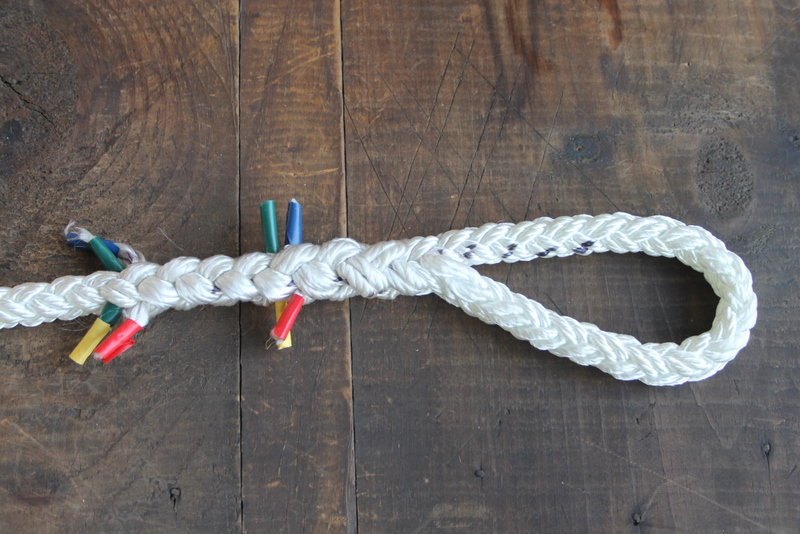

I picked up 150ft of 8-Plait 1/2" nylon line at Defender for $55 (closeout) and am currently making up a set of custom dock lines for our boat, the Samson site has an excellant video and pdf for 8 strand line, enclosed is photo of my first splice. I am thinking of using 8-plait for my anchor line also, as it is so limp and compliant it is easy to store in locker without tangles and twists.

Looks great. Roll it under your foot a little to smooth it out and replace the colored tapes with sewn whippings and it will be perfect.
That splice is not done correctly. I learned 8 plat in the merchant marine years ago, and often, i would be the only man on the ship who could do it, their are two ways, the wrong way, puting two strands under two strands, what you can find with these splices, is they get shorter, untill their is nothing left of them, but, in a sailboat, you wont put enough weight on them to do that. The right way to do it, is split up the eight strands into their pairs, then you take one pair, and instead of puting the two under, like you have done, you put one strand under one, and over the next, then the other strand over that one, and under the next, you work those two strands the full lenghth of the splice, then you start at the next two strands, when you get to the last two strands, it will be so tight, you will have to use a mallot, and a sweedish (hollow spike to get the rope open. You finish the ends, by either by taking the two strands, and whipping them together, or taping them, then you melt the very end with a soldering iron, or heat up an old knife and do it, or if you are really posh, use an electric rope cuter, wich will cut and bond them.
I followed the Samson instructions, your variation seems to make more sense. To finish mine I intend to remove the tape fold the ends back and use whipping around the whole splice in the two spots where the strands exit, I do not believe the splices will get shorter under even the worst storm conditions.
