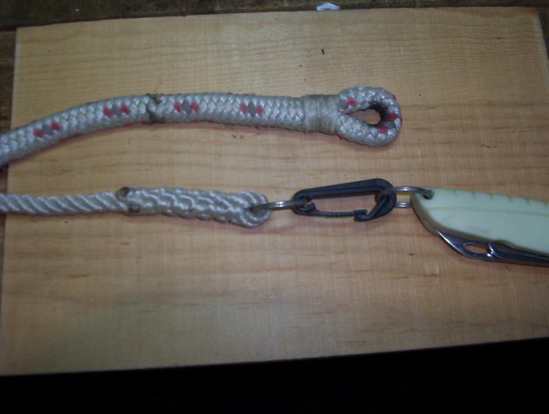

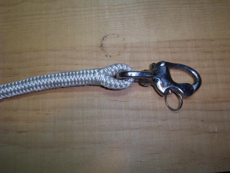

Over the years, I've gotten a lot of pleasure out of splicing lines for use on my boat for everything from halyards to knife lanyards. In the interests of full disclosure, I would admit that I'm good at splicing 3-strand, mediocre at splicing double braid, and I've never tried to splice some of the high tech, high modulus fibers. Yet I've been surprised at how many of my sailing friends have never learned to splice. Do you splice your own lines?
