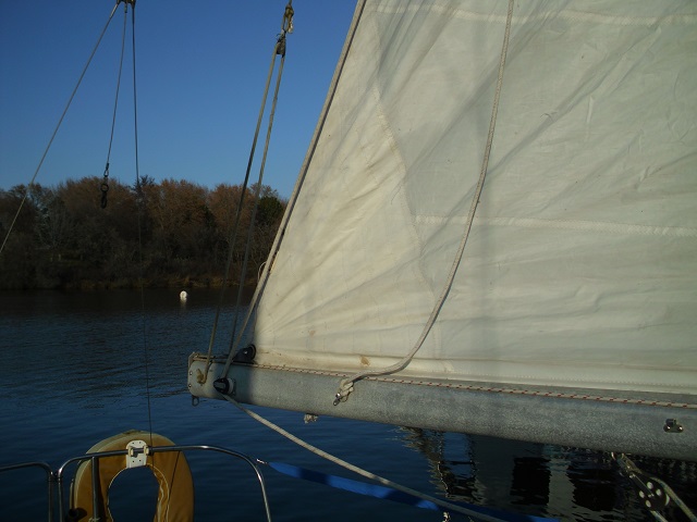

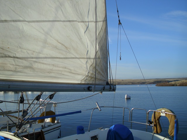

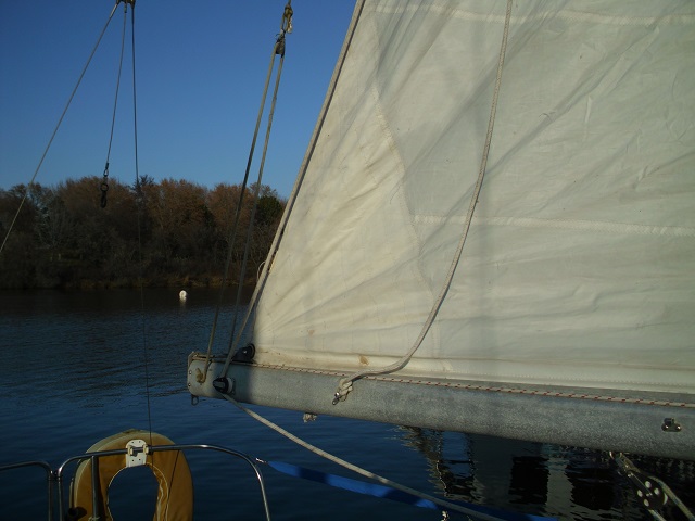

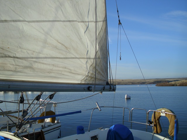

good to see you got her in the water and safely back to your dock. I have been meaning to respond to your previous post in regards to the sheaves, but been a bit busy. Anyway She looks great. I'll be glad when I get all the "little" things done. Nothing major, except re-stepping the mast. Just everything takes time. I have a new main sail due in in a couple of weeks, so I need to get the mast back up. As for the cable from the mast head, that is indeed your topping lift. A 1/4" line is secured to the boom, goes up to the small block on the cable, back down to the boom and through a cheek block to a cleat. I have attached a picture of how mine is configured.

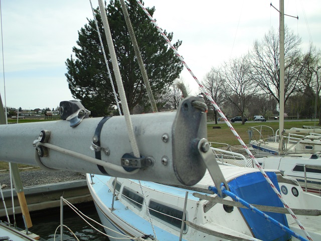

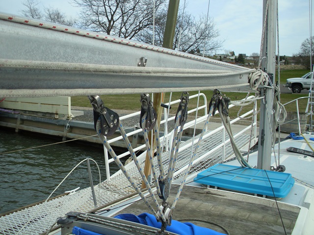

My main sheet is 6:1 (I think), and definitely rigged strange to me. Anyway, it runs forward to a block at the base of the gooseneck, then down to a turning block on the halyard plate to the starboard to a deck block then back to the winch and cleat. When the wind is up, you will need the winch. My 1982 N28 has Lewmar #7 winches on the cabin top (three). I have also included a picture of that setup too. I do not know if any of my running rigging is factory, I know the halyards have been changed to all line, but it seems to work fine. I will be installing all new blocks on the main sheet when I put the boom back on. The block sheaves have seen better days. Anyway, I hope the pictures help. A lot of info can be found in the manual if you have access to one.

In regards to the topping lift, according to the manual the upper portion of the topping lift was a d 1/8" stainless cable ~28ft long. Mine had been replaced with a 1/4" line. When I took the mast down, one end was tied to the mast cap, and the other end tied to the small block. I plan on splicing in a pair of eyes with thimbles to make it look a bit cleaner.

Ok, that does make a little more sense. I imagine the hook from the backstay is more for extended hangings, up out of the way then. That does make sense how it's run though, so that's good to know. My main doesn't have the extra couple steps, I don't have the block on the gooseneck or a deck plate (which I'll add next year for sure). You can barely make it out in my dock side picture, but mine comes off the foremost block of the three, down to an spring block, and back from there. Granted, most people aren't going to be trying to crawl back and forth under the boom on the cabin top to trip over it, so as long as it's functional for now, I'm good with it. Now that she's rigged up, I'm going up tomorrow to do some more cleaning and such, so I can take a lot more pictures of things I might question.
