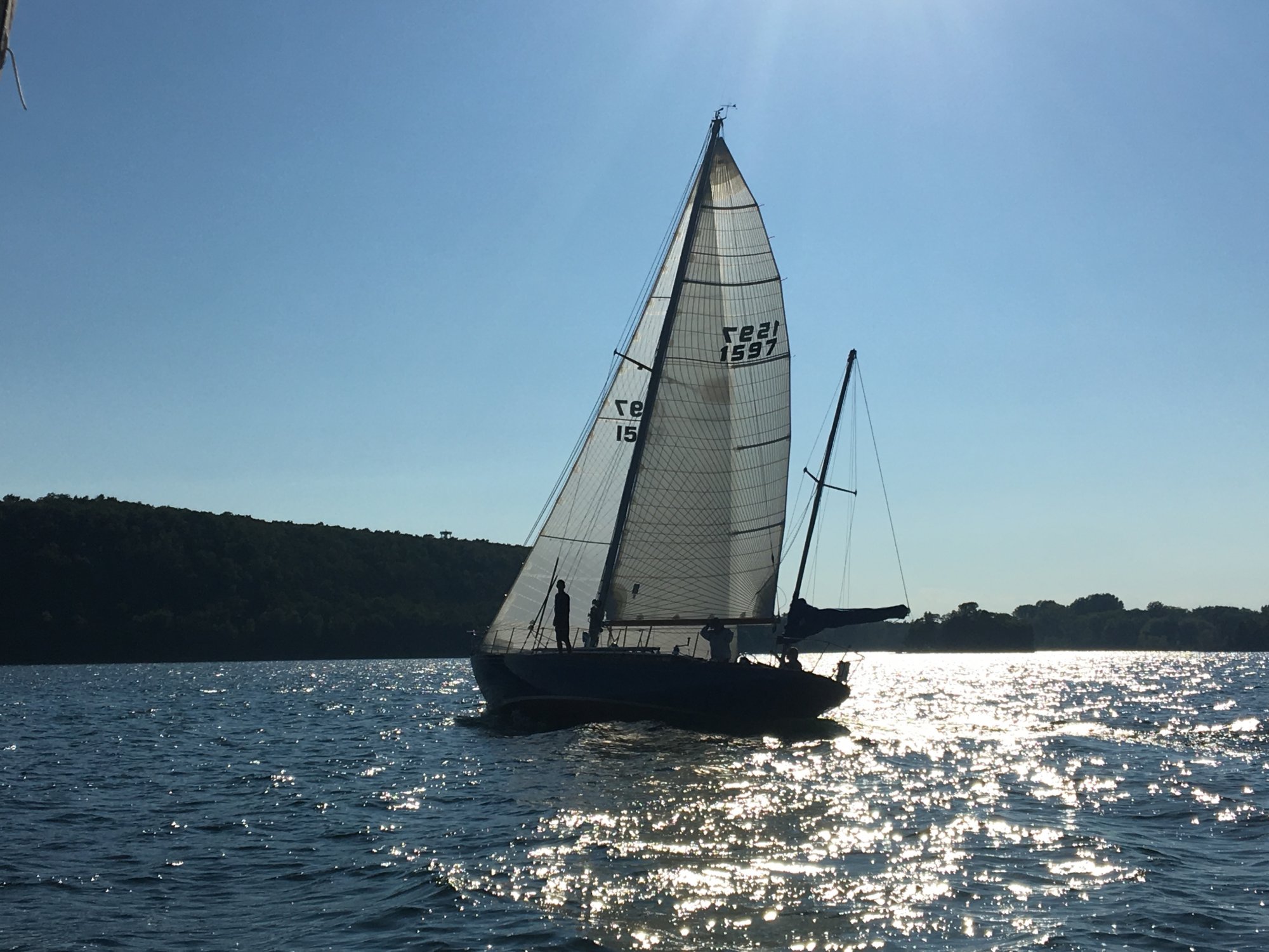

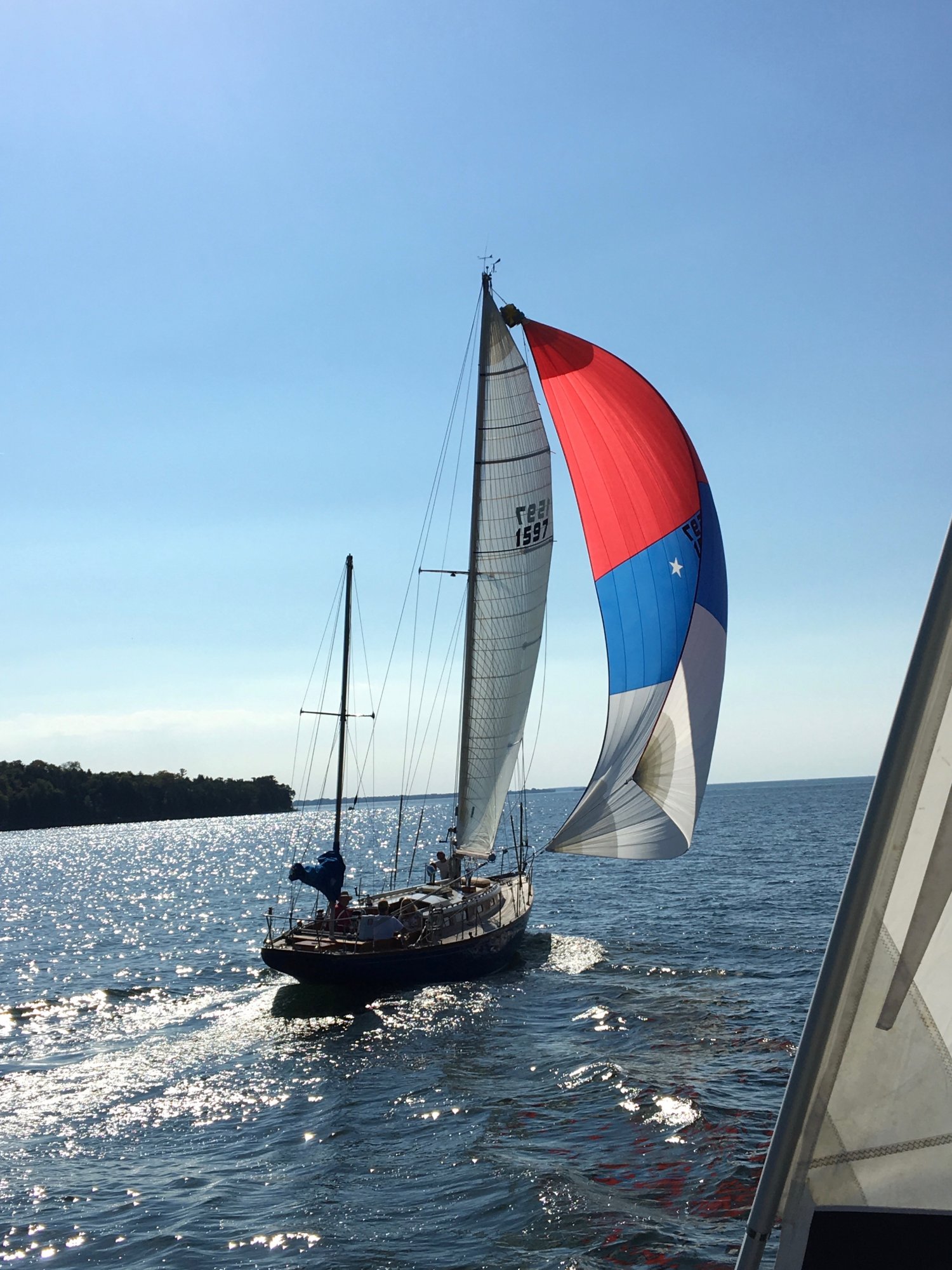

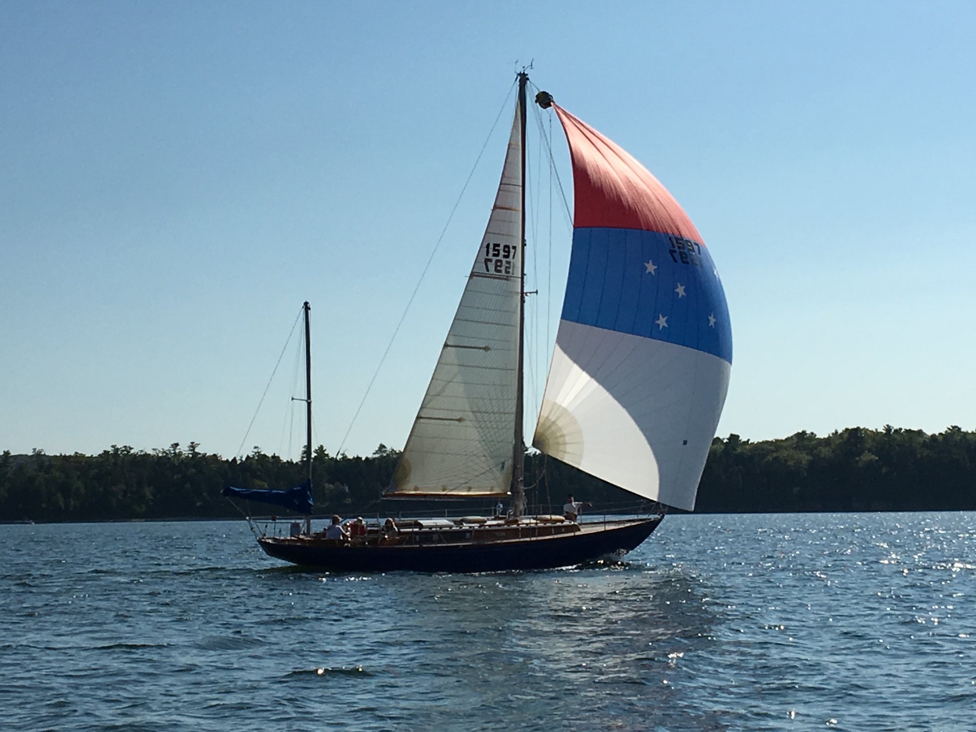

you can see how things are rigged. yes the halyard could be up 2 more feet. the tack could come down too. that said. the guy on the bow is a highly skilled foredeck crew that gets to try different sets any time he wants to see what might happen. you can see the sock halyards a well. these a sails are very easy to fly.
the last photo is of course the beating we sailed to get back home that day.
what goes down wind has to drive up wind to get home for dinner :)
