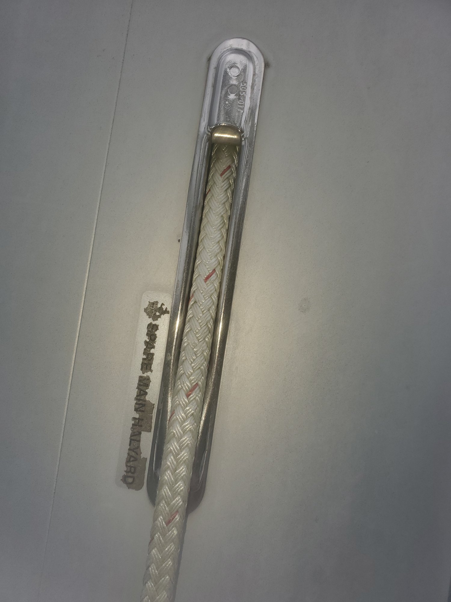

I have an opening about 5 ft up my mast that is labeled spinnaker. There is a small pull line sticking out of it but I cannot find the other end if it. What would I need to do, from those who have done it, to get my mast ready to fly a spinnaker .
It's a 2002 380 with in mast furling.
24,589
Have you climbed to the top of the mast? Check if the "pull line" is up there?
The diameter of the line in your image looks a bit large to be just a messenger line.
The wording gives the impression that the line is the halyard for a spinnaker. Someone may have pulled the halyard, and the sail end of the halyard is at the top of the mast. I say that as a SWAG.
How much line, in your image, is there on the deck at the bottom of the mast? If it is about 60ft of line, then my guess may be accurate. :biggrin:

Sorry...that picture is the spare main halyard. Yes it is a small messenger line, and no I have no plans to go up the mast.
