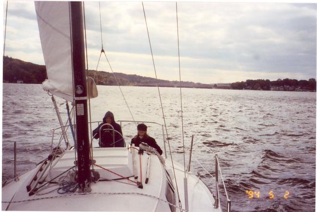

Our spin pole attaches to two becket like fixtures attached on the starboard foredeck (also 27' boat, see pic at link below). The poles ends lock in place keeping the it secure. It eats up some valuable walking space but is by no means impassable. If you do a lot of racing I would consider the on-mast storage that has been suggested. Of course, my pole is from 1967 and is fairly overbuilt so I would be nervous keeping it attached and vertical all the time. I am sure there are safe ways of doing this though. If you mostly cruise and use the spin now and then you might prefer keeping it safely in the horizontal. Good luck.
