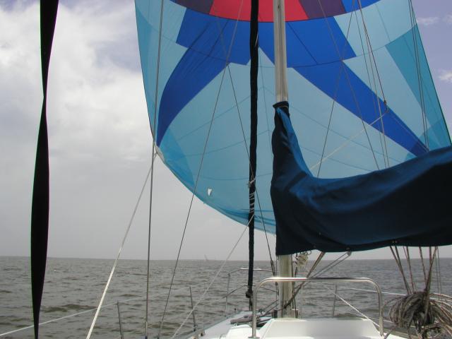

lr172.. I read an article several years ago about using the genny track blocks. The article said there was much better control of the spin that way, especially for single handing. I tried it and noted much less oscillation and easier trimming.. probably not for racing, but is very good for learning how to handle the beastie in a more stable environment.. Attached picture shows the sheet going down to the double wide track block.. I don't use the cheek blocks for the spin lines.. they go straight to the winch.
