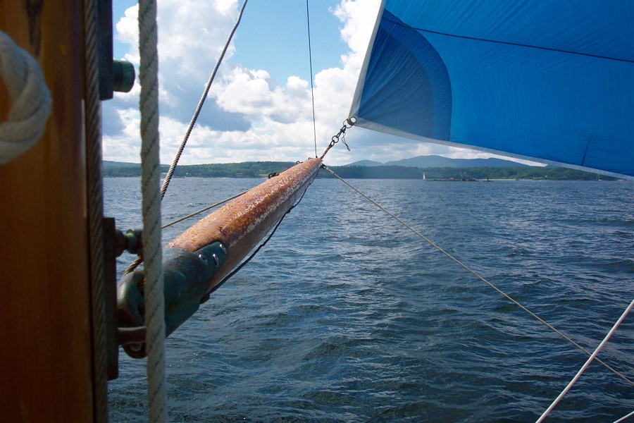

Jon, here's some details on the spinnaker pole. It has a good taper not evident in this photo. The pole is 3 1/2" thick at the center and carries that out quite fully before it tapers at the ends to 2". The end fittings fit over the spruce and have two straps with several screw holes(you can see in the photo). I don't know where you could find these but you'd need something similar for wood. As the pole is in behind my mizzen, booms, etc etc. I couldn't get the length but that would be the J.
It needs all that 3 1/2" through most of it, I've had some pretty good bends in it.

Interesting Iain. Square. Of course it's the compression load that gets a spinnaker pole. And this one I have with a bridle for both the pole lift and downhaul, keeps flexing forces to a minimum, at least well off the wind. But I've seen it with quite a bit of bend a couple of times, usually when it was way past time to be flying a spinnaker. But that does happen with spinnakers, they are the most fun you can have sailing in my mind.
It may be a benefit to wood, the flexing. In past boats, the aluminum pole didn't show much bend in heavy air. The elasticity of wood, may give it some warning.
I've tried to locate some of these ends for Jon and the only faint lead so far was in the UK, from an old unused pole. They sound too small at first glance though. Maybe some will surface.
