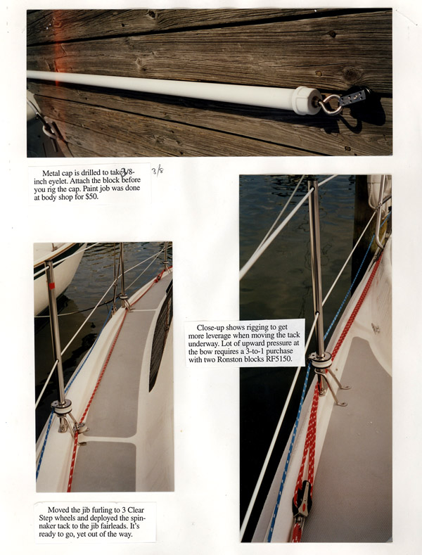

This info is correct and the only difference being the way the sail moves when coming about. The sail actually totally comes about in front of the forstay, not across the bow beneath the forstay. You use 3 sheets. A port and starboard and then a center sheet to let it fly up in front of you. The center sheet uses a block attached to the front of your boat, generally off the pulpit rail or what ever your boat is fitted with. The port and starboard sheets need to be long enough for the spinnaker sail to come about in front of the forstay and generally rest when they are not in use. I found this link to be a good explanation when trying to figure it out.If it's any help, think of the sail as a big genoa, for downwind, and don't think traditional kite. The asym is easy to fly and a gas when you're passing everybody in sight!
First you have to determine if you have an asymmetrical or symmetrical spinnaker. The asym does not use a pole, but the latter does. If you have a regular symmetrical spinnaker (they come in different cuts: radial head, tri-radial or starcut for example) then you need a pole which IS NOT adjustable. If you ever want to race, the spinnaker pole should be the exact length of your J area (which is from the stemhead fitting to your mast). If it is too short, then you are doing yourself injustice and if too long, then you are looking to get penalized by the race committee or competitor. The symmetrical spinnaker designed for your boat would require a pole the same measurement as your J dimension (and not "a little shorter" as some one suggested).
