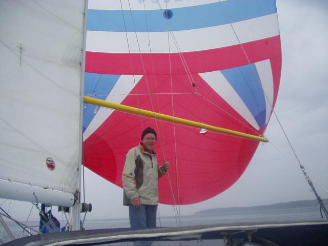

I made a spinnaker pole from cedar, by gluing 2- 10' 2x4's together to make a 3" dia. pole, tapered to 1 1/2" dia at the ends. I bought the bronze ends that slip over the tapered ends of the pole, and then are attached with screws. Seems plenty strong and lighter than you might think. Bronze rings can be lashed on for topping and down haul lines. Total cost, about $75.00 and a little time.
