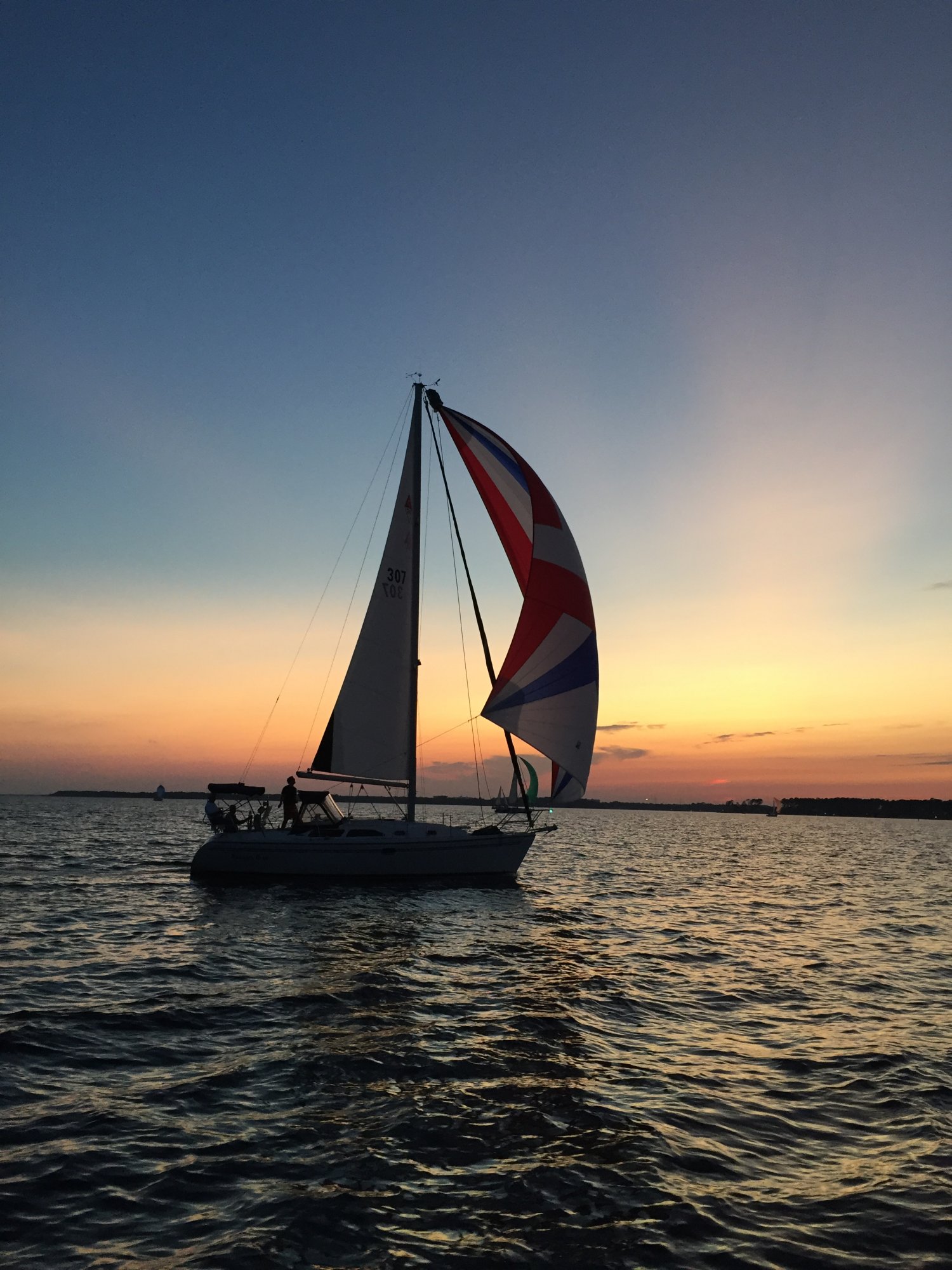

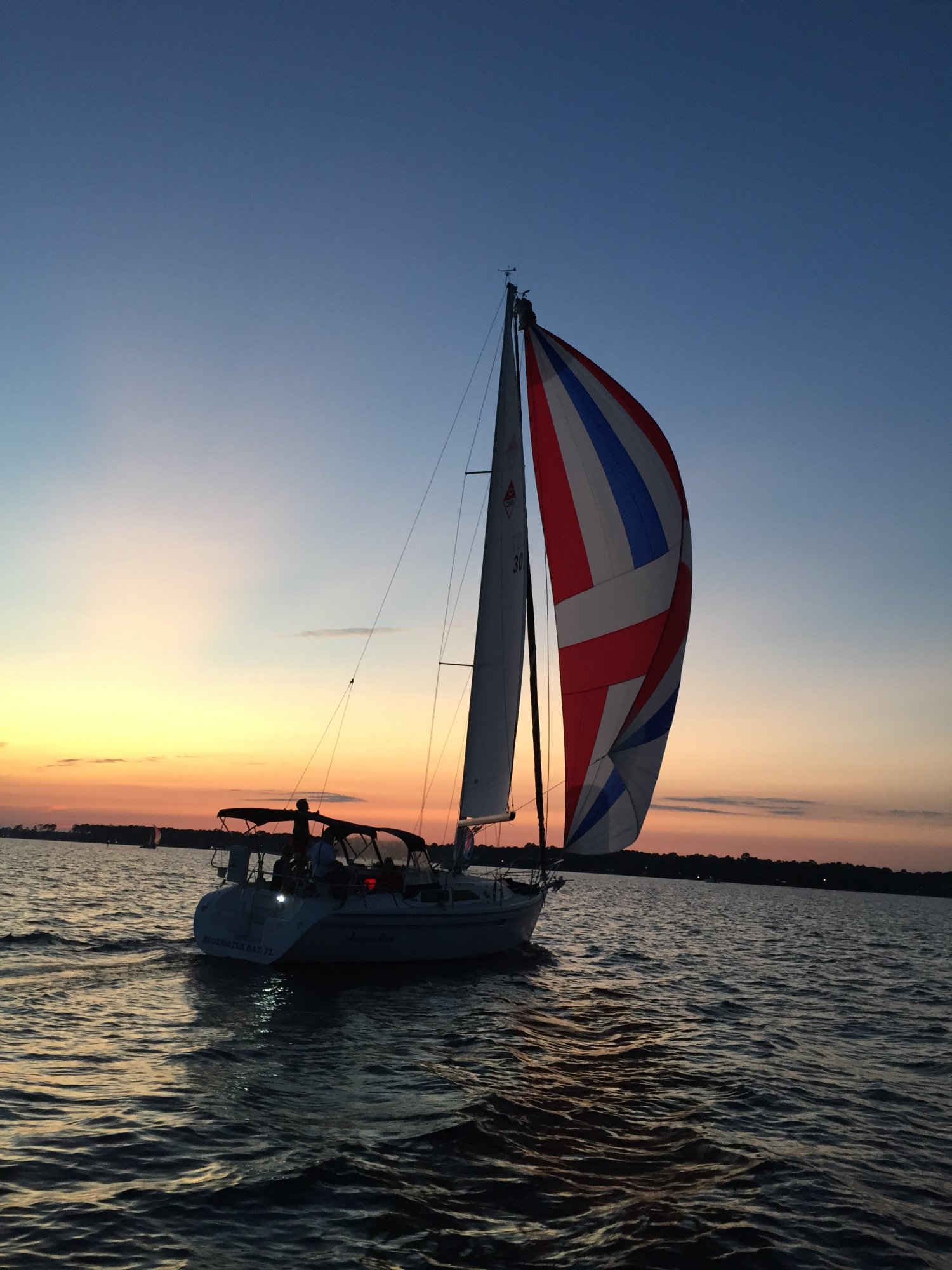

I use a symmetrical tacked to the anchor bail. Depending on wind, I can carry it from 70 apparent to 145 apparent. After that I go wing and wing, polling it out with my 18 ft whisker pole. 063AB92F-0AAE-42C7-8BD1-4F6F41E73297.jpegFA5B11D0-8B09-47E9-85C2-C60E73005BB4.jpeg
