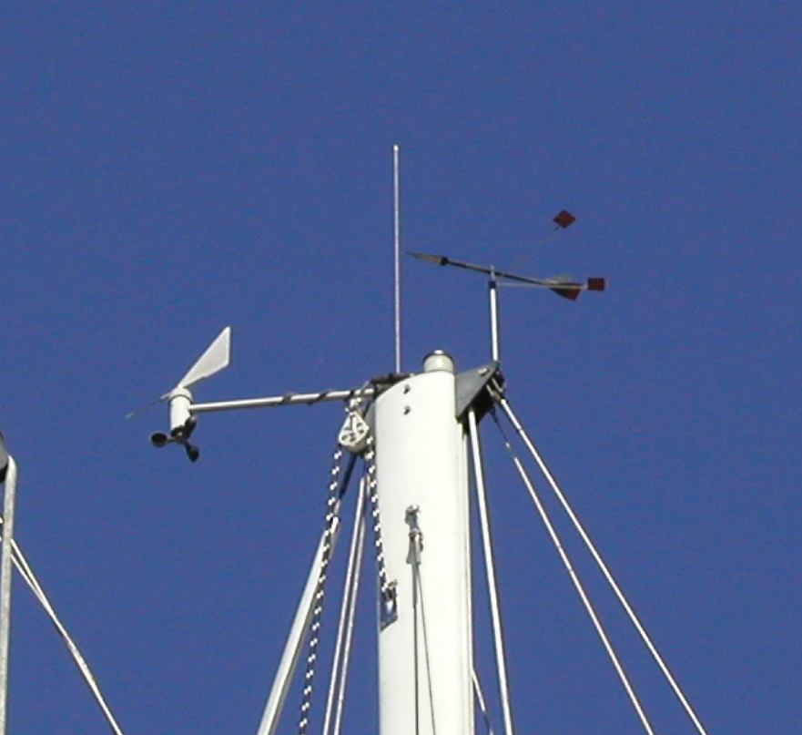

I just have to say that some riggers just term a second jib halyard as the "spinnaker" halyard. The critical characteristic of a spinnaker halyard is that it flys from a crane projecting it in front of the forestay. This allows for the un-impeded jibing of a symmetric spinnaker, and of a asymmetric spinnaker flying off a sprit. These sails must jibe in front of the forestay, ie ahead/outside of the foretriangle.
If you are flying a cruising chute from the stemhead, and jibe it inside the foretriangle, then such a halyard (located next to the jib halyard) works fine.
Likes: Jeff2650
10,244
here is what the spin halyard on a crane looks like:
You can see the spin block is forward of the halyards and forestay. Some fractiionally rigged boats have the spin halyard on one of the masthead sheaves, but that is kinda rare.
Likes: Jeff2650
That's an excellent visual showing what a crane looks like, thank you.
