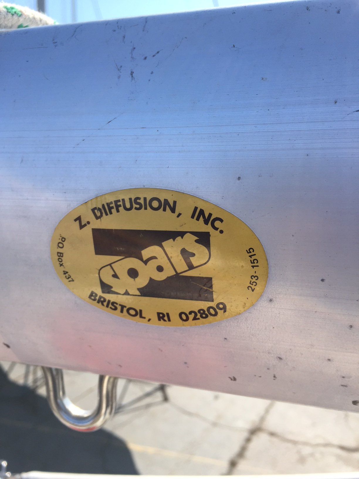

The attached photo is of my 1988 O'Day 322 masthead. My mast says Z-Spars.

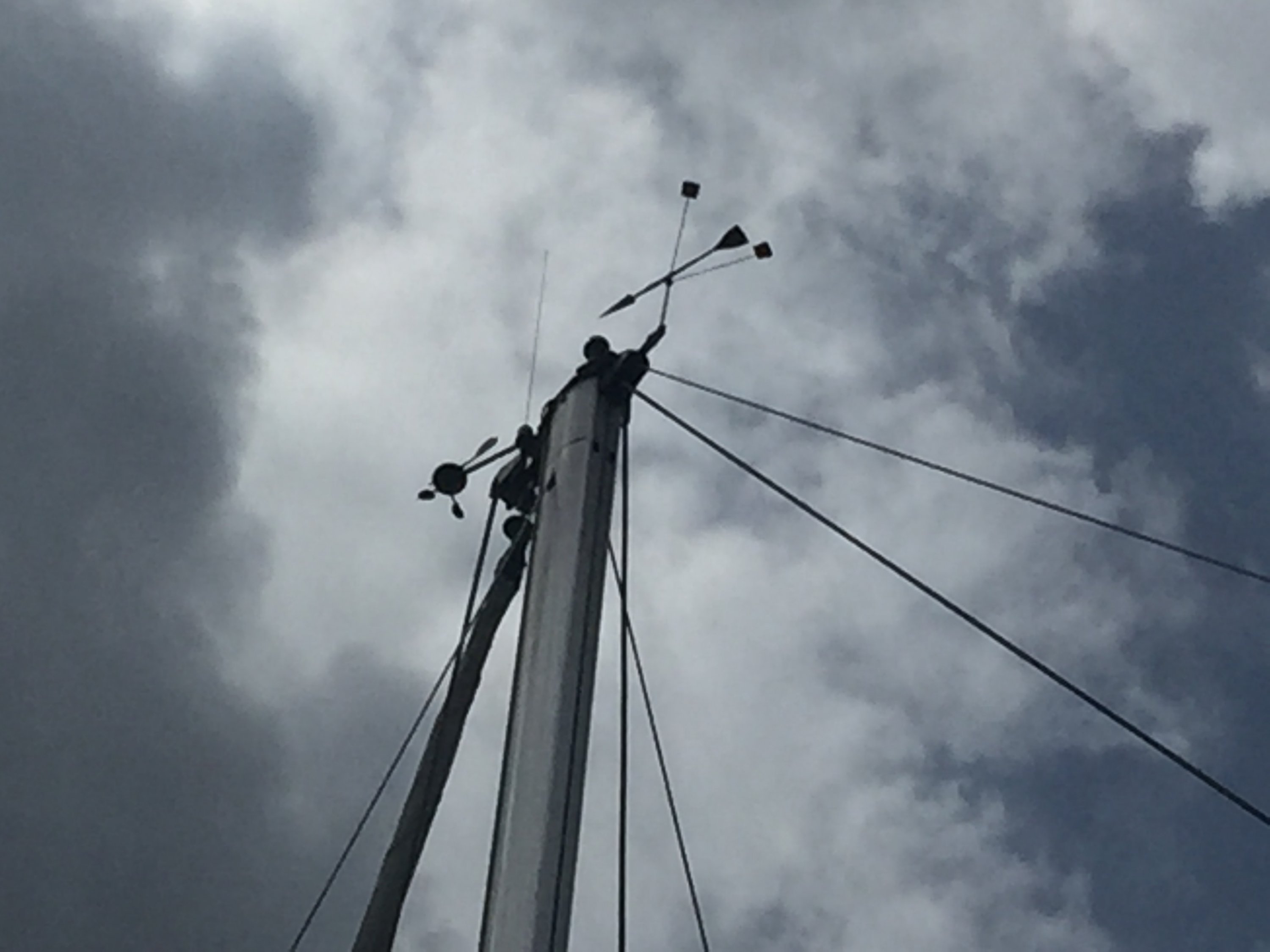

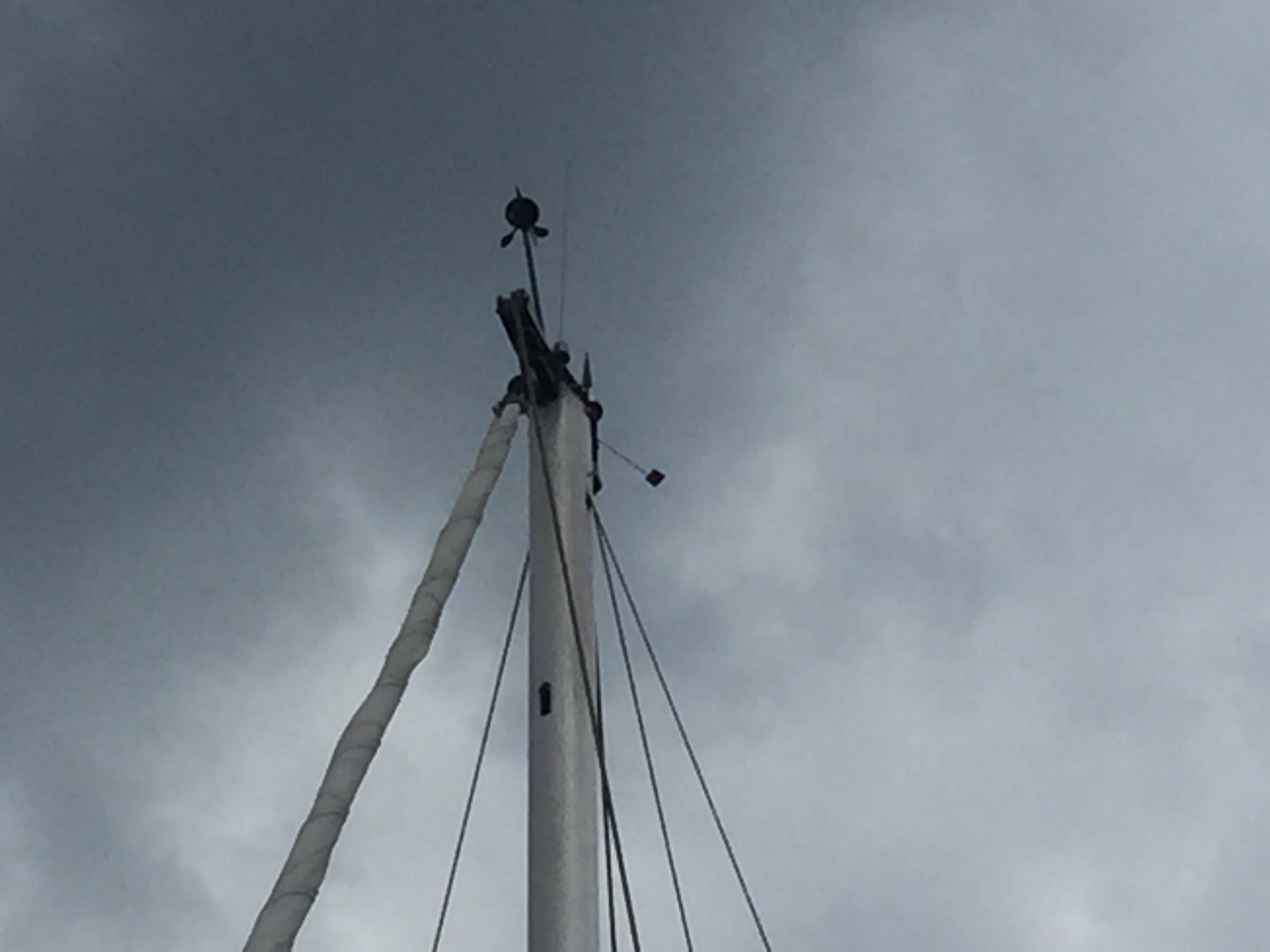

Not the best photo (will take the telephoto camera tomorrow), but this may give an idea as to how my mast head is set up and where the roller is...
Greg

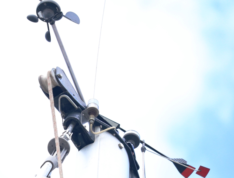

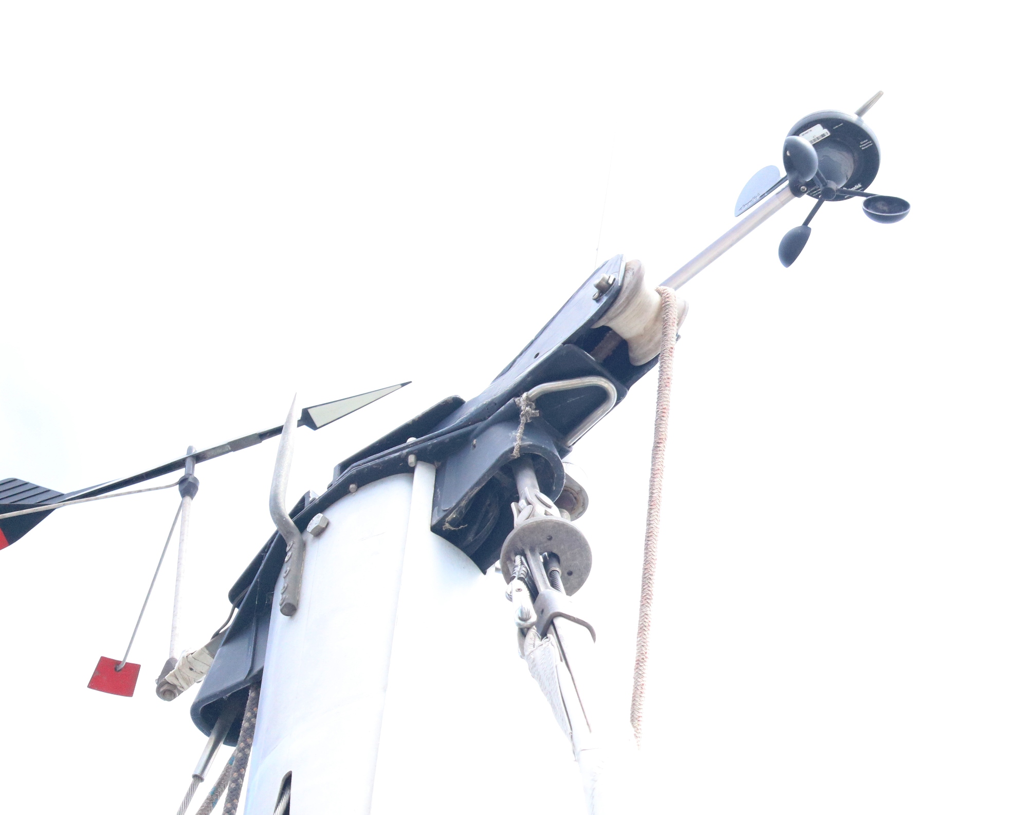

Here are some better shots of the front of my masthead. You can see the roller, and a bail, that I never knew was tucked under there!

Now if you take off that roller assembly on the top (which looks all the world to me like an anchor bow roller) then your masthead looks exactly like mine. That looks like a prior owner addition.
I would presume someone welded a top plate on the anchor roller to keep the spin halyard captive, but even so it still looks like it would experience chafe with a full load to the side when the spin is on a reach. Perhaps the prior owner did not know what the spin bail was for or how to rig it with a block, or preferred the merit of this bow roller solution which seems to be the bitter end of the spin halyard goes down inside the mast, where as with the traditional solution the spin halyard bitter end comes down the outside of the mast. Sometimes the bitter end of the spin halyard enters the mast through a slot down a foot or two from the top of the mast, but I do not see that on an O'Day 322 mast.

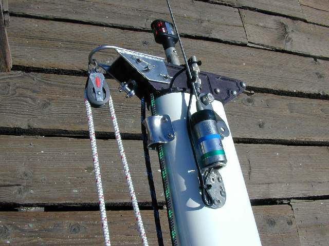

An example of a more traditional solution rig is attached.
