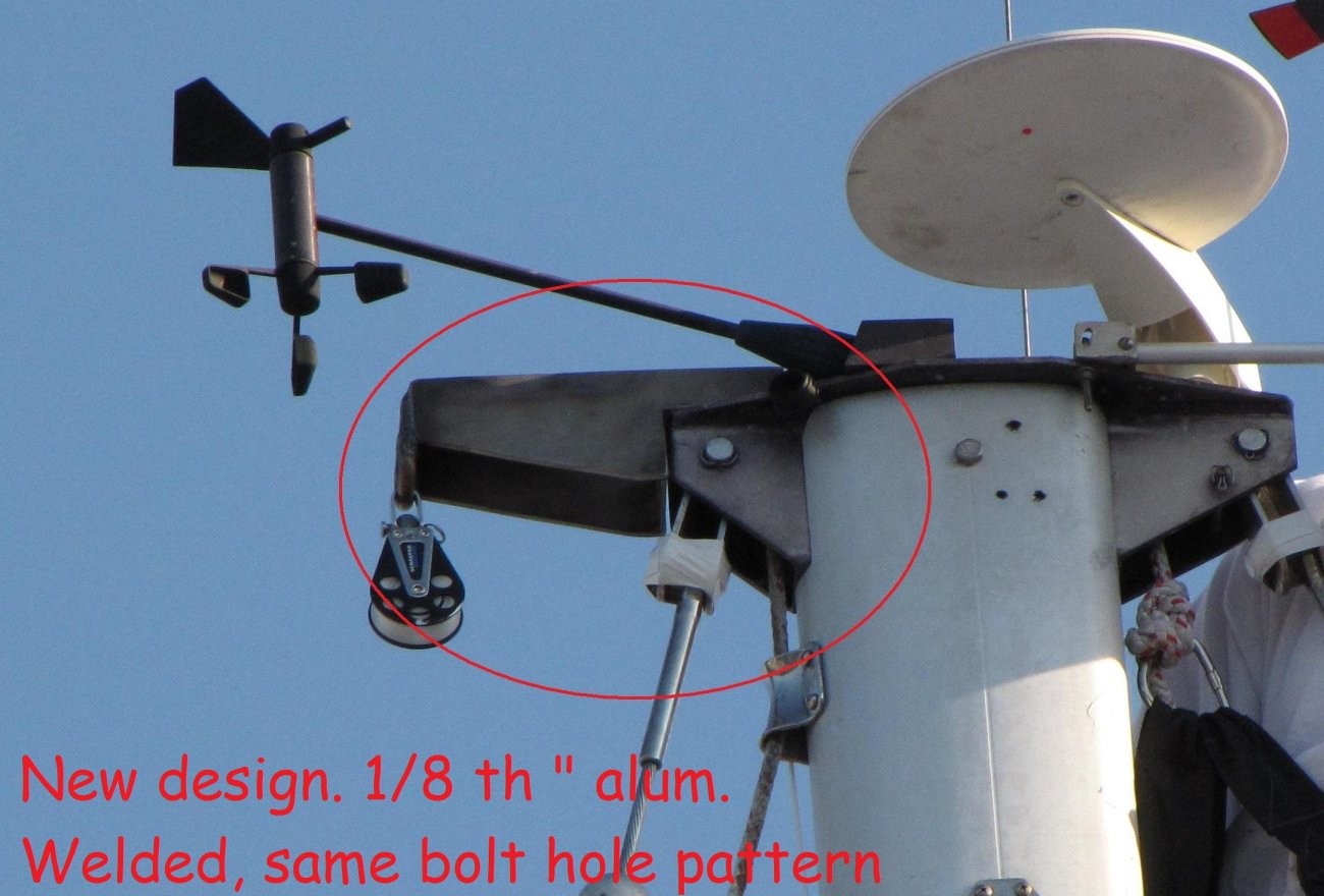

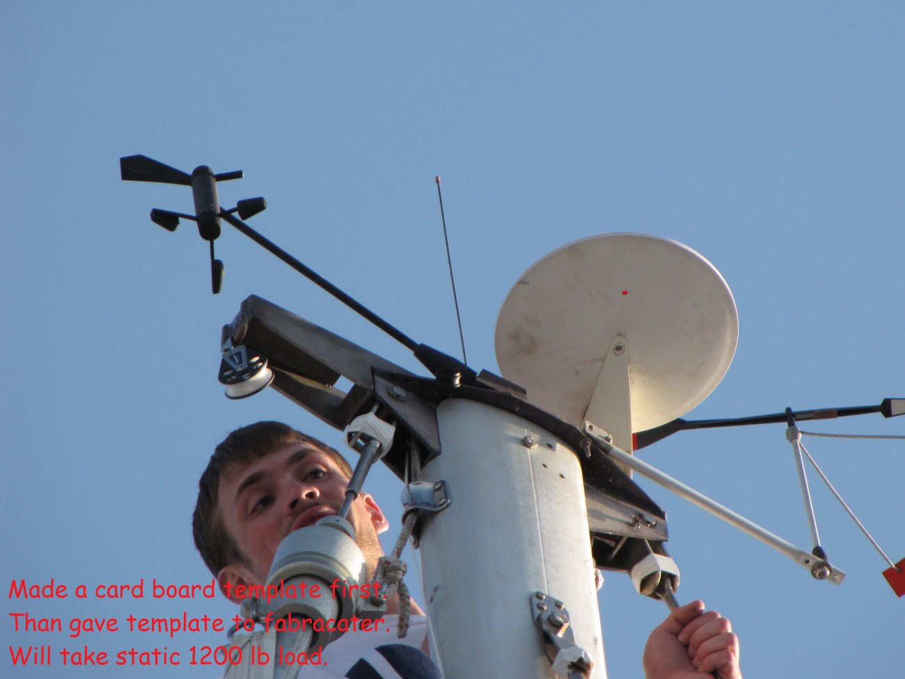

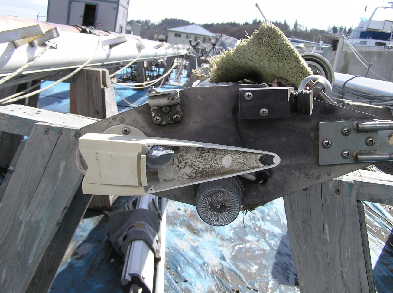

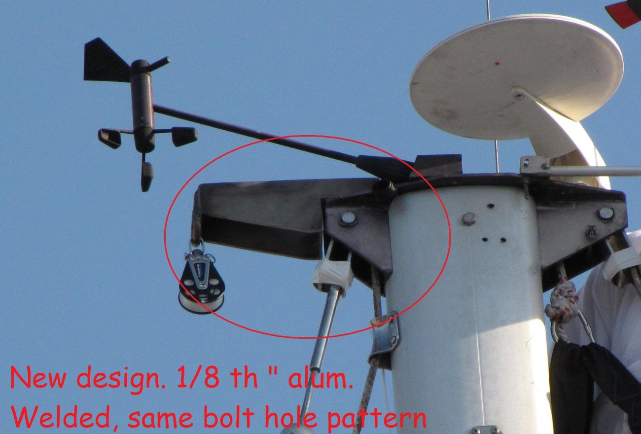

I am attempting to design a spinnaker bail extension for my CAT 310. I need the mast head weldment dimensions, particularly the forestay 5/8" pin location in reference to the four 1/4" bolts that secure the bail to top of weldment . Anyone have a copy of the weldment drawing?
