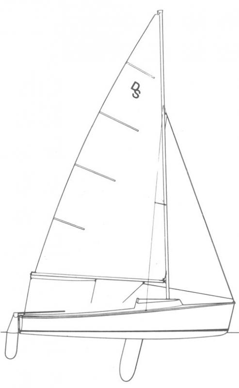

Length: 16'9"
Beam: 6'3"
Draft: 7" CB up / 3'9" CB down
Weight: 575#
