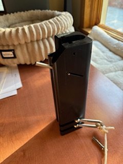

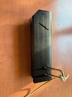

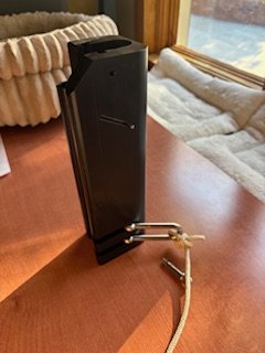

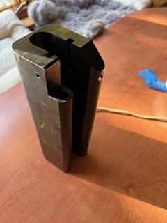

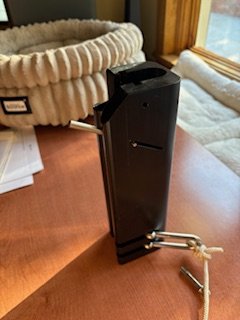

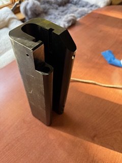

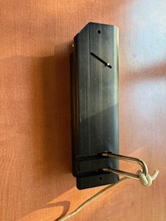

I purchased a Hunter Legend 35 that had a Spin-Tech Triumph 2000 roller furler already installed. We have had trouble from the start in both lowering and raising the sail to and from the catch hook at the top. It comes with a urethane car you run up the leading edge of the foil with a halyard and a chase line to hook or unhook. I have tried the jib halyard, main halyard and even installed a new spinnaker halyard and tried it. I have had to go up the mast whenever installing or uninstalling the head sail. I am almost at my wits end and ready to buy a more conventional furler. has anyone had experience with this system? Is there a trick I can try? I have tried to research and it seems the company no longer exists.
Do you have any pics of the car and/or the sheeves for the halyards? It is hard to suggest a solution when we can't see the problem.:beer:

Thank you, I had seen this. It works great on 6' high foresail, but not so great on a 45' high foresail. I have the accessory (call it a car).

Sorry to hear that. We have the car, but have trouble keeping it on the foil. I am going to give it a try with both the jib halyard and the spinaker halyard and if I cant get it free, I too will have to go up the mast to release it.
