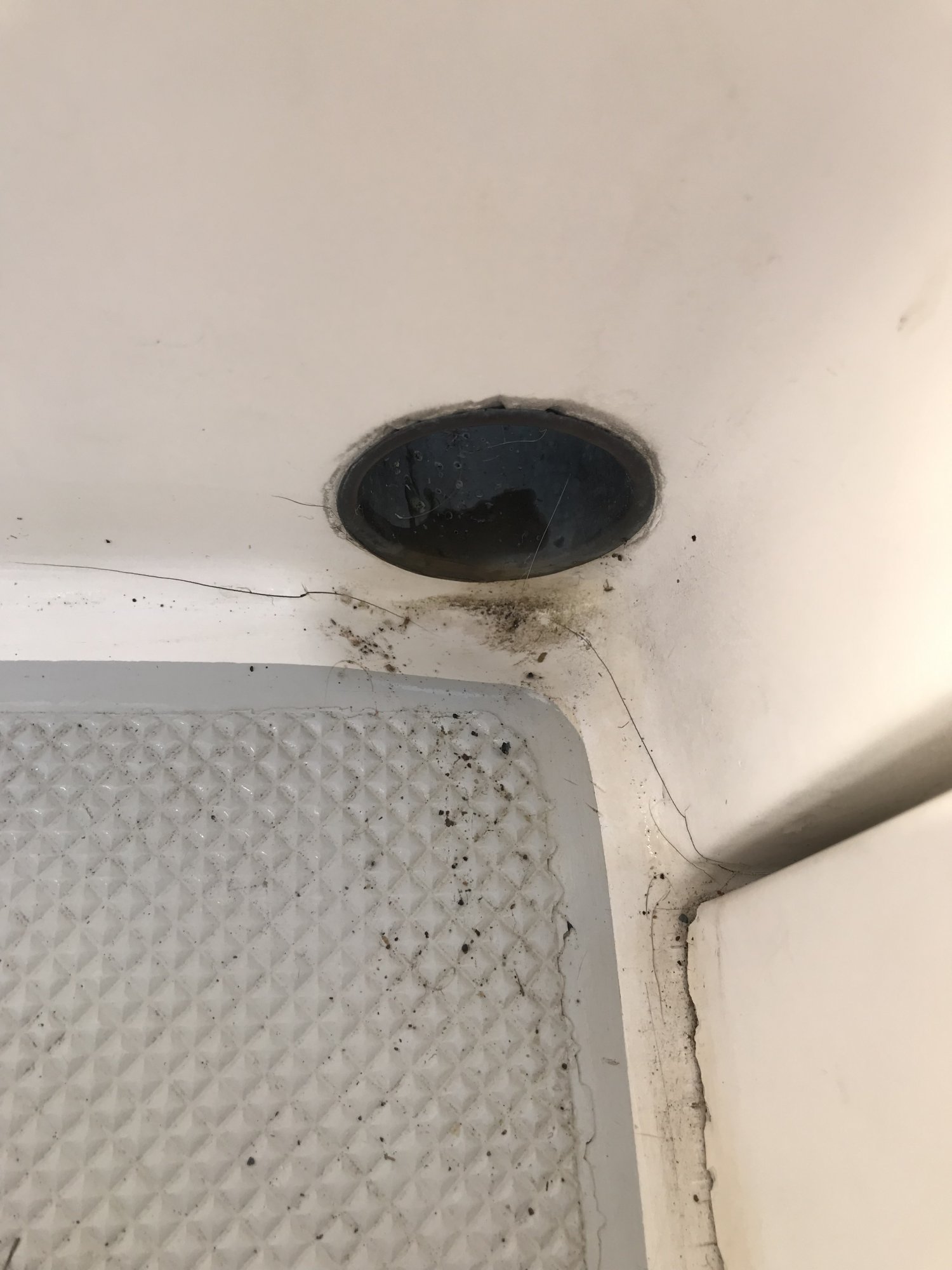

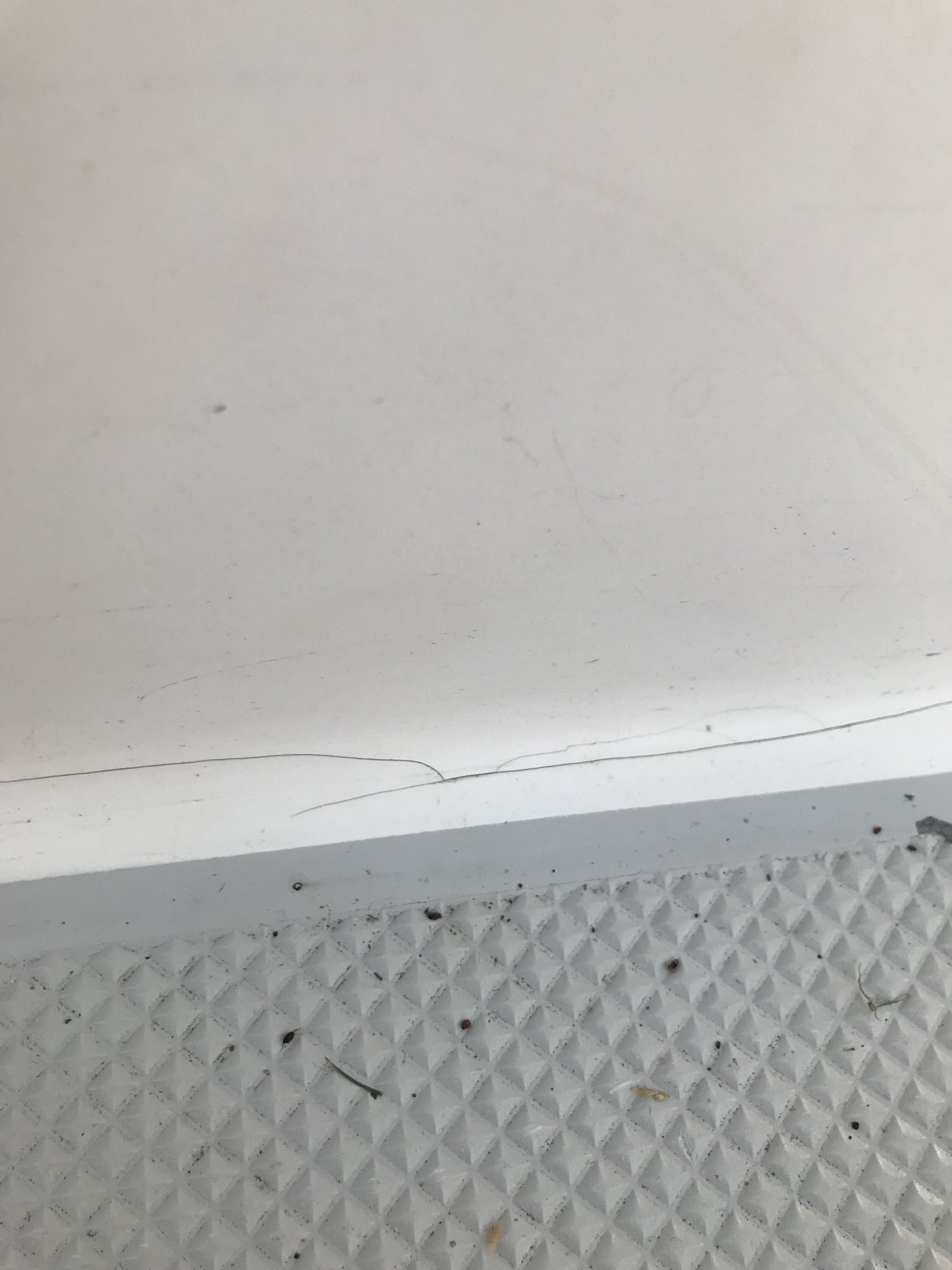

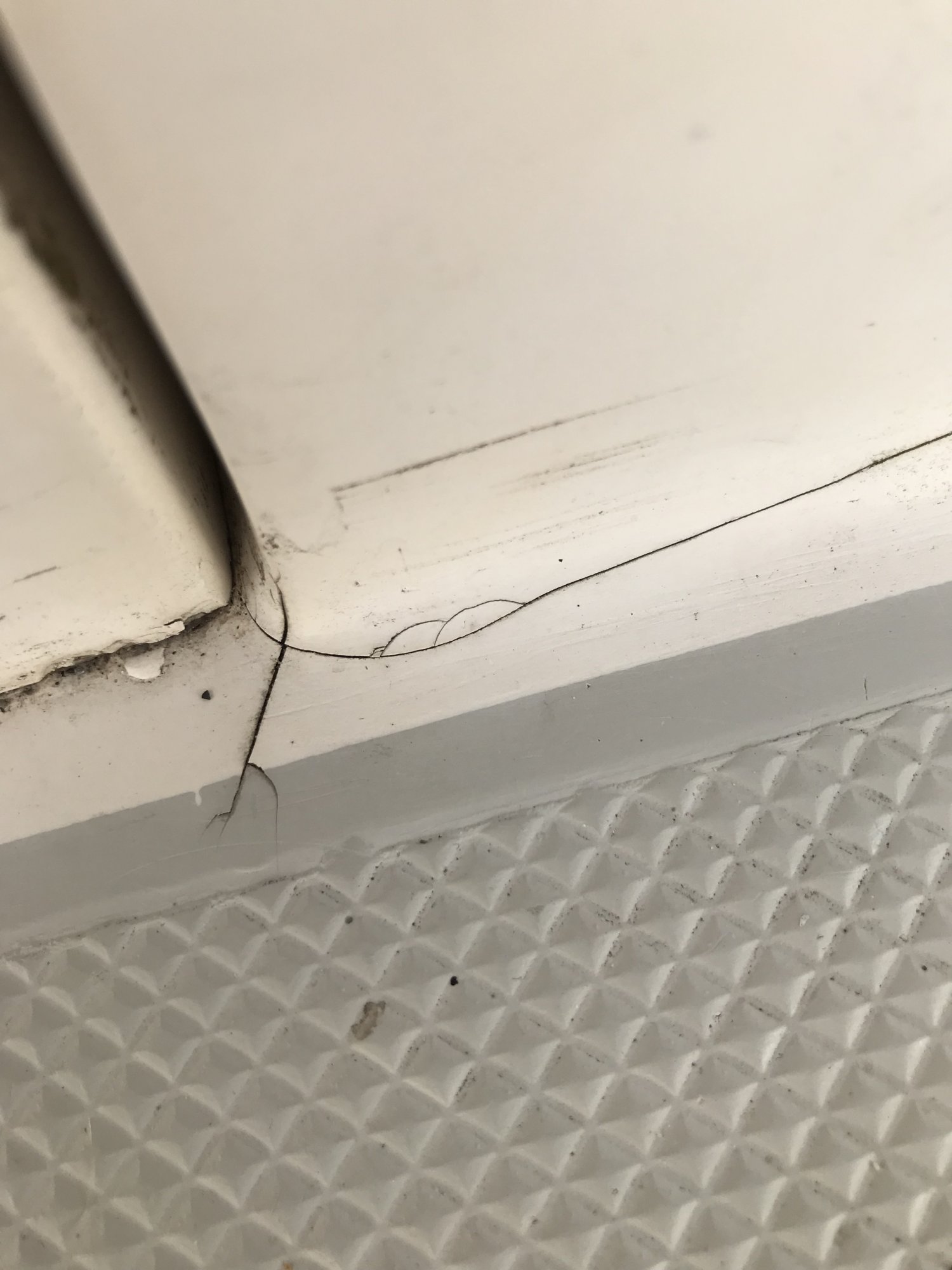

I attached a few pictures. I have a few spider cracks in the cockpit of our Catalina 18. What is the best way to fix them? I want to prevent them from getting deeper, wider, and longer with time. What is the best solution to this problem? Does anyone have time-proven methods?

Those are gelcoat cracks which are cosmetic and not structural. The cure is clean out the crack and widen it slightly, then sand, fill, gelcoat, and sand some more. Look on the BoatWorksToday.com YouTube channel, Andy has done a couple of videos on gelcoat crack repair.
The cracks form due to flexing. They are common on tight radii like the one you show. Fiberglass is fairly flexible and gelcoat is not. Over time the gelcoat cracks. In corners where your cracks are sometimes there is less glass in the corner than in the floor or side, this adds to the flexing.
