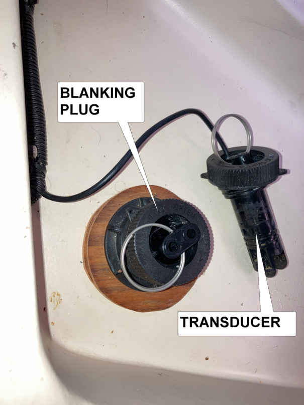

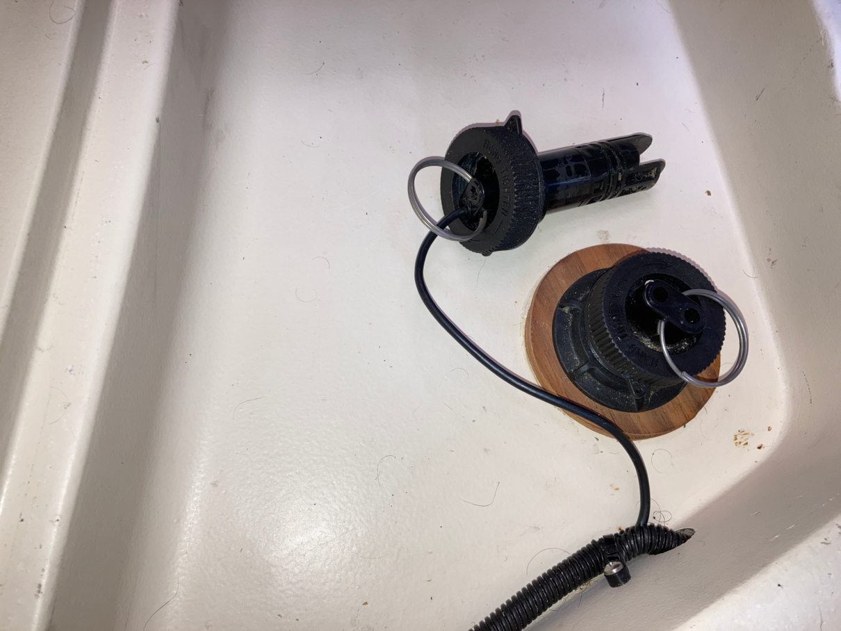

I climbed this learning curve this spring. When I went to prepare the boat for launch, I saw the fins which protect the paddlewheel from the sides had been mooshed by the sling of the travel lift last fall (not the first time that’s happened!). When I used my needle nosed pliers to restore it, I discovered the paddlewheel had broken and pieces fell out. As others have mentioned, a google search got me back in business. Here’s a link:
I honestly had no idea I could access to the paddlewheel (and depth finder transducer) from inside the boat. Better yet, the blank plugs were attached to the instruments with seizing wire so you couldn’t lose them. I ordered a replacement paddlewheel & pin online at Amazon for under $50.

@Ralph Johnson, not only did I not know I had a plug, but also I had no idea I could access those instruments from inside! The boards on the center line in the cabin sole have finger holes aft of the compression post to access the bilge, but the triangular piece forward of the post doesn’t have a finger hole, and I didn’t realize it was removable. When I was trying to figure out where to look in the cabin for access to the instruments, I used my ports as a frame of reference, and that’s when I realized I had to get forward of the post. All of these explorations were when we were on the hard, so if there had been no plugs, I still would have been able to effect a repair, but I was certainly gratified to see they were already there and I wouldn’t have to go shopping. Obviously, I now can also deal with issues when we are afloat, and I’ll easily be able to pull the paddlewheel before we go into the sling this fall… Hey, I’ve only been sailing her since 2017… (She’s also the first ”big boat” we’ve owned, the others being trailerable with none of these fancy gadgets!)

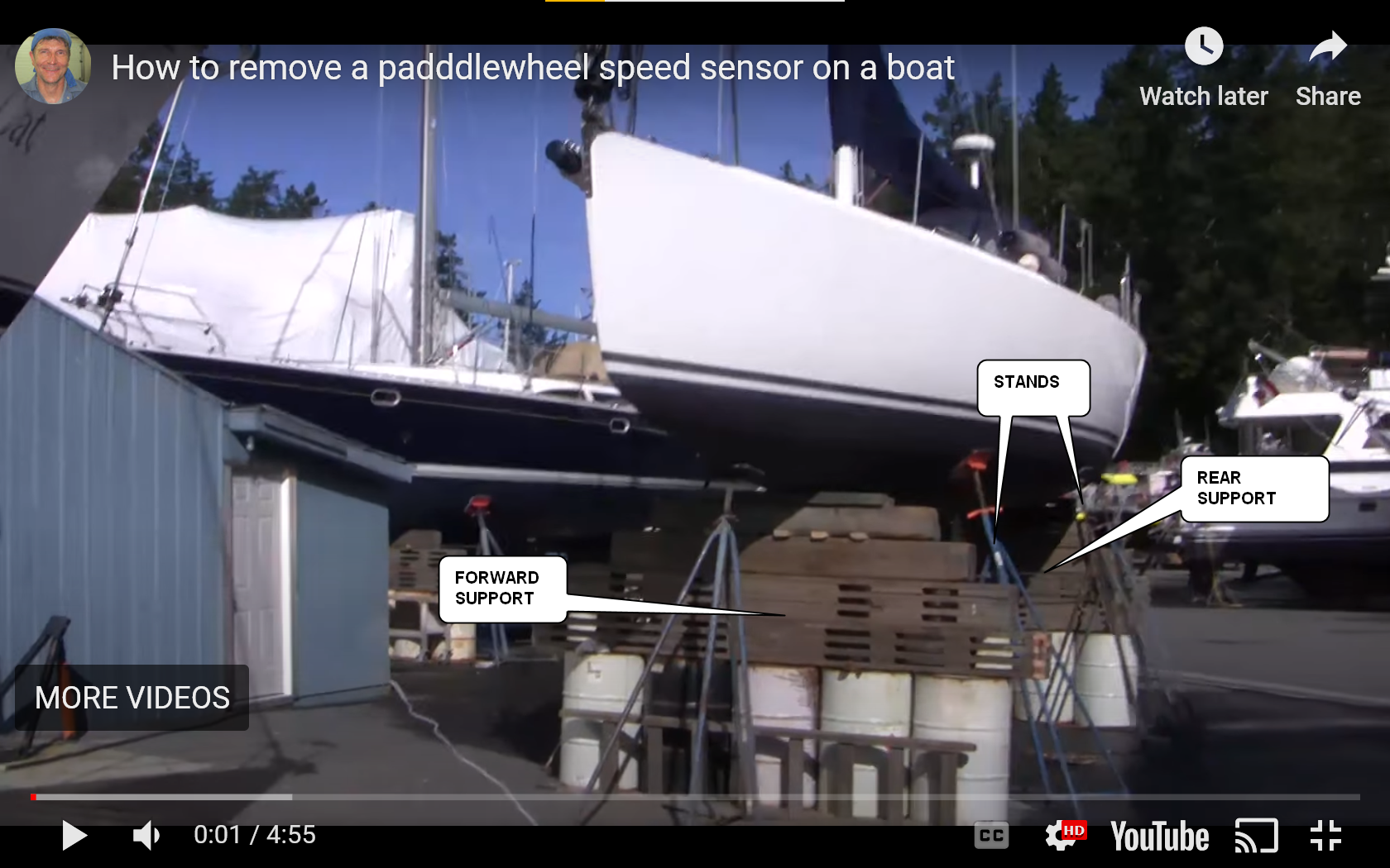

Talking about the learning curve, I don't know if you noticed the beginning of the video showing :
This is the biggest mistake you can make when a boat is out of the water. Sailboats are designed to rest on their keels ONLY with stands placed along the hulls for balance. Each stand will support no more than 10-15 lbs. The hulls will sustain damage if they are subject to excessive forces. You'll notice the same support on the boat on the left hand side of the video :
Looks like the yard missed the lecture on that one.

@RJ, I absolutely didn't see that. It's actually kinda hard to see with the shadows and low quality video. Good catch!
As I looked closer, the whole setup is super sketchy. The cribbing with holes in them? On top of oil drums? Sheesh!
Our yard observes best practice, thankfully.
