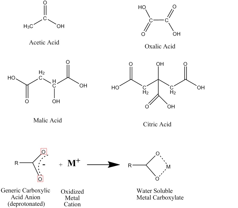

Yep, that should work. Catsup is tomato paste in vinegar... and the tomato itself has citric and malic acids... both of which are similar to acetic and oxalic acid (mentioned above). All carboxylic acids work by making the oxidized metal ions water soluble. See diagram....

As I stated earlier chemical methods for the removal of the green 'verdigris' (complex copper acetate/carbonate/chloride/oxide) is difficult and will/can also begin to 'attack' the base bronze (copper component of the alloy) while removing the 'green'.
Citric acid (undiluted lemon juice) will have the best (using common 'acids') 'solubility' of these complex 'copper acetates/carbonates/chlorides' --- take absorbent cotton 'fluff', soak with lemon juice (or dilute citric acid) + vinegar, apply to the bronze, cover with saran, etc. and let soak -- will 'dissolve' most of the verdigris. If the part is easily removable, simply cover with lemon juice (+vinegar) for several hours.
Sure you can use other acids to remove the 'verdigris'; however, the 'reaction time' can be quite long vs. the 'verdigris' and they will also attack/extract the base copper in the alloy .... The important thing however is: this will only remove the 'verdigris' and not 'polish' the bronze. If you want to 'polish' the bronze ... you will have to actually polish/burnish it by mechanical means.
