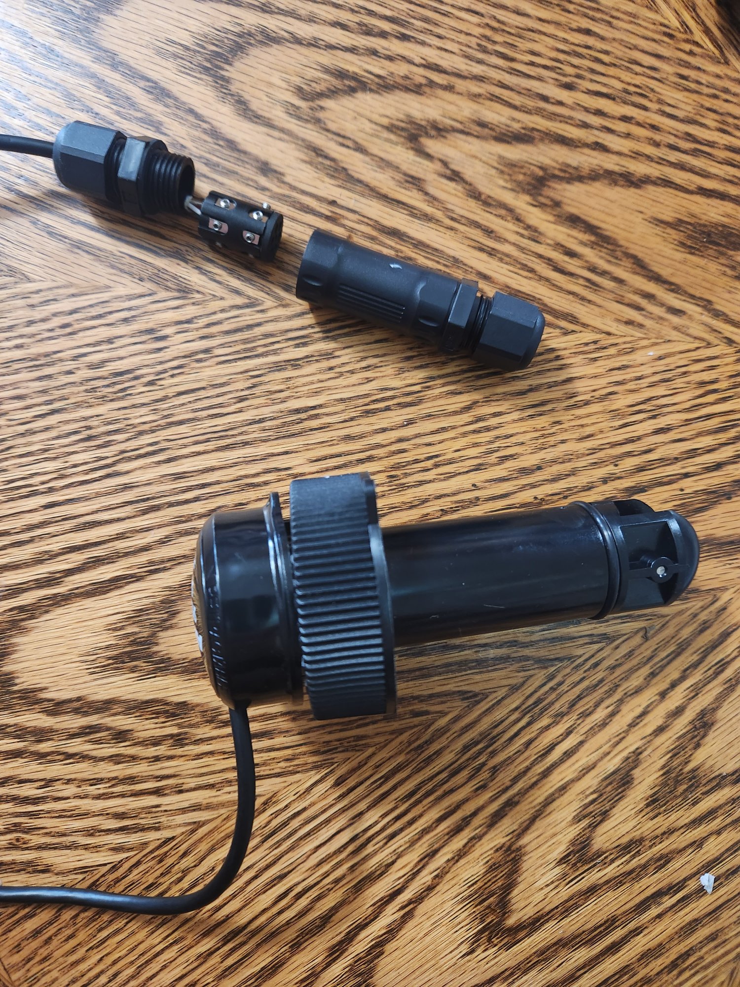

After wasting 3 hours trying pull out the factory installed Raymarine speed/temperature cable, so I could install a new sensor, I gave up. I purchased an approved water proof splice kit instead.

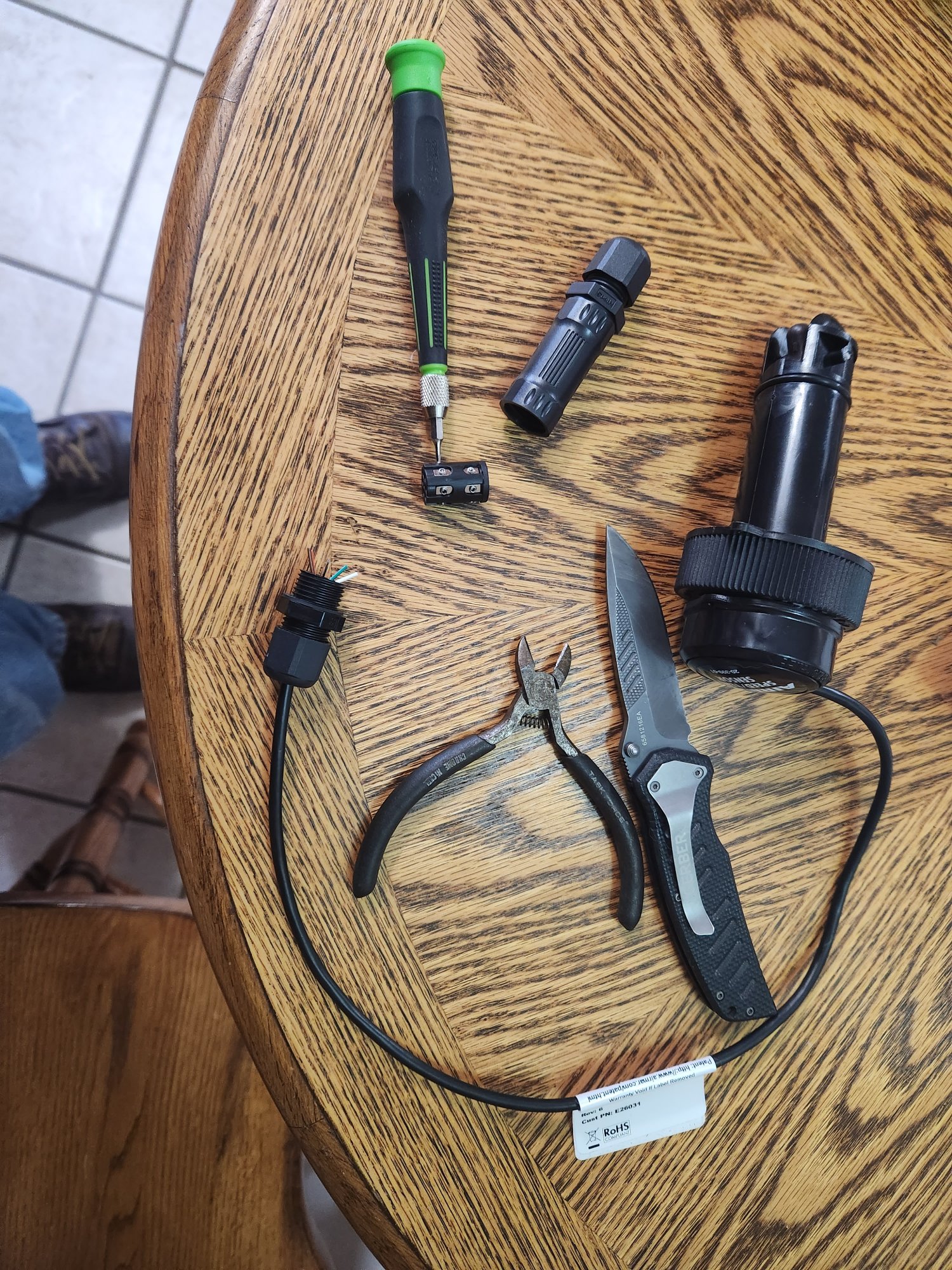

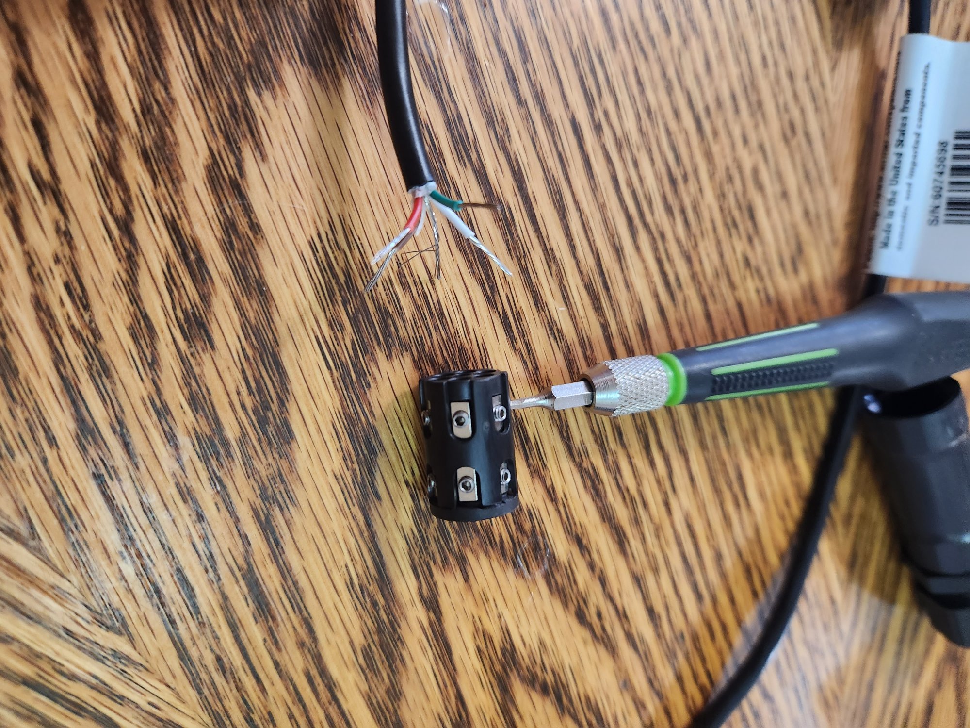

You will need a tiny 1.3mm Allen wrench. I did not have one on the boat, another project delayed.
Here are a few pictures. I should have stripped back almost twice as much of the outer jacket. It's tedious working with such small wires.
