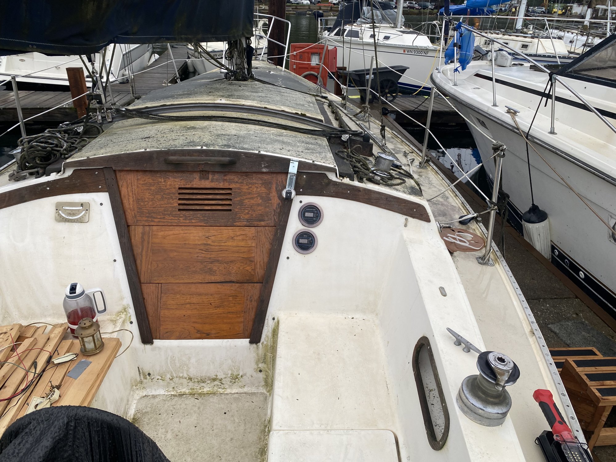

My Catalina 30 is missing the wood trim pieces for the cabin top (some folks call eyebrows). The screws are in place, but apparently a previous owner removed them for maintenance but never returned them. I would like to replace them, but I have no idea as to size. I presume they're made from teak. I have access to woodworking machinery. Thanks!

They are teak and the best I can do is provide a pic of what they should look like. You may be able to make a pattern from this. I have not seen any available new.

They are are hard to source because of their length, look locally. I removed mine on my Catalina 30 and current boat (which your PO did too apparently), I think they look better without them and there's no maintenance. Alternatively, you could use a synthetic teak, PlasTeak is an excellent source: Home - PlasTEAK Inc.

Catalinadirect.com has them for your boat, but they cost over $400 US. As many have suggested remove and fill holes, in 1 year you will have forgotten they were ever there.

Thanks for all of the responses. I'm leaning toward filling in the holes and not replacing them. I like the idea of less to maintain.
